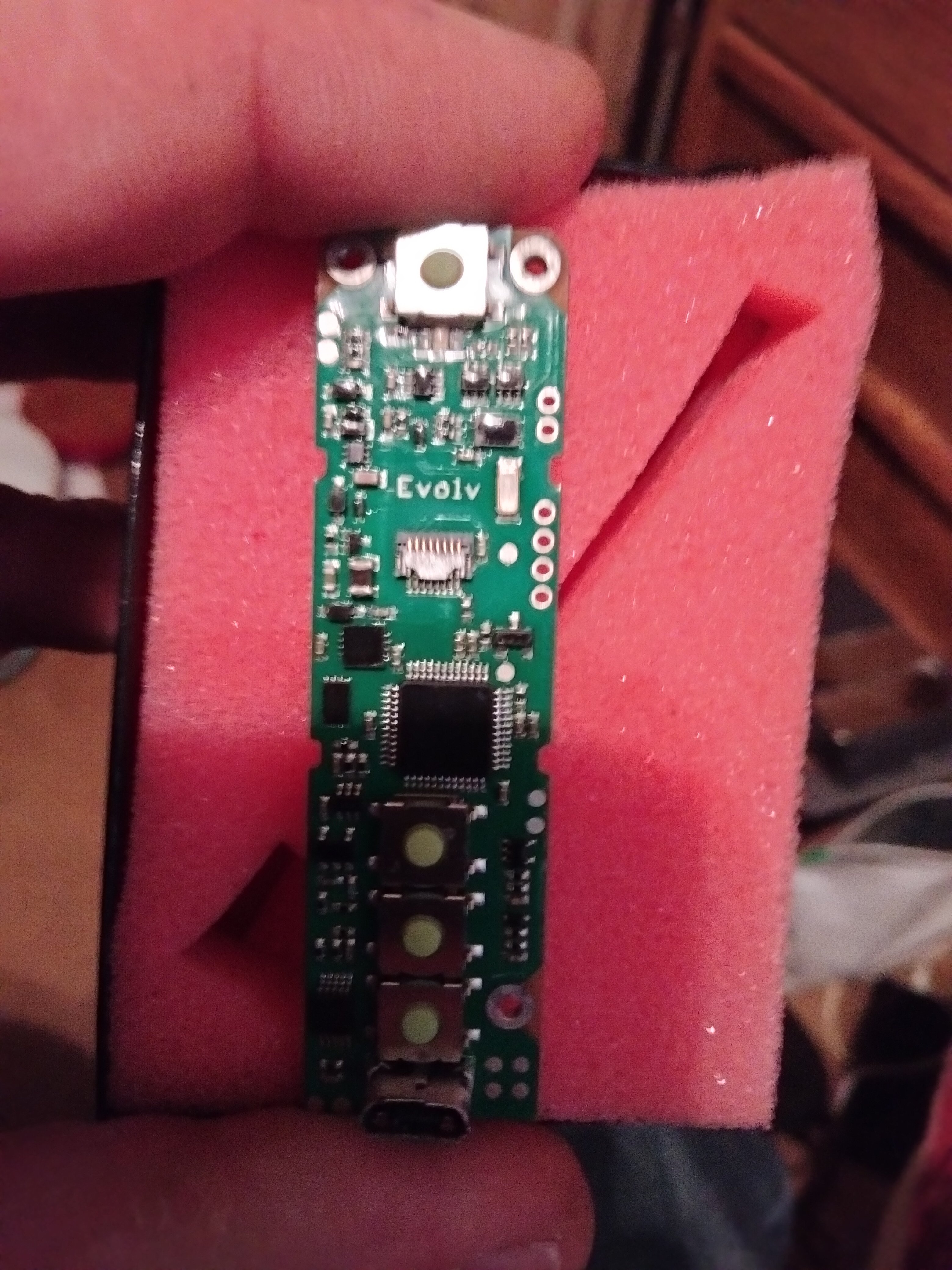

  7. Like I said I just put a brand new board in my mod today just because I had an extra one if we can figure out how to work it out I can send you the one I took out still works it just about two years old so I replaced it let me know what you think I'll send you a picture of it
  8. Are you sure it's broke I pulled out an extra board I have and it looks the same that part pulls up to let the ribbon in or out . My brand new board looks just like that when putting the ribbon in make sure it's in all the way or that part that lifts up won't stay clipped but that part is supposed to lift if you look at the ribbon it has a notch on each side that is how it's locked in place once you push that little hinged piece back down .If you want I have an extra 75 c board I could probably sell you but I don't know how we would work that out. If you look at the part you could desolder it and solder the ribbon directly to the board just use low temp solder paste and it should work fine or solder the ribbon directly to the pins I would try that first.
