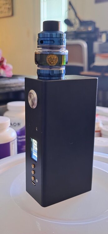

Enclosure: ABM DNAC NX DNA 250 Chipset My first attempt at building, and this thing is HUGE! 2200MAH Turnigy Nanotech 4S 25-50C It's a handful, but I'm slowly getting used to it. 400W of power that I'll most likely never use, but it's there if I need it. Pay no mind to the temporary rubber strips between the battery and chip, those are in there until I can put the velcro strips in to hold and secure that monster of a battery.

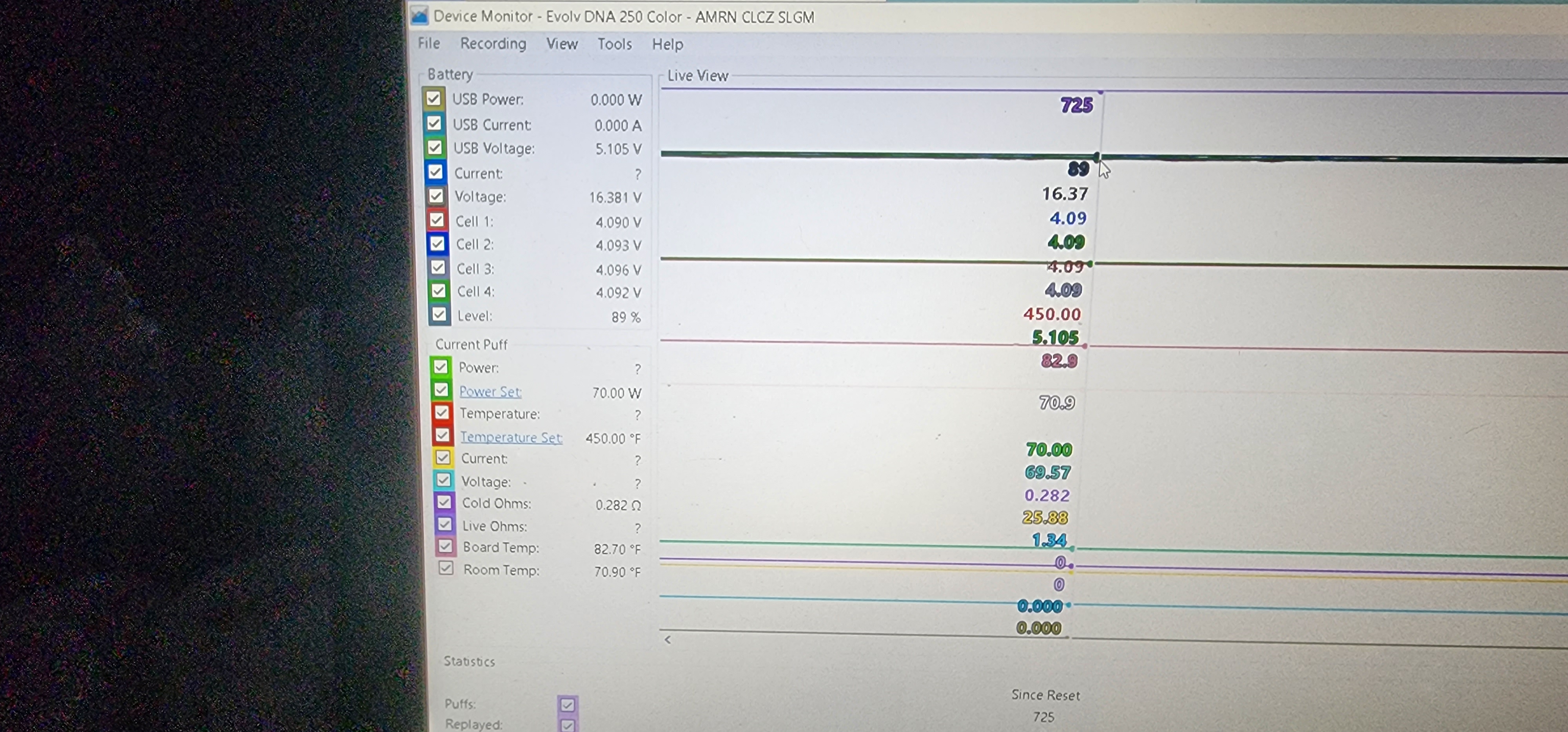

Just built this mod, brand new Turnigy 4S lipo, initially charged to 100% but after charging again, onboard USB charger cuts off at 90%. All cells balanced at 4.0V, total voltage is at 16.3V. I can't figure it out.
