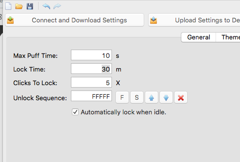

  6. select "automatically lock when idle"

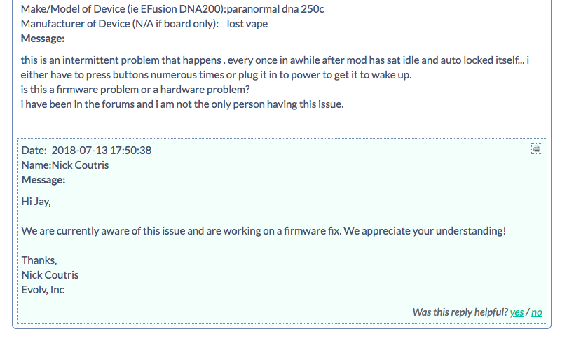

  8. JUST recieved this email from evolv. I guess we will have to wait and see what happens.

  10. just bought a paranormal on the 2nd of june and every once in awhile i have to press the fire button about 50 times to get it to wake up. Its never been dropped, everything is tight, when its running its perfectly fine, no issues whatsoever. it did to me twice the other day at work which was annoying but not since. its happened to me on about 6 or 7 different occasions now tho and id like to know if any one has an idea what i can do about it? is there a firmware update that fixes it or?
