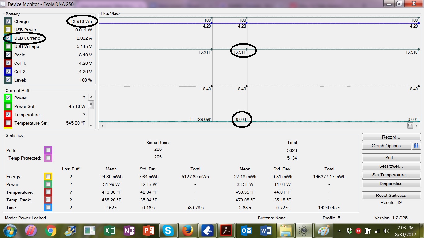

  4. Her are a couple Screenshots of what to look for.

  7. Hi Again dleone32. I have a Drone- so only two batteries to deal with- your Mod has three- still use escribe to monitor the charge current in the Device Monitor Tab of escribe.
  8. Yes- you must Monitor your batteries with Device Monitor and note the Wh rating is when the charge current drops to just about 0 mA. For my old but still good 25R's the WH reading is ~13.9.
