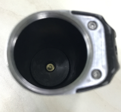

  3. I am sure that you missed the point that the battery cup it was not all the way screwed. So, for what over-tightening are you talking about? Take a look at the first page photos, especially the one that has a close up to the bottom cup, before your conclusion is that this is a user error... Then come again and edit your post... Even IF this is the case, the design and implementation, MUST preventing that "over-tightening" by giving a little more space to the battery compartment.

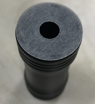

  10. They already send me photos of the "parts" In fact the "parts" is an insulator that they believe can protect the positive of their shitty device. I am done with HCigar. hello dear Very easy to operate, do not need to disassemble, as I sent to your picture operation, put the gasket on the 18650 battery tube, and then posted at the bottom of the positive. Without any additional cost, we will send to you free of charge. Best Regards 2017-08-14"
