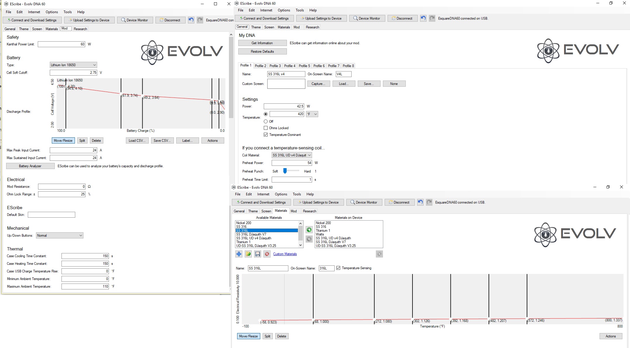

	Settings: I ran stock 316 and got whispy airy hits. Uploaded the steam engine 316L profile. Still whispy. Made a profile (we will call 316L2) with the TCR set instead, tried .000895 - .00095 with better results around .00095. 20-30W pre power, 1-.25s preheat, 5-9 punch. 375-475F. 42-60w.

	Try my goon, same problem. Fiddle with temp and watts, nothing. So i pop open escribe and start reading about it. Create a 316L csv on steam engine, but nothing. Once i tried the 316L2 profile with the set TCR, i cranked up the temp to 475F and it was working better. Essentially it would kick into temp protection at like 25W max, but it went up to about 35W at 475F. Keep in mind i had prepower and power set 52-60W, but it never hit those wattages.
