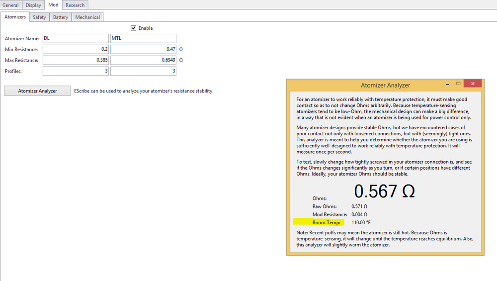

On my DNA Go, I haven't been having much luck liking the vape on either .5 or .25 pods. It just feels like they have a low ramp up and eventually burn out as I am forced to take longer pulls. Just checked in the Atomizer Analyzer and noticed that the Room Temperature is at 110F, which is completely way off (actual room temp is 70F). I am wondering if this is an issue and maybe causing poor performance. I tried to do hard reset, reboot and soft reboot, but nothing seems to make this temperature go down. Even in the Device monitor the Board temperature is constant around ~122F Anyone who can chime in and let me know what can I do about this.
