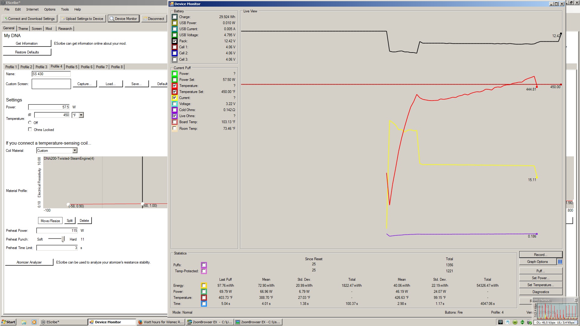

	This build is going to be hard to beat for Unkamen's Nickel Free 28 gauge SS 430 that results in a stable temperature. It is 16 wraps of twisted annealed 28 gauge around 3mm arbor at about a 1.5 pitch. Came in at .445 cold ohms. Twist pitch ended up at 1.5mm A lot looser than I wanted but that is where the ware broke. When I replace this coil I'll Anneal the wire before twisting instead of after to see if that gives me a tighter pitch which should increase the cold resistance a little more. The graph below is about a 5 second vape in a 10 second window. Set for 90 watts, 1 second 150 watt preheat. Vertical coil on a Steamcrave Aromamizer. Going to kill a battery quick though.

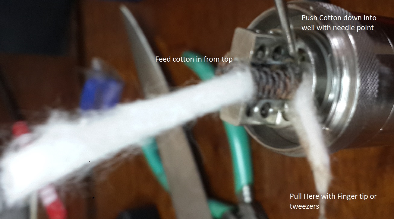

	I almost hate to show a picture. It is a Very Ugly Coil but has lots of mass and surface area and vapes well. There isn't a lot of room under the bottom end of the coil. Maybe 3/16". Actually Looks more difficult than it is to wick a set of verticals. With a little practice, less than a minute to wick. Wicking requires long strand cotton. I use Japanese cotton. Regular organic cotton from a cotton ball doesn't work very well. Feed cotton into the top until it sticks out from the bottom a bit. Capture the tip of the wick with a needle point and fish it out to the side until you can grab it with finger tips or tweezers. With needle point press down on the cotton into the well while pulling out the tail. A two hand operation. Loosely fill the juice well with cotton and trim the top almost flush just a little above the top of the coil
