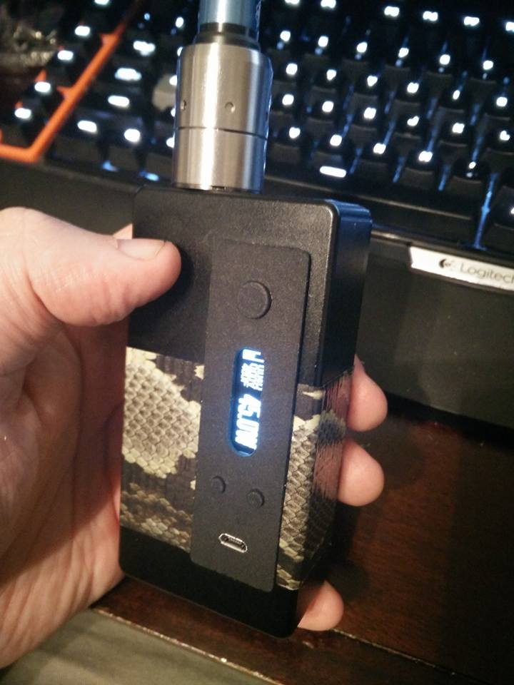

where did you get that gray part that's between the case and the white screen holder?[/QUOTE] It looks like a mamu faceplate on the inside. the faceplate comes with the screen holder as well.
So the hydro drip on the case peeled off badly. you can see the in the screenshots above. So i went and peeled it all the way off, and painted it myself. I call it the Super Bee. Mopar inspired.
