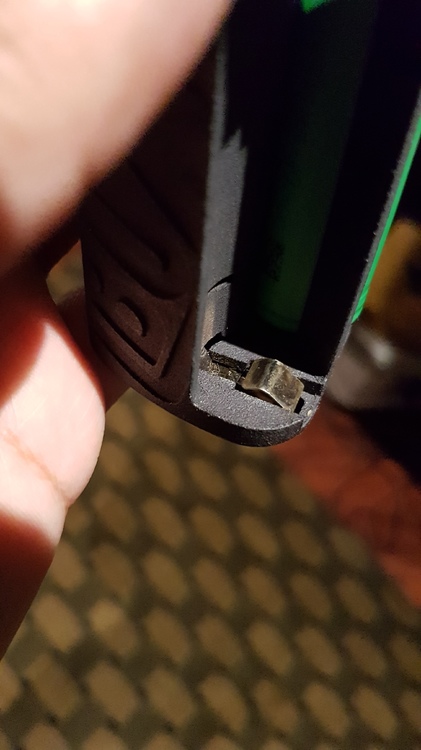

I bent the conact up a decent amount, couldnt quite fit anything in underneath yet but i wanna test it out first a few times and see if it is indeed just a battery contact issue, everything else doesnt make much sense besides not having a good connection, ill try and see maybe i might get a buddy to find something better to solder to it but for the price i cant believe what shitty contacts they use..that spring contact seems much better! What mod did you do that in? Ill have to see if a friend can solder something like that together and make it fit, but for now ill see if i get better battery life with the better bent contacts and update.

Ya i guess ill try that, id have to find some pretty firm rubber foam though, not quite sure where or from what i could find that from and it would have to be a pretty small piece since there isnt much room like your pictures shows, it looks kinda like it does in the picture but i think it'll be a bit tough. Couldn't i use a thin piece of business card folded a few times and shoved underneath to try to make a more solid connection?

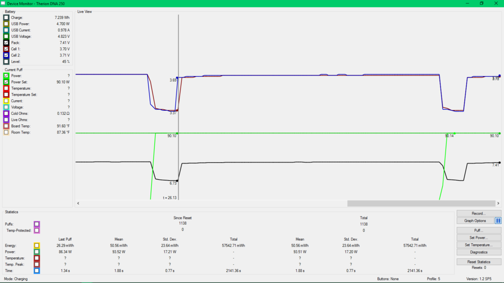

So sorry this is gunna be a long post..i have been talking to GingerVape and hoping you guys can give me some insight on how i should go about a answering them & if my logic is sound as well. Here is a snippet of part of the conversation after I provided them with the graphs ive posted above and explained the flaking of the gold plating which they said it should still work regardless. Their response.. Got a.. in my view pretty dismissive/rude responce back but anyways, I am still getting throttling after buying a set of brand new Sonys VTC5A. Instead of 55% percent I get to 45% percent before again, it flashes the battery & throttles the power down. So my understanding is if im STILL getting throttling with a brand new 30amp battery there is obviously some connection problem somewhere & running a battery analyzer wont really fix this problem or do me much good because sure i wont get a flashing battery or throttle power anymore but my vape time is going to get cut at 45% with sony vtc5 30amp batteries or 50% battery with samsung 25rs, just like it is now but it will just show me a 0% battery quicker because the battery analyzer was done with this connection problem. Plus i dont think i should have to run battery anazlyer just to get my battery percentage down past 45%. im not sure if this will address the real problem and just give me a work around to make it seem like its working normally. Ive never had to do this with my other 167 chips & im not sure if im correct but if theyre not willing to explain it to me, was hoping the community might be able to help explain it to me better or if im not grasping something here.

Well i did buy the mod used so it wasnt in my possession since the beggining and i believe the previous owner didnt take care of his mods to the extent that i do, but yes i agree..even if i do take care of it once replaced, its likely to have the same issue if replaced with the same contacts..kind of a shame since boxer mods are pretty good quaility but they're only as good as their weakest link Well guess ill wait to hear back from boxer..at least mines explainable guess alot of the therion problens are still not.

Ill have to re create this and take 2 snips because there is no scale on the sides showing what level it is sagging to. So ill have to point to it with my mouse to show the level at rest & under fire. But i only get this problem with this device, i could pop those batteries out and put it in my therion with the same atty and continue to vape without any sag or throttling of power. Also have tried with 4 different sets of 25r's so i dont think the batteries are the issue..3 sets of batteries are brand new as well.
