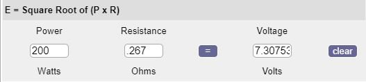

A couple of more calculations solving for multiple variables seems to show that I can't really rise above 164w on a 2 cell capable of 30A continuous output either while remaining above battery cutoff voltage, unless I'm mistaken? The Molicell P42A can do brief spurts up to 40A according to Mooch's test, but for continuous output he rates it at 30A. So it looks like I could lower the coil resistance to 0.184 and stay within battery cutoff voltage and rated amps at power up to 164w Am I getting this right - I'm trying to solve here for the situation when the battery pack is reaching empty...

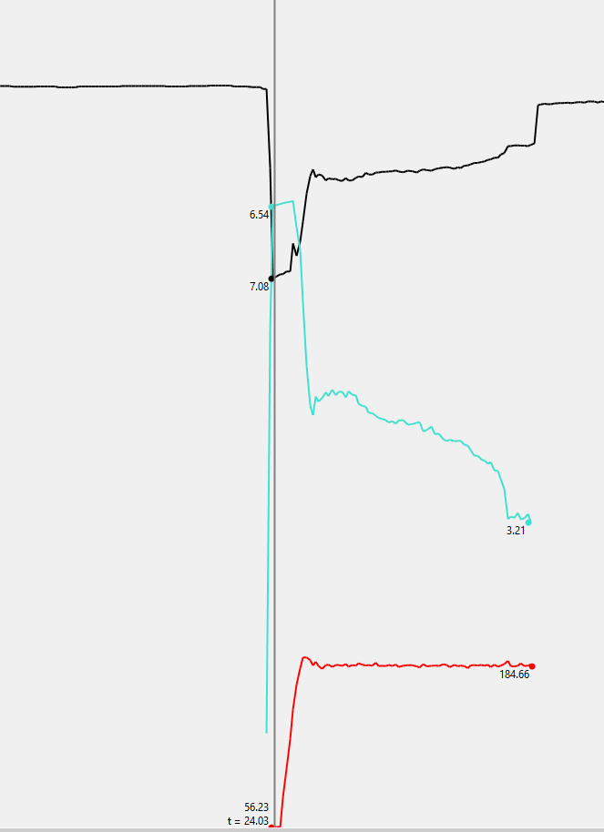

The error always shows at the beginning of the puff, never the end. However, using that calculator and solving for V And keeping my fully charged mod connected to Escribe the whole day, so I have something like 160k data points, I can see that maximum voltage sag takes the battery pack down to 7.4v at the point of maximum sag if I use a preheat of 200w. So it's not hard to imagine that with a less than full battery, even 80%+, that it could sag below 7.3v and trigger the weak battery message during the preheat phase. This would be consistent with the symptoms I'm experiencing (mostly happens at the beginning of a puff when I have not taken one for a while, so the coil has cooled down). So what I really should be doing here is keeping the preheat power no higher than probably 140w..I'll need to experiment and look to see what the battery pack sags to when it's reaching 30% charge or lower to determine what would be the maximum setting for preheat. Thanks for the help @dwcraig1 and @retird
I'll need some time to try and replicate the problem. What I posted was a normal puff, where the weak battery message did not appear. It seems quite random. so I'll probably need to try for a while before I can record the problem - I'll do as you suggest and check a bunch more boxes
Thanks, I'm coming from a 3-cell device so I was aware that power should be reduced, although according to the spec sheet you so kindly linked, it should be capable of 200w on a 0.26 ohm coil if I'm reading it correctly (the chart on page 6)? Unless I should be referring to the Nickel chart instead of the Kanthal chart, in which case it looks like it maxes out at around 140w? That said, I'd previously reduced the pre-heat to 150w and I still get the same symptom...I'll try decreasing pre-heat below 140w and see if it fixes things....failing that I'll need to make a coil with a lower resistance than 0.26 ohms it seems.

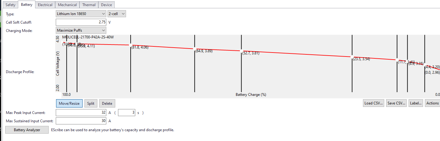

Every so often, randomly it seems, I'm getting a weak battery warning with my Dovpo twin 21700 mod using two brand new Molicel P42As. Not sure what's causing it - the problem happens even at well near to 100% battery. My preheat is set to 200w (dual coil SS304 claptons @ 0.26v) punch 11 and then normal power is 120w My battery setup is below Anyone have as to what in my setup might be causing this? I doubt I have dud batteries as I bought them from the official UK distributor
See my comment in the first post. I've done this already but it has no effect.
