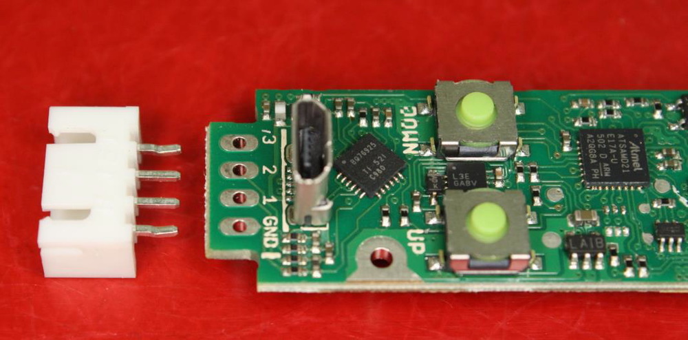

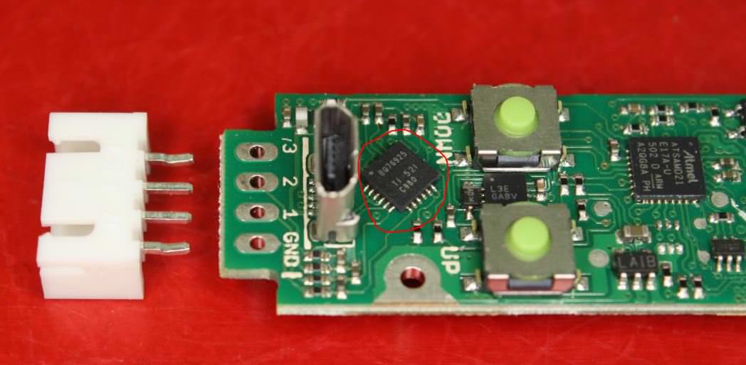

3 fried dna 250 boards and counting after months of research i nailed down the issue. its the balanced charging IC used, you need to RMA the board or desolder and install this faulty IC Check here
Hello, This is to discuess the charging issues on the DNA 250 "Balanced" charging chipset. I owned 2 devices, the Rebel 167 and Vaporshark 250. Both of them DIED and the reason was the charging IC is fried. I went to a local repair shop where I live and they told me this is a common issue and the IC needs to be desoldered and a new one installed and they didnt have stock. I had to buy New boards. I see multiple users complaining about 0% battery here and CHECK BATTERY status and in Lipo case not charging at all. Why did EVOLV use this faulty chip?

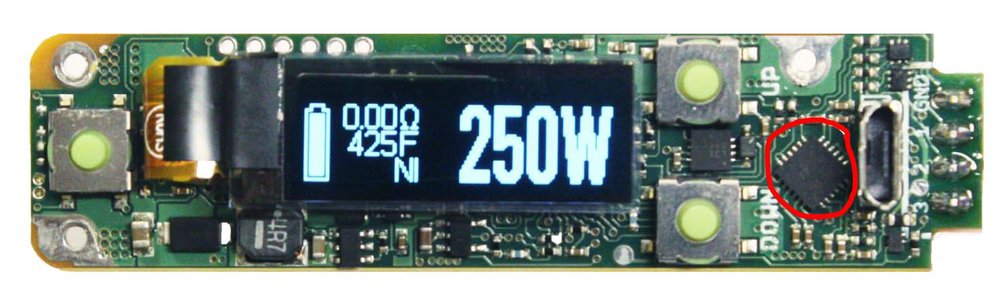

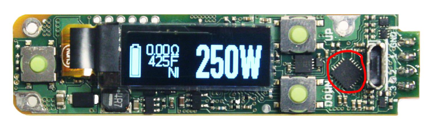

@Wayneo I gave up and went to a local vape shop for repair. They suspect the issue is with the Charge IC above the usb port in attached photo they said they will try to work it out- 19 replies

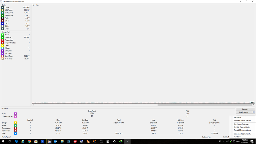

@Wayneo No charging icon. I redownloaded escribe, same version i had previously installed. Full screenshot attached with the options I get when I click on Diagnostics- 19 replies
