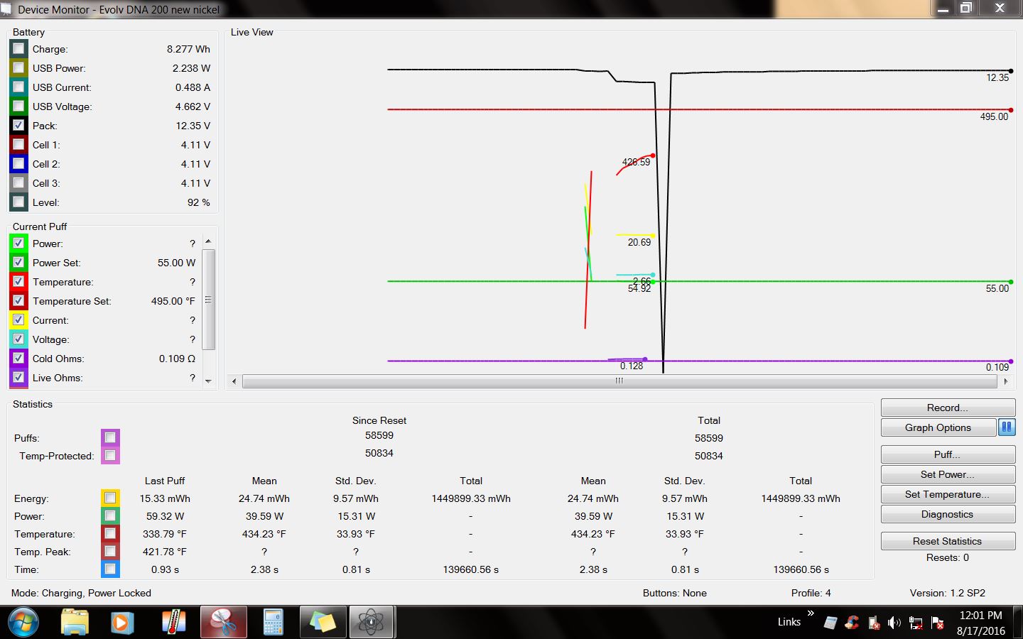

  1. yes I don't word things so well do to how I see it after using mec mods for a while to pull a good battery down to 3.6 I know I am pulling some high amps close to max or better not making fun or trying to be rude to pull LG down like that your going to generate heat

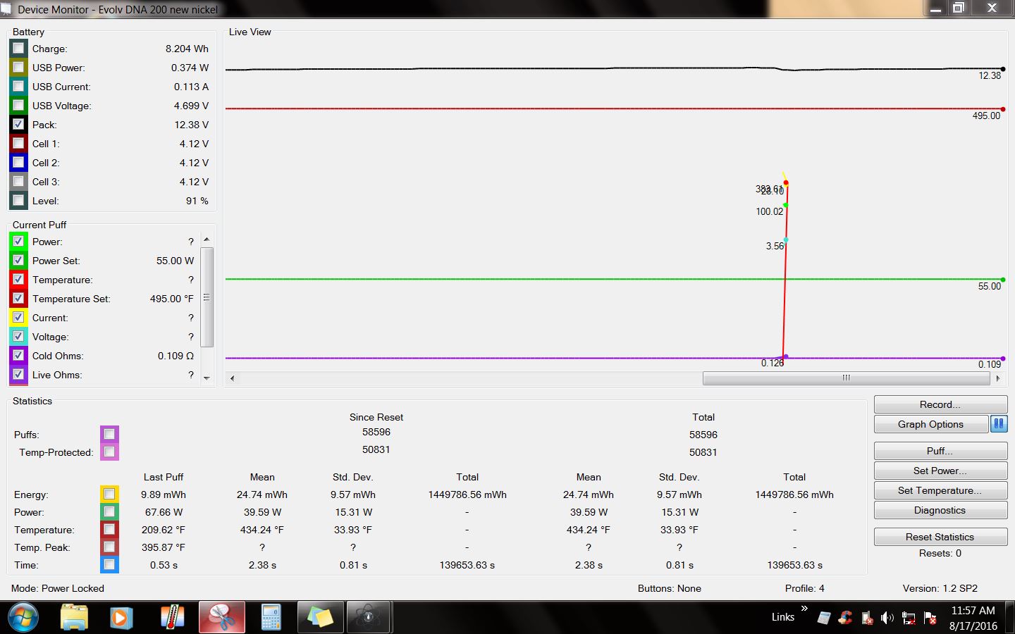

  2. something I watch board temperature you are showing about 30 degrees room and running temperature difference on the board that says a lot about efficiency of the device I'm from the old school. Voltage drop amps increase along with heat and heat not being a good thing on any board just my opinion

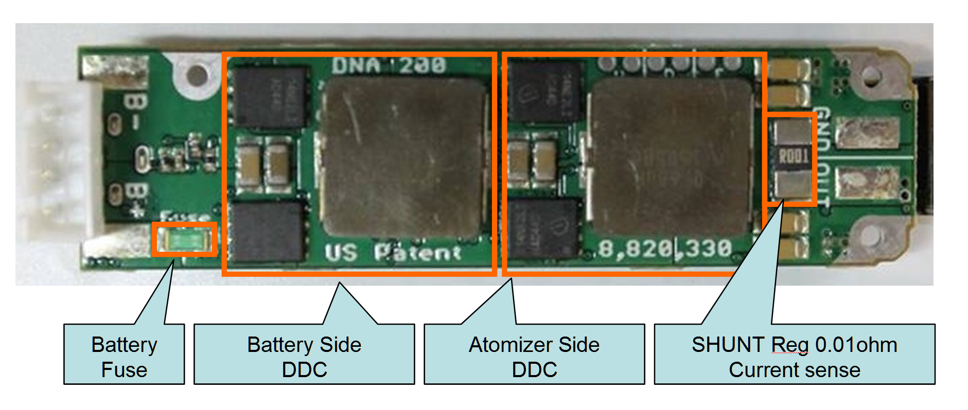

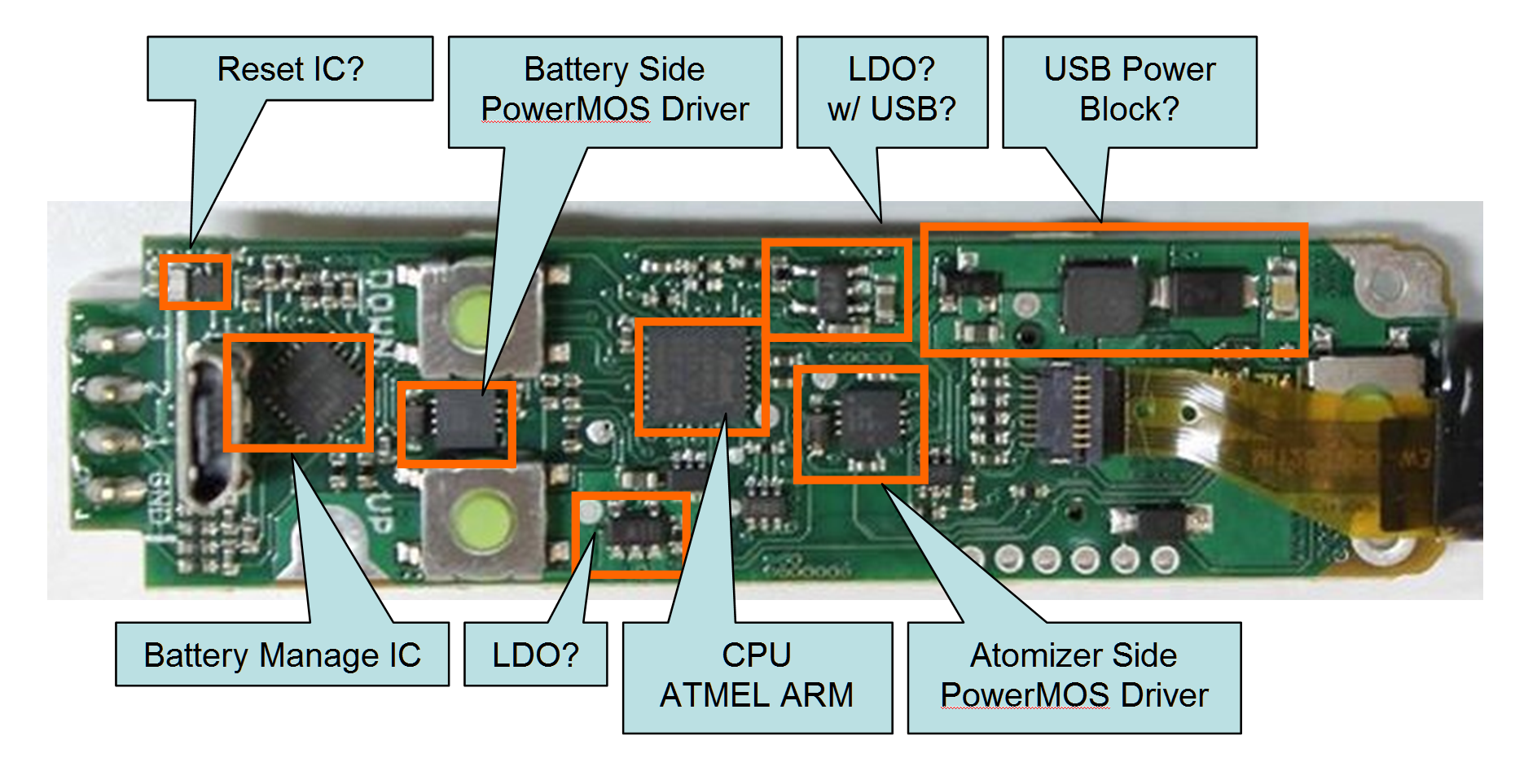

  3. Here are some pics I found on this site helps to identif some of the components if you could post a pic of the future up the board I am working on a though process with a Little Help from My Friends I would be thankful .I am not affiliated with evolv in any way . evolve is very good about there warranty head on over to there website contact customer service I am always bugging them good bunch
  4. Thanks for pointing me in the right direction retird

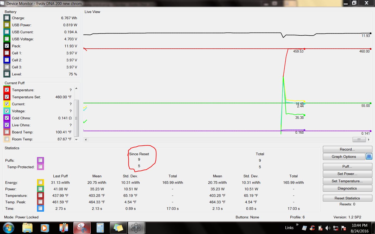

  5. I am missing something here update 1.2 SP3 my says 1.2 SP2 can someone shine some light on this for me thanks

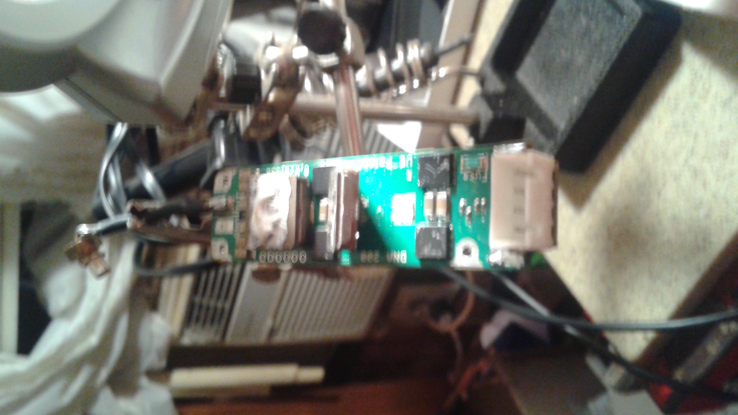

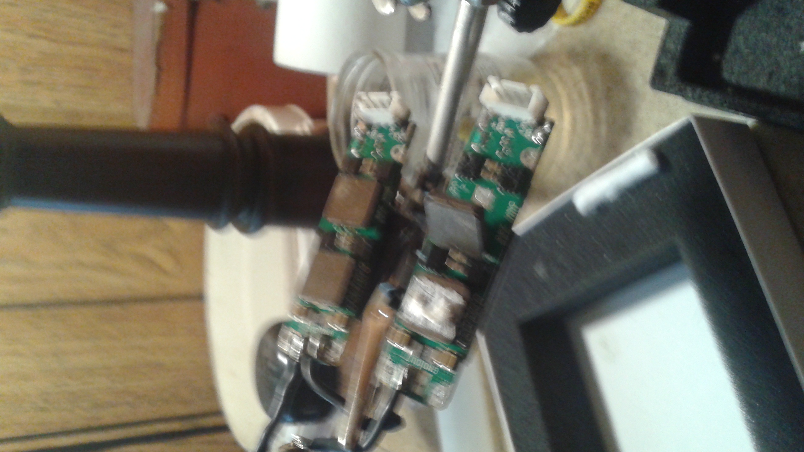

  10. thanks at least I know its name I have no desire or abilities even beginning to replace one with that said ever since os 2 xx I have noticed higher board Temps not much never hit 98 D F before now 108 and I have burning at the base of the inductor it gave me warranty message and the fuse is still good that's the board I tried to pop the inductor loose on that one I believe would break the board first thanks for you help

  15. apparently you don't understand English very well I have two boards that failed one burned-out the mosfet andt that's the one I tried to pry it loose on and it won't come off look at the pic you twisted my words before you're not going to get away with it this time you just keep glue in your Mods together and build your UK mods and leave me alone okay

  17. [QUOTE=John]Yikes! That does look cold. On the 200, we have to run the boards through the line inductor side first, and the second pass through the oven they're just held on by solder paste surface tension, so we lose a few here. This one probably was loosened up by that, but held on just long enough to get to you and be disappointing. If you want to try to solder it back on, you're welcome to and if you break it send it in and we'll fix it. If not, just send it in and we'll fix it. [/QUOTE I have been running in to a problem same area at first I thought it was caused by dropping the mod might be still but I am getting a lot of issues that seem to be linked to this part of the board I do not write what I mean so good I am not trying to say anything bad or imply anything I have one that came loses on one side I have looked at it moved it and other side holding strong I have another board after installing the latest up date gave me short message after a week of run time I reinstalled 2/2016 software it then said check battery so I did it showed on E scrib good equal voltage but when I try to fire it bad voltage drop like a short so I installed new battery board out made-up a test stand to fire board out of box fired it every thing check out good .I was very happy this board is out of my go to all time favorite device. The old battery pack did have 8 months of use so no big deal and well over 360 change cycles still playing / testing I heard something short arc and got warranty message .I got a sick feeling at once fuse did not blow first thing I checked but all around I believe it's called mosfet.I have burn marks and damage so seeing this board is history I start trying to see how much it would take to knock loses this box looking thing that came lose on the other board in a short period. in my very unprofessional opinion it would break the board first .I am so frustrated. @John I have had 4 boards fail 3 in the past 2 months .am i to the point of saying my mec mod is what I am stuck with never being able to enjoy variable voltage variable wattage let alone temperature control / monitoring again and safety ? Or might I find a answer in the DNA 250 I do not need more power I run 120 watts preheat max 1 second 65 watts run 510 max temperature or in kanthal edit add in looking over this post do to my terrible grammar it looks like I am frustrated with John the way I typed it I was trying to tag John like I said not good and putting thoughts down being frustrated dose not help

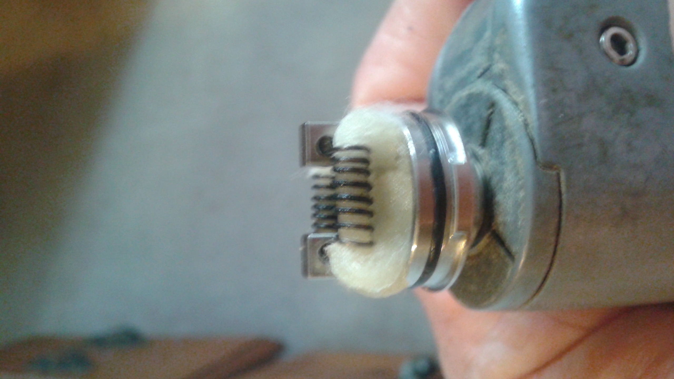

  19. that is quite true titanium in my opinion has to be spaced so that rules out most everything but a simple build get it wicked properly for the RTA you are working on and I find it one of the best builds for flavor hands down
  20. I have had nothing but good things to say about titanium builds most of the time I have learned different RTA can be a bit different I like staying close to 0.1 on my buildings I find the Ti setting provided buy evolv work great I have to give credit to pro vape post on different forms for pushing cleaning and spacing Ti 1 builds I use lightening vape wire 24/22GA wire 24 GA 7/8 raps 2.5 center in Boreas and my Bellow V 3 temperature dominant 120 Watt preheat 55 watt run 450/500 degrees Fahrenheit excellent for me
