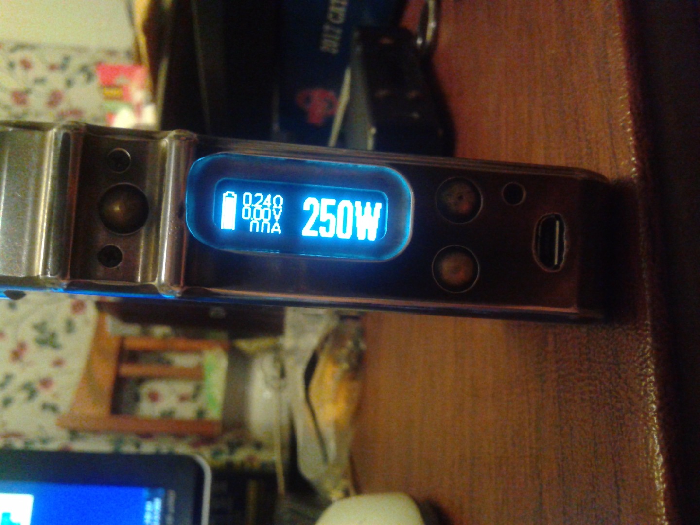

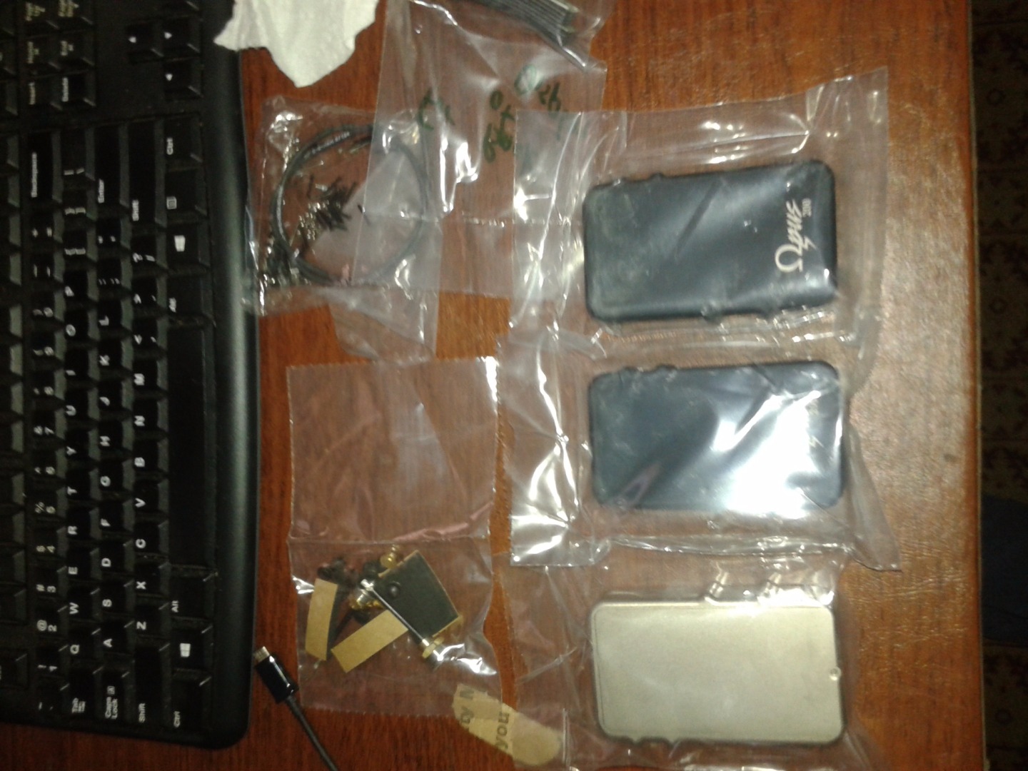

The box is awesome here's a picture of the opus I got a few of these boxes if anyone's looking and they are an awesome mod DNA 250 works great in the opus box

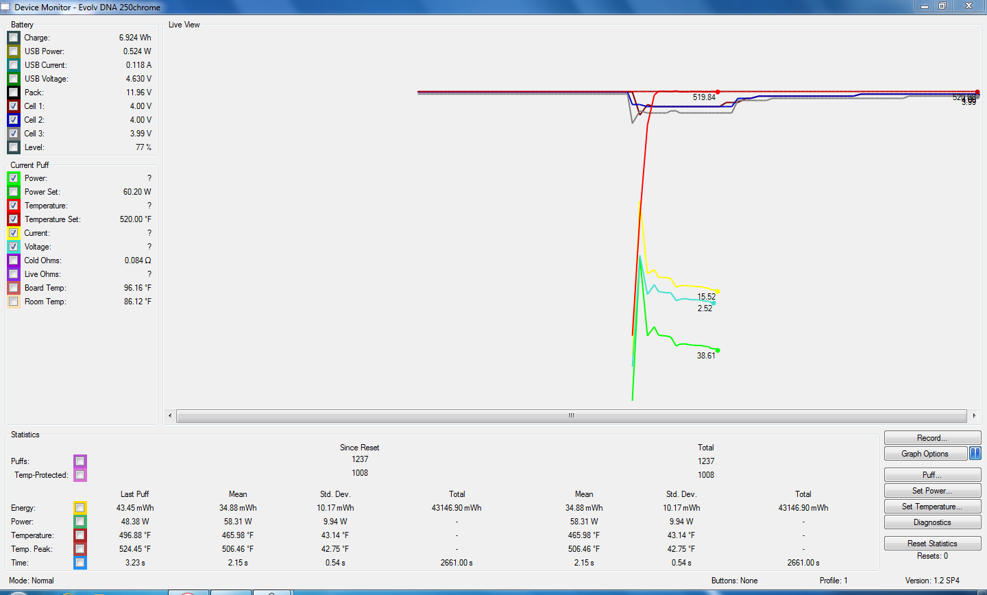

i posted this before is num cell 3 looking bad week ? it gets further off as the pack voltage goes down i razed soft cell cut off to 3.09 and still dose not seem right at cell voltage at 3.10 and below it well not even hit 290 D F coil and no message check battery i am trying to figure out soft cell cut off problem or just poor battery pack thanks for looking DNA250 -

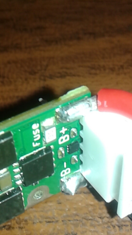

i just built this DNA250 num 3 cell i am wondering if i should replace the lipo looks like a week cell ?

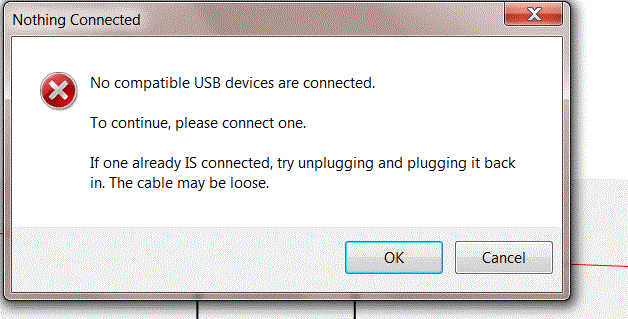

I am having similar problems with a dna200 while uploading new C SV files the mod froze and now it will no longer connect to Windows 7 or Charger won't charge lipo even on a wall plug but the mod will fire just fine -
ok i was working on CSV files for my lipo and going to up load to my device some how i messed up the mod still works but can not LINK to E scribe or charge with any of my chargers I have multiple DNA devices and no problem with any of the others but i did something to this one thanks HELP

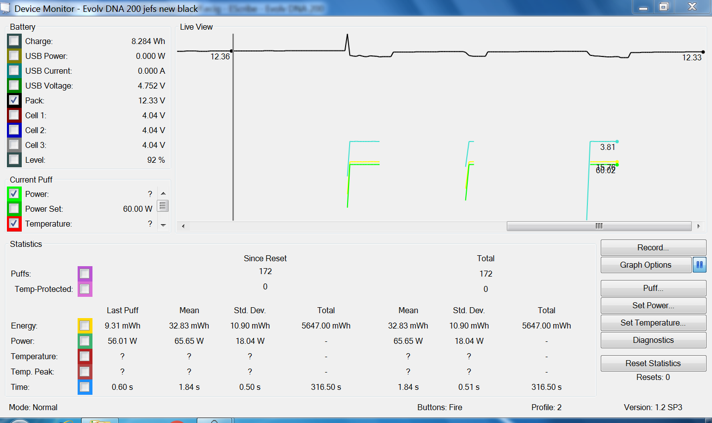

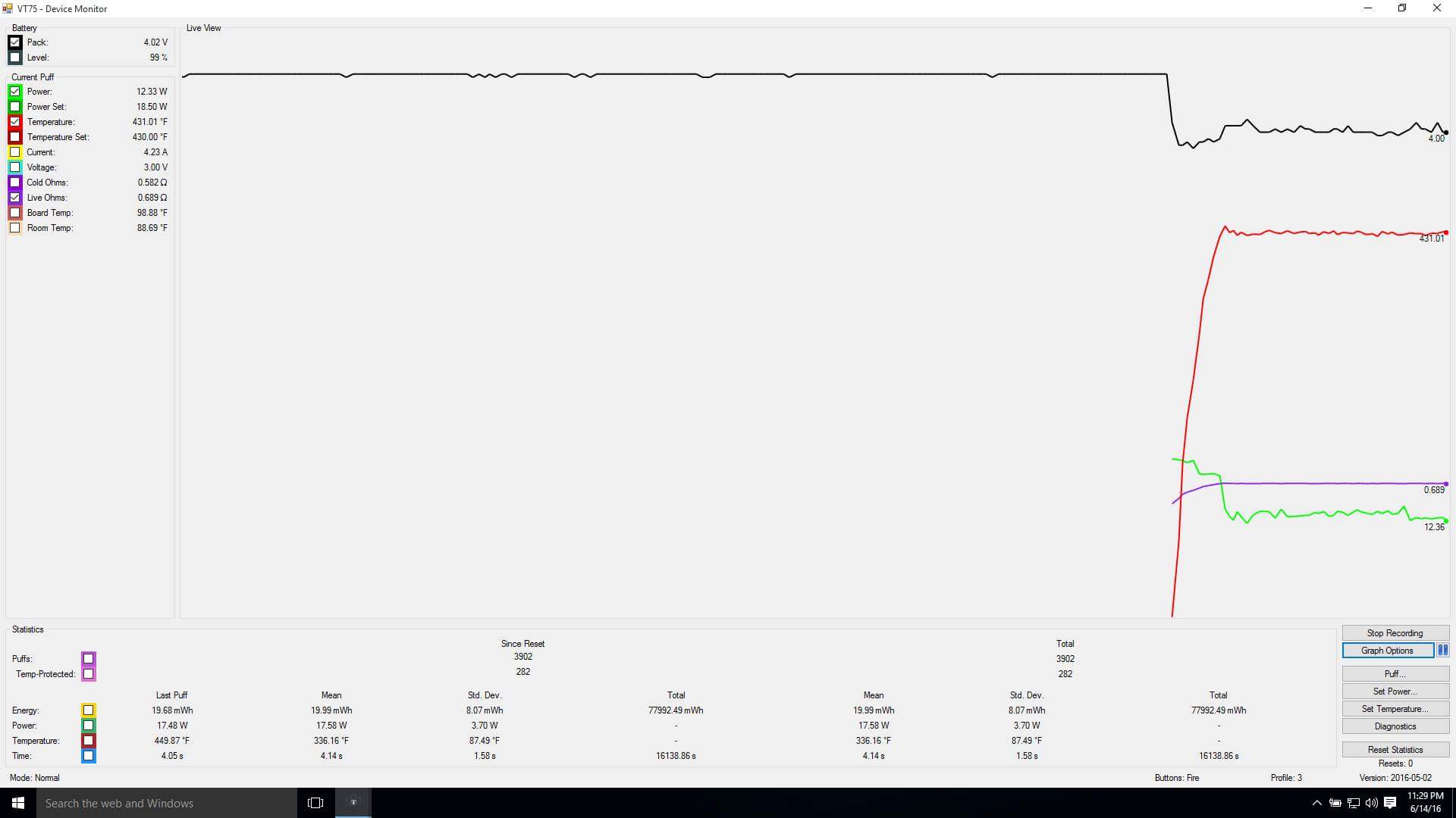

Welcome aboard for my self and I screw up a lot I had to put my fancy builds a side 24 GA ss 316 wire is pretty much my go to never above .15 ohms after setting up my mod using Escrib I use there wire profIle for 316 ss and lighting vape wire works great for me set up temperature, dominant pre heat set 45 punch medium running watts set to 25 the board takes care of the watts as per were the temperature is set 400 degrees Fahrenheit is a good starting point run the temperature up slowly till you find your sweet spot I like to be hooked to escib device monitor to see how my flat line is holding hope this helps here are some screen shots from I believe DNA 200 edit correction that is from a DNA 75 I help set up awhile back do not lock ohms as in pic

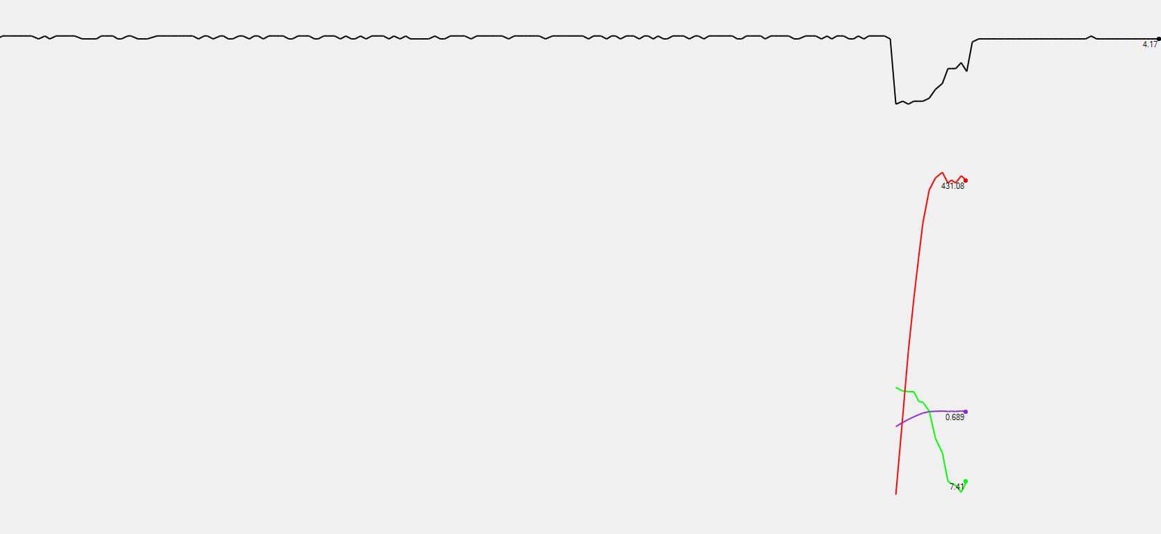

Looking for input I have been using TI builds on my Opus DNA 200 a lot.for past 9 months I have been total against locking ohms .from time to time my coil will change from .06 to .07 after setting for a period of time normally notice it pretty quick the device hits way to hard shows 3.06 volts on a .07 coil thats 49 amps 150 watts that is what it feels like as well I let the mod set using any of my RTA Bellow v 3 and Boreas the Boreas seems to be more stable.until it reads the coil at .06 after setting My set up is 100 watts pre heat punch 1 second at 5 or medium 60 watts run temperature dominant set at 475 degrees F wonderful I locked my ohms to day cold reading was .063 on escrib I am seriously considering changing my opinion about locking ohms as I said any input would be helpful -
