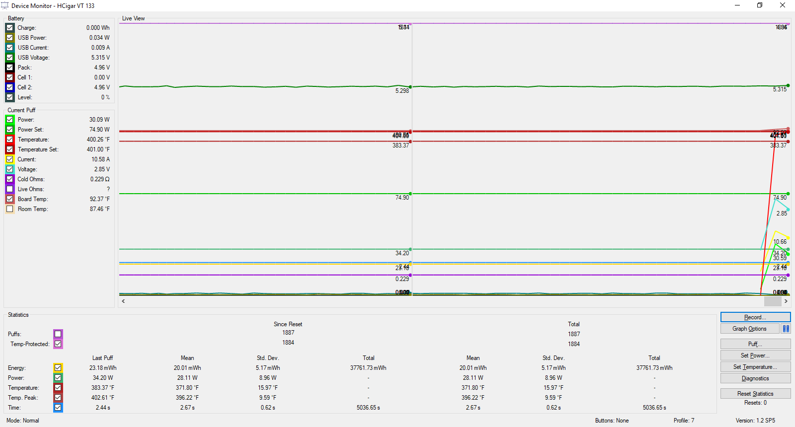

  13. Yes, 5.11 volts, standing. Here's a screen shot with the mod firing. It drops to 4.96 volts, according to device monitor. BTW, at first, the battery charge was reading at 63%. But, it would not charge. After a hard reset, that disappeared.
  14. Another quick question: Since it will work with power supply selected, but won't power on when set to lipo, how is it getting power? Is it the daughter board that's the problem?
  15. Hi, Thanks. It's an HCigar VT133. Yes, it will vape when I set it to power supply. And, it works when I unplug the usb. Is it alright to use it, this way? There was a warning not to use it on batteries, in this manner. Is this just a cover your own ass liability warning?
