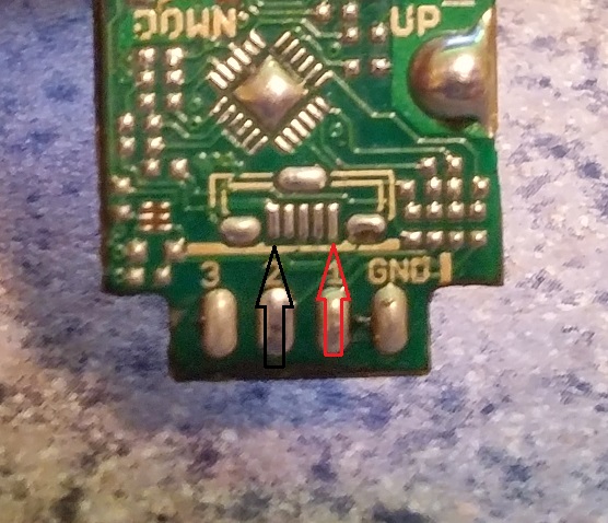

I am loving this. I was thinking of doing the same thing, and to see your progress so far is really great. As far as the two points on the board that are for + and - in for USB, I checked, and as far as I know you will have to go the points right at the USB. I'm pretty sure the way I have them marked in this picture are correct (may have them reversed). Send 5 volts there and I believe you will be good to do. (You will also notice that the USB is made up of 5 contacts all together). Please do not take what I'm saying as fact, as I have wondered these same questions, only did not get far enough to ask evolv specifically.
