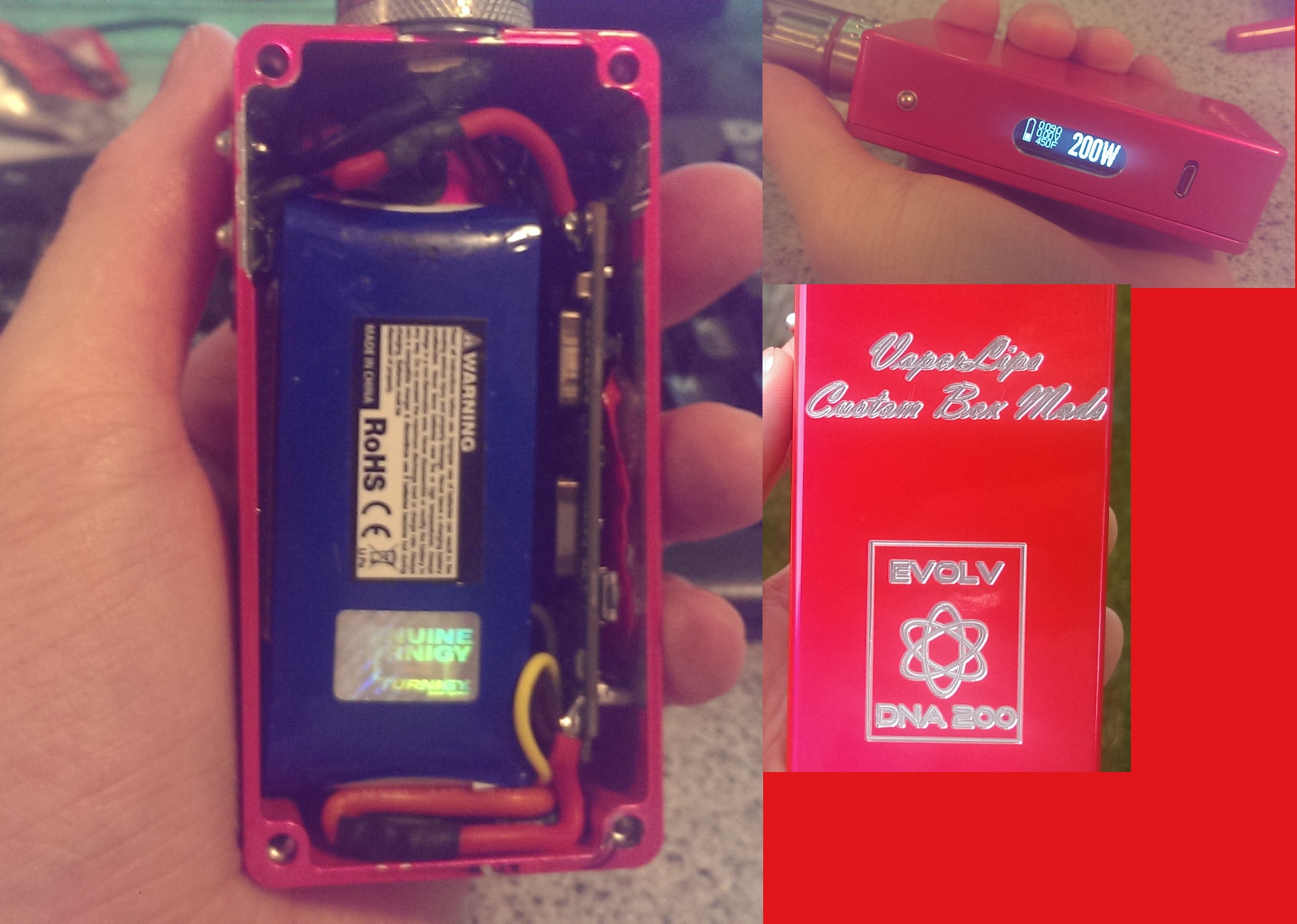

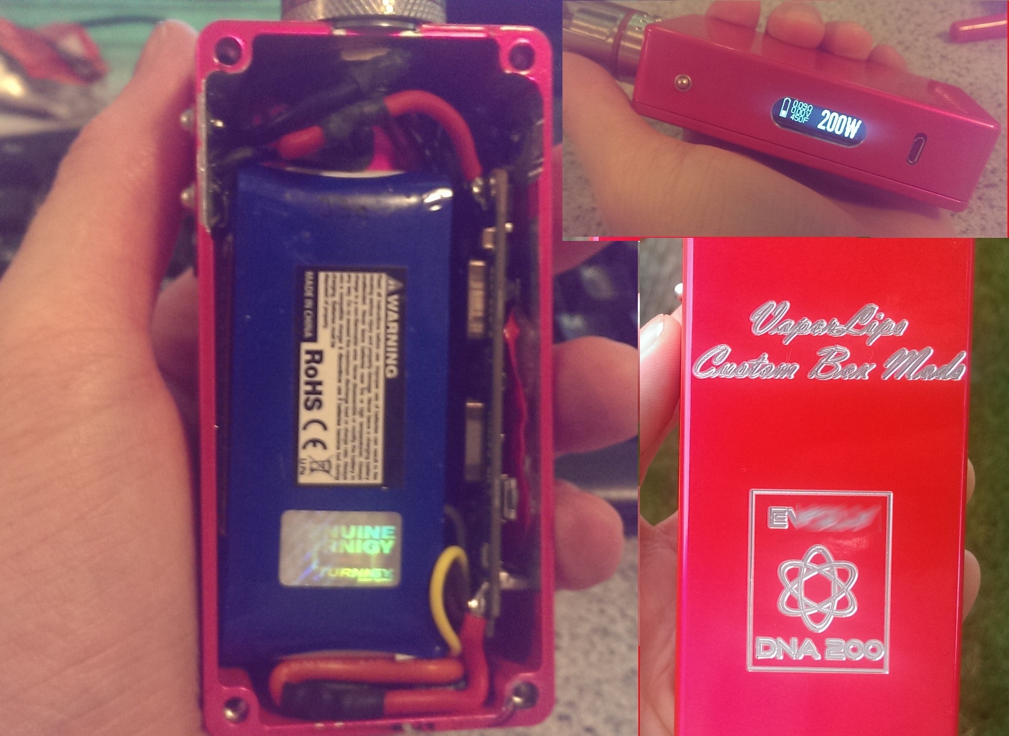

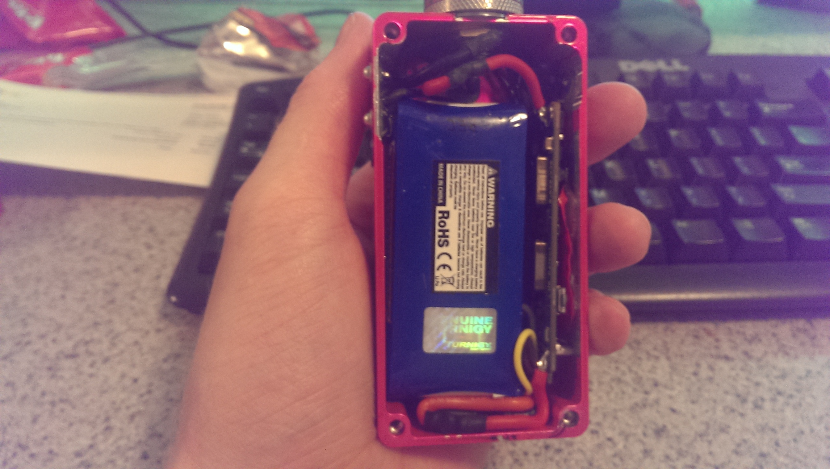

Here's the fit of the Turnigy 30C 1000mah in one of the "CNC" 1590G. This is my "thrown together quickly for testing" device. It all fits as long as you use C&K Tactiles for the switches. Well, you could always use the push rod setup for switches too. -

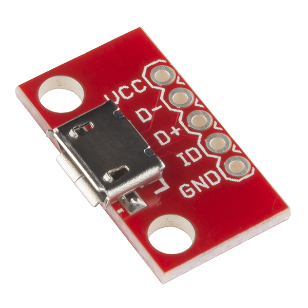

Yeah. Just knowing that it's important to have those wires properly shielded is good knowledge for me. One of these might help on the other end. -
