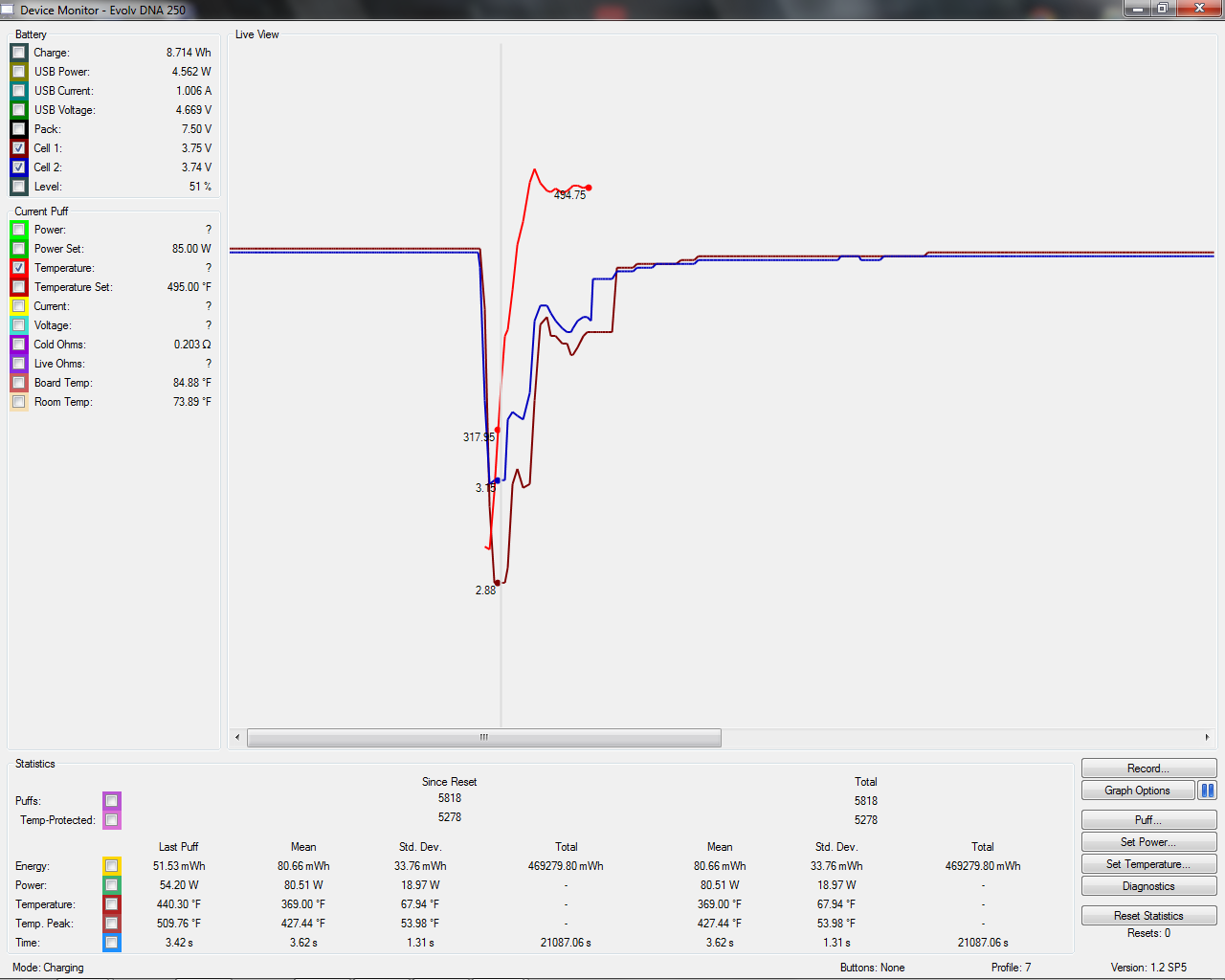

Quite honestly this is pretty severe. These are HB6's and they have been through MAYBE 2 charge cycles. They are brand new. This is just what I have in there this second, and while I normally watch the pack voltage out of the corner of my eye now every so often. I have logged this before without as much deviation between cells, OR as much sag, period. As we both can see it is not long before I hit the low V cut off on a pull. Perhaps my bottom right + lead under the battery tray is not ideal.
