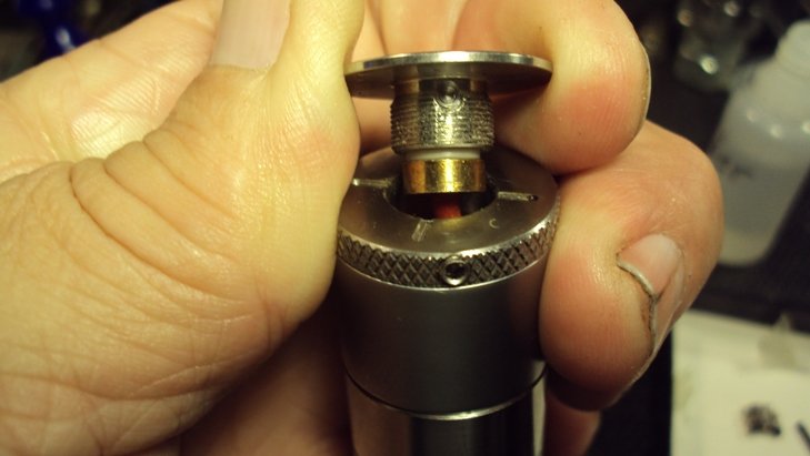

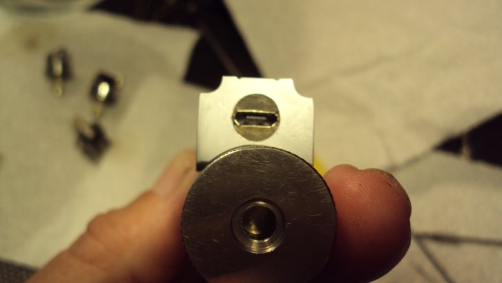

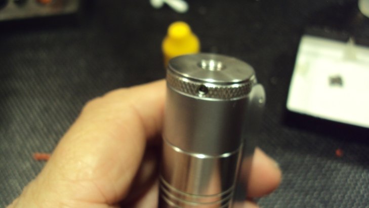

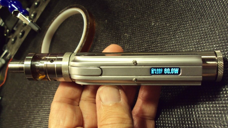

	How about a ZNA 60! Took a new old stock ZNA clone, installed the 60, drilled a hole in the bottom for a USB post, wired it up for Escribe access w/o charging. I also upgraded that darn crappy screw adjustable 510 by drilling out the top cap so I can drop the 510 in and lock it down with a set screw from the side, I used one of the VariTube V1 510's, they have always worked well for me. I have three more of these new old stock ZNA clones on my bench but I don't know if I want to build any more of them. I also put a 60 with the data/charge board in one of the Hana V4 mods. Don't have any pics of mine which is the same blue as John la's above, these pics are just some I grabbed off the net to give you and idea what the V4 looks like. I have one more of these waiting on my bench for another 60 build. Bought a pair of them that were new old stock, there was a fellow (zbbmods) on ebay who was selling left over stock from Hana after they closed their doors. I really like this tiny and light V4, and it really works well.

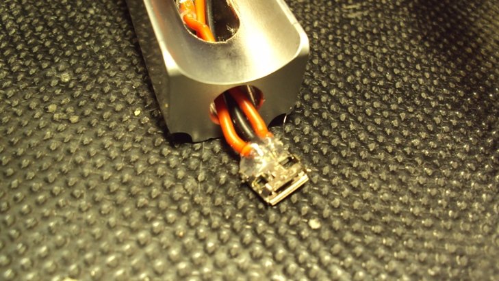

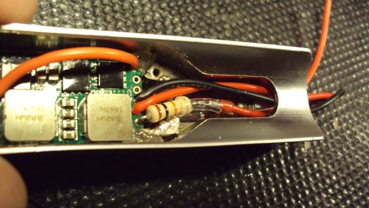

	Yes that is the correct answer thanks to member ChunkButt200 who posted it here with pics. https://forum.evolvapor.com/topic/65550-dna-60/?do=findComment&comment=916132 I finally got around to finishing my ZNA 60 and this worked perfectly. I finally got around to finishing my ZNA 60 project and this worked perfectly. I drilled a hole in the base for the 510 then filled the gaps with some hot glue, trimmed the excess with a new x-acto blade and good to go. I also came up with a way to get rid of the crappy screw adjustable 510 and install a VariTube V1 510, not the mod is perfect.
