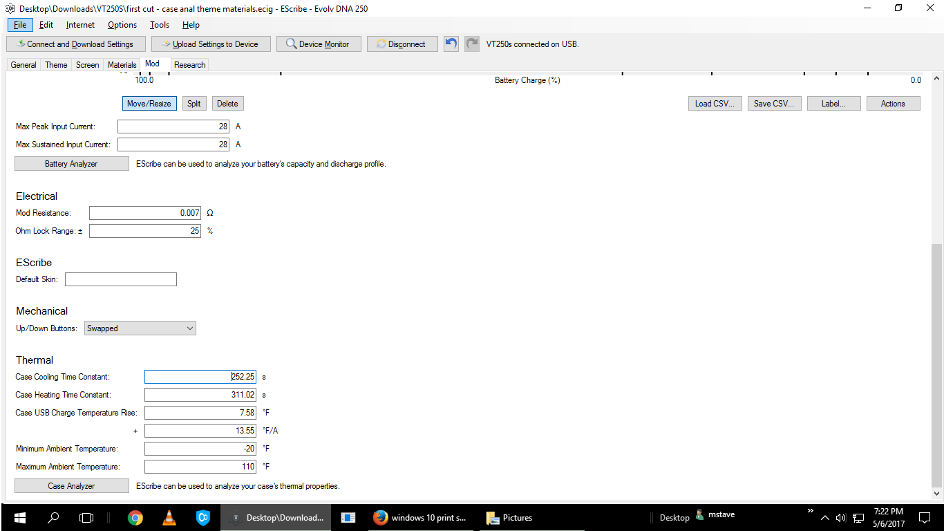

ChunkyButt's right - mine reads 0.004 (I have the tool)

Looks pretty good (can't see the material curve from that screen). Your pre-heat is set for 120W and 2s - unless you are using coils with a lot of metal, that's likely a bit of over kill. Connect your mods to escribe, invoke device monitor and check to see how the coils behave under that pre-heat - could be good, could be too much - then adjust if necessary
