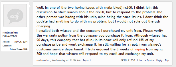

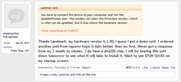

Wondering if that ideal solution has been found for 3s series 18650 reverse battery protection. Wismec Rx200s will be failing in ever greater numbers due to various issues and their owners will be seeking to convert them to DNA200 when Wismec/Joyetech support lets them down on warranty repairs due to purchase from unapproved vendors. Might not be a bad idea to have a guide set up for them to include proper protection into the battery sled when they do since the RX200 sled did not incorporate the raised protection rings that the DNA200 sled did. Here is one recent example. Any help toward this goal would be appreciated by those soon to be affected.

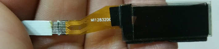

Appreciate the reply. So if I understand this correctly, it is easier to solder the display on, less time consuming (as I don't have to waste my time trying to divine where to get this connector its part number or if I even have the right one) and cheaper (because I don't have to buy it in the first place). Seems like it is just unnecessary unless you want the ability to swap displays easily. Hoping I wouldn't have to do that too often Any advice on methods of or techniques for successfully tinning the traces & soldering it together? Did you buy your cables without stiffeners & insulation at the ends or did you strip them manually? Where did you pick up your cables? Links? -

So if I understand this correctly you were able to solder a screen to a .05mm pitch cable and extend the display on a DNA200 but by soldering directly to the contacts you need to have a reverse or opposite side contact cable to make it work with the zif connector on the board. Can you confirm this assumption on my part. I believe I found a correct cable on digikey http://www.digikey.com/product-search/en?KeyWords=150200084 to accomplish this for $5.83ea w/ about $4.00 shipping. While I have no idea of the quality but these are available on ebay much more economically: http://www.ebay.com/itm/25pcs-Reverse-Direction-8-Pin-0-5mm-Pitch-FPC-Flexible-Ribbon-Cable-Wire-0-66ft-/161775574752?hash=item25aa935ee0 . I've asked the seller for more information and pics of the cable ends but have not heard back yet. Do you have any more input for those of us looking to follow in your footsteps? What cable did you use (link) and what was your procedure for soldering that joint? Did you just flux the hell out of it and drag your iron down the ribbon contacts to tin them on both the extension and the display then line them up & heat up the display side using a wide tipped iron & a lot of pressure just like you were soldering a new display to the older small screen dna40? -

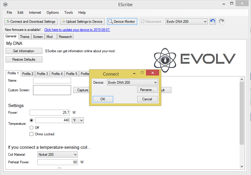

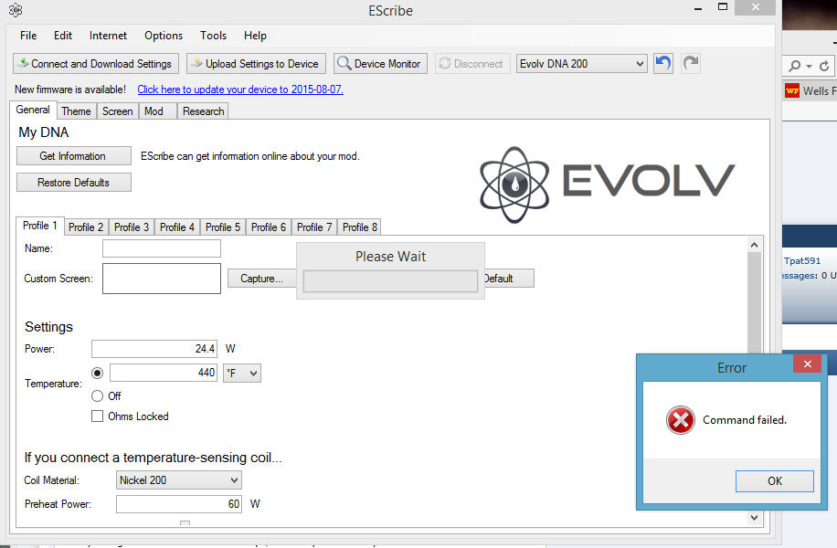

All my computers have been set up to run VLC on a HDTV as a second monitor, however neither was connected when problem occurred. As I said the firmware up load shuts down mod and no communication occurs. When I close the error box and press fire button, the mod lights up and Evolve will display the connect box restoring communication. Not sure reboot was proper term to make you understand what I am saying but it was the term I used, probably in error. Sorry for my stupidity. It will then download settings and allow Device Monitor to be started. My problem is not with the window not sizing properly in the 8/7 update. t is with the firmware updates not uploading to the mod as described in the early firmware section.
Well I'm up to 10 cables I have here in house w/ same issue. It would be really cool diagnostic tool if the Dna200 had a loopback feature so a USB cable's integrity could be tested from within escribe to rule out a bad cable. That error box goes away when the fire button on the mod is pressed and screen display lights up again.
Forgot to post 1st error message screen experienced after Hana screen goes dark on firmware update. this happens on any firmware update (no matter the firmware version date) attempt on 2 separate computers with 2 separate versions, 2 separate operating systems, clean installs, stable version vs 8/7 version. I'm at a loss. I had previously sent service tickets to hana about how the plan to swap out the substandard jst rcy connectors on 2 occasions and they have not seen fit to reply. Their customer service is horrible & I think Evolv should threaten to stop selling to them if they don't get their act together.

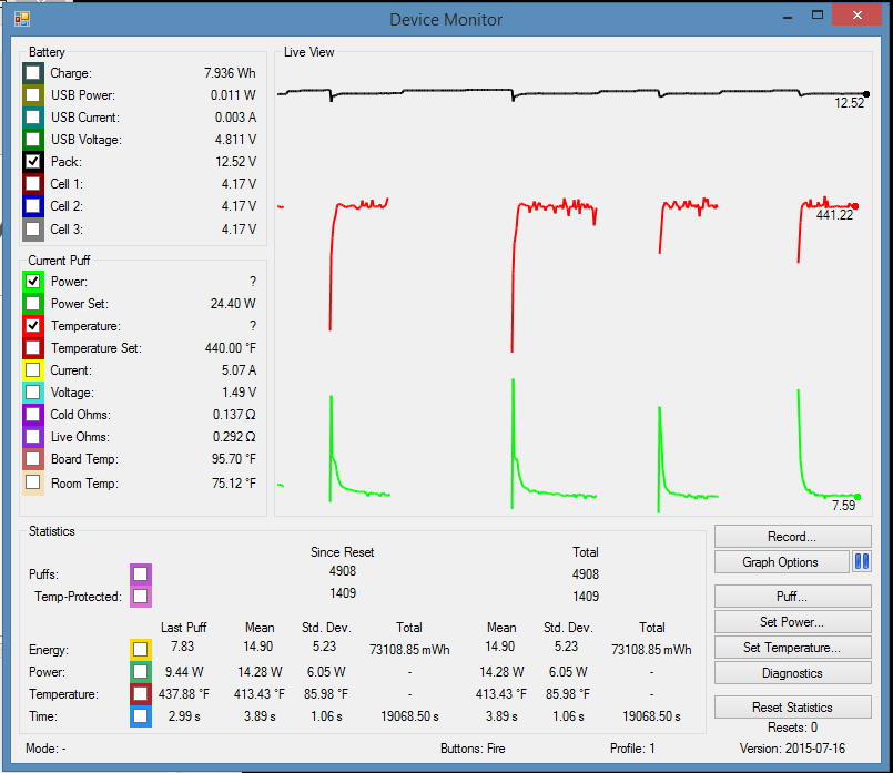

How do you know pressing the fire button reboots the device specifically? What behavior are you seeing? Does something display on the device screen? If you see anything on screen, that rules out it being a firmware issue. If Device Monitor works then your firmware is working. What are you seeing for battery voltage? I wonder if something is wrong with your battery connector. When you use Device Monitor, are you able to fire? Or does it say CHECK ATOMIZER? (What are the battery voltages reading? Keep in mind, battery voltage is read over the balancer taps, whereas power actually comes from the main connector (JST in the Hana's case).)[/QUOTE] My issue unfolded in this thread:/topic/68330-topic/?do=findComment&comment=914505 On firmware upload the "Please Wait" progress box will flash for a minute, device goes dark & will not respond to any communication. Pressing fire button on device powers it up again and will restore serial communication but not in firmware update. I have tried pressing fire button to repower device through the firmware update but it will return error on computer screen command failed. Unit appeared to be operating correctly independent of this vaping a Lemo 2 with twisted 28ga ni200 .07ohm build @ 360deg until on one vape I had 2 separate 1sec full 200w spikes on the preheat graphed on the device monitor that blew apart my build in the lemo and gave me a lungful of fire the taste of which I cannot describe. I was so busy choking on the lungful that I did not think to do a screenshot before it timed out on the device monitor. Apparently it slipped into kanthal mode and blasted 200w even though unit was set for 24w. Perhaps under vaping conditions my build loosened at a screw contact but that never should have happened. Since then the Hana serial cable has developed communication issues and I am using another serial cable I happened to have around. All this happened yesterday afternoon. These were done with a subtank equipped with a ni200 occ as I have not rebuilt the Lemo2. This hana is equipped w/ jst rcy connector that does not appear melted down but i am having trouble separating it. Prior to the Lemo2 coil burnout my preheat spikes were approaching the height of the power checkbox on the left. The double spike when the coil burned out went above the battery indicator line as high as the charge box.

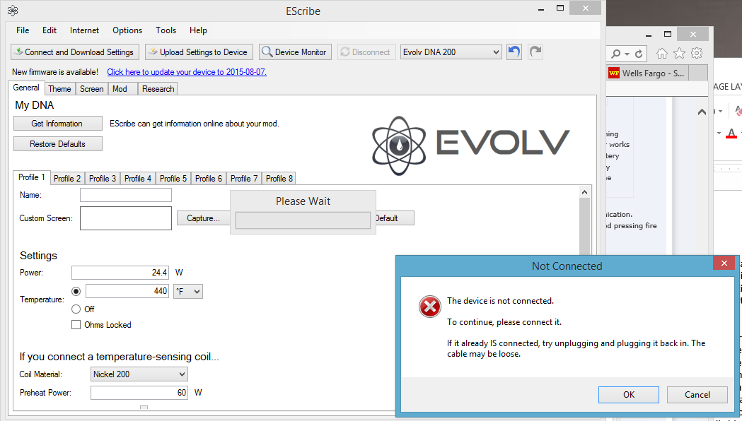

Just did same thing with the 8/7 update. Accidentally left my Hana V200 connected via usb while I ran the https://www.dimensionengineering.com/software/SetupES_2015-08-07.exe Everything went fine on install but when it prompted to update the firmware to the 2015-08-07.sw-update it started to download, the little box flashed, screen went dark on V200 & got error message that no device was connected on repeated tries. Pressing fire button on device reboots device and escribe can see it if I connect through device monitor & appears to work. Pulled cable & reloaded https://www.dimensionengineering.com/software/SetupES_2015-08-07.exe completely same thing happens when I try to update firmware, even when I try to roll it back to 2015-07-16.sw-update. Rebooted Win8.1 64bit computer & uninstalled escribe completely reinstalling program...no change. Tried installing same update on win7 64bit machine. Same thing. Cannot update firmware at all on HanaV200 due to unit shutting down during firmware update. I can only access unit in device manager after hitting fire button to reboot. Just pulled escribe from win7 machine & rebooted w/ intention to go back to stable release escibe & load it but that is release I had on win7machine when I first rebooted the win 8.1 machine & had communication issues there too. Cable is one that came with hana & have been using without issue since I got it. Just tried to roll back to 2015-07-16.sw-update on the clean install of stable release & same issue exists. Think I screwed up the Hana? What process did you kill in Device Manager to Fix yours? [/QUOTE] James, John, or Branden do you have any advice on how to proceed considering conditions described above? is there a command line command to diagnose integrity of board programming & operation of device itself to determine why it will not accept firmware updates?
Updated firmware from 2015-06-26.sw-update it came with to 2015-07-16.sw-update right after I got the unit w/ no problems. Just pulled escribe from win7 machine & rebooted w/ intention to go back to stable release escibe & load it but that is release I had on win7machine when I first rebooted the win 8.1 machine & had communication issues there too. Cable is one that came with hana & have been using without issue since I got it. Just tried to roll back to 2015-07-16.sw-update on the clean install of stable release & same issue exists.
Just did same thing with the 8/7 update. Accidentally left my Hana V200 connected via usb while I ran the https://www.dimensionengineering.com/software/SetupES_2015-08-07.exe Everything went fine on install but when it prompted to update the firmware to the 2015-08-07.sw-update it started to download, the little box flashed, screen went dark on V200 & got error message that no device was connected on repeated tries. Pressing fire button on device reboots device and escribe can see it if I connect through device monitor & appears to work. Pulled cable & reloaded https://www.dimensionengineering.com/software/SetupES_2015-08-07.exe completely same thing happens when I try to update firmware, even when I try to roll it back to 2015-07-16.sw-update. Rebooted Win8.1 64bit computer & uninstalled escribe completely reinstalling program...no change. Tried installing same update on win7 64bit machine. Same thing. Cannot update firmware at all on HanaV200 due to unit shutting down during firmware update. I can only access unit in device manager after hitting fire button to reboot. Just pulled escribe from win7 machine & rebooted w/ intention to go back to stable release escibe & load it but that is release I had on win7machine when I first rebooted the win 8.1 machine & had communication issues there too. Cable is one that came with hana & have been using without issue since I got it. Just tried to roll back to 2015-07-16.sw-update on the clean install of stable release & same issue exists. Think I screwed up the Hana? What process did you kill in Task Manager to Fix yours?
Accidentally left my Hana V200 connected via usb while I ran the https://www.dimensionengineering.com/software/SetupES_2015-08-07.exe Everything went fine on install but when it prompted to update the firmware to the 2015-08-07.sw-update it started to download, the little box flashed, screen went dark on V200 & got error message that no device was connected on repeated tries. Pressing fire button on device reboots device and escribe can see it if I connect through device monitor & appears to work. Pulled cable & reloaded https://www.dimensionengineering.com/software/SetupES_2015-08-07.exe completely same thing happens when I try to update firmware, even when I try to roll it back to 2015-07-16.sw-update. Rebooted Win8.1 computer & uninstalled escribe completely reinstalling program...no change. Tried installing same update on win7 machine. Same thing. Cannot update firmware at all on HanaV200 due to unit shutting down during firmware update. only access unit after hitting fire button to reboot. Think I screwed up the Hana?
