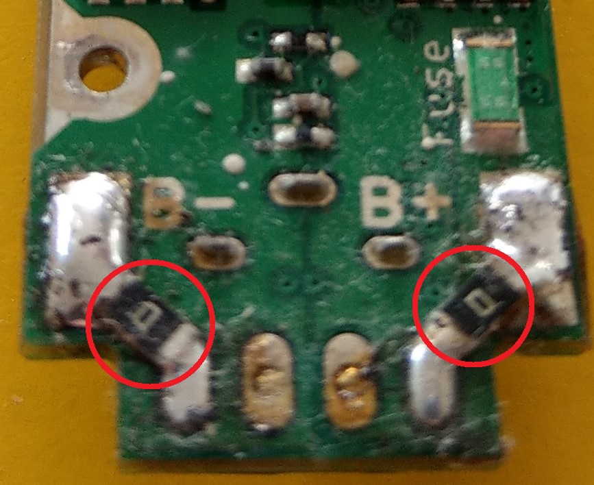

  5. Hi all, I would like some help before contacting evolv. I've been using a dna250 (it had a dna200 and I replaced for a dna250, I don't remember the reason) with a starss player mode 2x18650 for few years already and no issues. This week I've dropped it from the bed side, that is, 40cm max, and in to the carpet. Turns out that after that the mod is dead. It only register one battery like in this thread, and the wiring is the same - https://forum.evolvapor.com/topic/70400-dna200-2-x-18650-not-registering-cell-1/ I did all the wiring again, cleaned contacts, lots of flux, wired it all again, and the issue persists, fuse is fine, continuity is fine, make sure the ground with the box is fine, but nothing is helping. Please disregard the amount of solder in the battery sled, Back of the board - you might say the solder of the b+ is doggy, but that is reflex, I've double checked now after looking at the picture. There's a whole blob of solder in there and the wire is making nice contact https://i.imgur.com/jEb3tyJ.jpg battery sled wiring https://i.imgur.com/60ZMPjf.jpg front of the board https://i.imgur.com/Rthco0c.jpg wiring https://forum.evolvapor.com/applications/core/interface/file/index.php?file=/monthly_2018_10/Dual_Series_18650_DNA_200_250_Box_Mod.thumb.jpg.2742da6e14aa04f0eb2157dc52404524.jpg I remember in the past, when I bought two broken triades and they had the same issue, only displaying something when holding the fire button. In both cases I bridged both pin1 with -b and pin4 with b4 like this https://i.imgur.com/4NM9btD.png and both are working fine for around four years - altough I belive I've read this is not recommended. Any ideas?
  6. Sorry for the bump of a old topic, but I'm with the same "problem". After having one cell not being read, and without a multimeter around, my choice was removing those two "black blocks" (some research lead me to it), removed them, bridged B- to G and B+ to 3 and the device started to read my all 3 cells again. Thing is, can I use it without any problems, or should I replace them? Logic says, replace, cause they were there for a reason. In that case, what are them, and what spec? Also, as I moved from south america to UK, I left all my stuff there. Can anyone recommend me a multimeters to deal sometimes with small components that we got in the dna boards? I'm just an enthusiast, that sometimes buy a DNA second hand and gives a nice clean on it when necessary. Would this do the job? https://www.amazon.co.uk/Multimeter-Tacklife-DM01M-Temperature-Resistance/dp/B01N3RVVJ4/ref=sr_1_2_sspa?ie=UTF8&qid=1524316324&sr=8-2-spons&keywords=multimeter&psc=1&smid=A7AX9JMU6J7L7
  7. Trial and error, but it's done! Just did same wiring as a dna reuleaux I got here, and all good!
