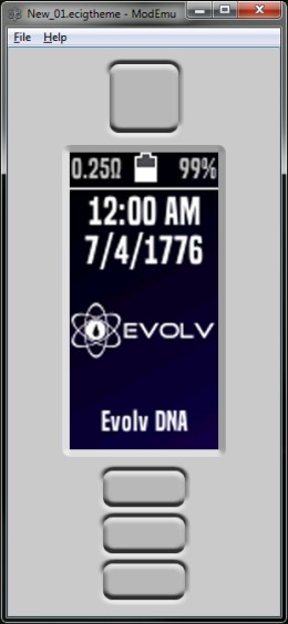

Well, i have a little idea. What if sometime we will have something like "Mod Emulator" - software for testing themes w/o loading it to the mod. For making test of UI logic and navigation. Something like this: -
