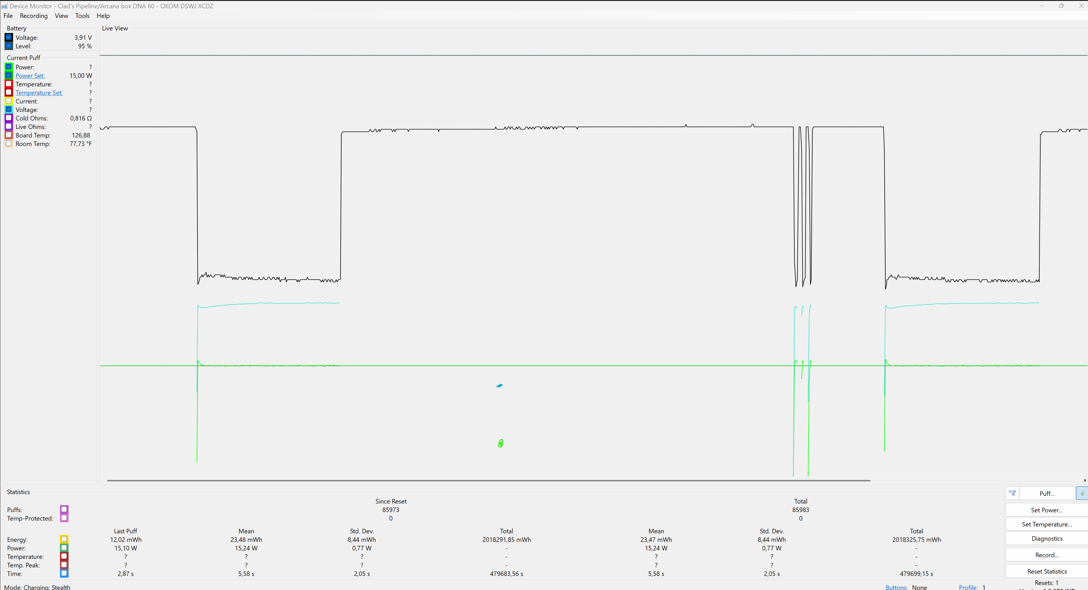

marchetticlaudio Posted May 12 Author Report Posted May 12 Hi Wayneo, thank you for the fast answer! Its a black and white DNA60 not the DNA60C. The power drops are rare, happened 4 or 5 times while the auto lock happened maybe 100 times. It happened with two different batteries. The Molicell and the Panasonic. The screenshot here shows two puffs with a Molicel full battery.
Wayneo Posted May 12 Report Posted May 12 You should really open a Help Desk ticket. Even point them back to this post. They will guide you. Link in my signature line. That 1 second boost really drops your voltage down. When that black line hits 2.75V (default) you'll get a warning.

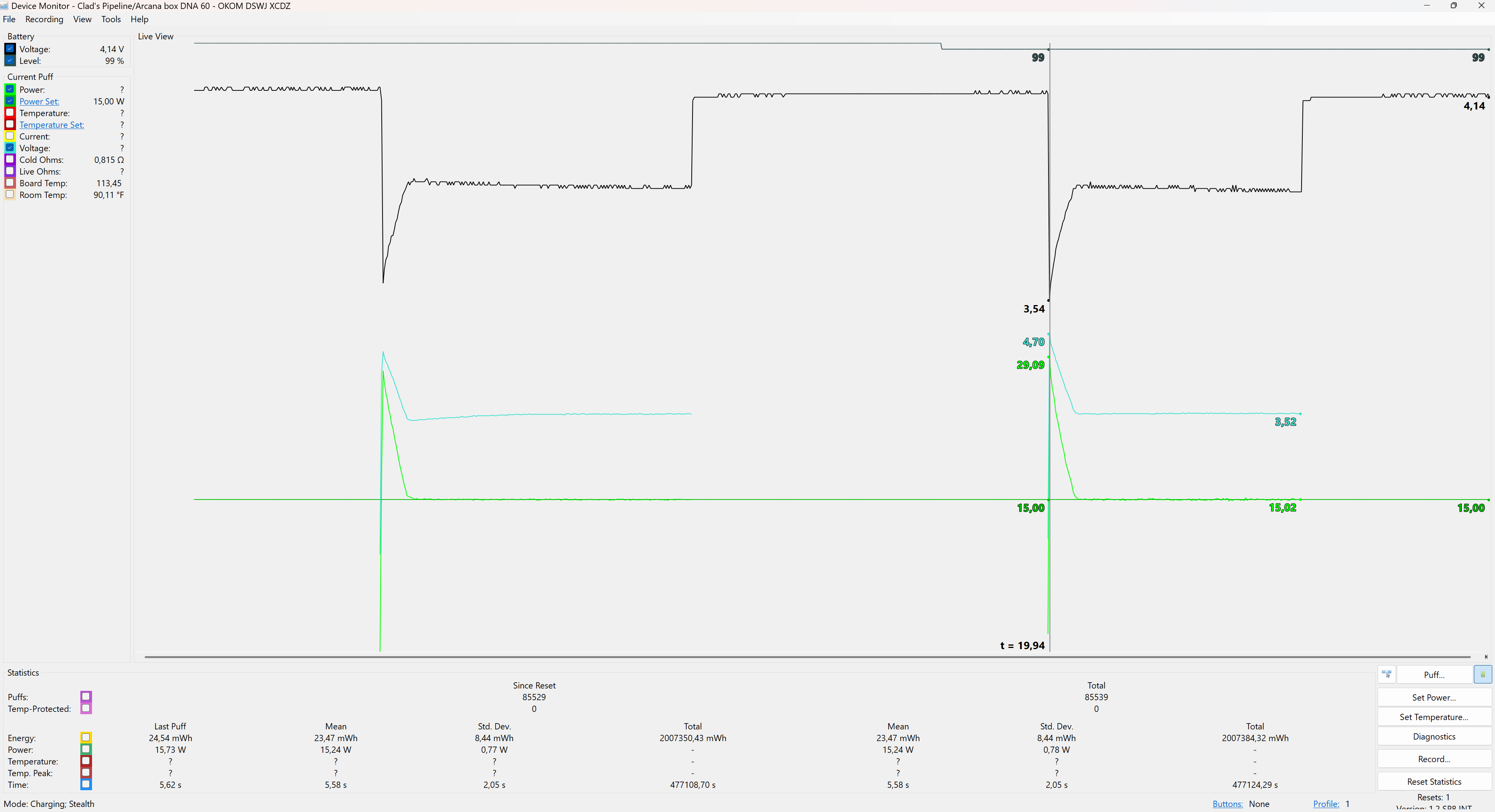

marchetticlaudio Posted May 14 Author Report Posted May 14 (edited) Hi Wayneo, thank you for the answer. I managed to reproduce the issue while connected to the Escribe Device Monitor. At the exact moment it locked during firing, two dots (one green and one blue) appeared on the monitor. These dots disappeared immediately after I clicked three times to unlock the device. I have attached a screenshot where I drew the approximate location of these dots. I have also uploaded the CSV file from that session, even if the data doesn't seem to show anything unusual on the surface, it might contain background information useful for the team to determine if this is a firmware safety trigger or a hardware issue. Thank you for your help. Auto lock happened.csv Edited May 14 by marchetticlaudio
Wayneo Posted May 14 Report Posted May 14 Good catch. When you open a Help Desk ticket it'll go directly to the developer.
