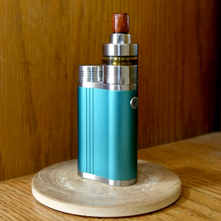

JoeBingo Posted January 19 Report Posted January 19 Just this week I received a Cthulhu Sentinel with a DNA 60C I'm a tootle vaping rebuilder and running a Kayfun Lite (2019) RTA The build is 30 gauge A1 Kanthal on 2mm @ 1.8ohms I vape 50/50 PG/VG 18mg nic 1.8 ohms @ 6-7 Watts Obviously the DNA 60C is overkill for my vaping style. That said, I would like to see a service pack update that allows increments of 0.2 Watts or at least 0.5 Watt increments when vaping under 10 Watts. Right now the increments in the Watt profile are set to one(1) whole Watt with each press of the +/- buttons. I'm new to eScribe and have not found any settings to change the Watt Increment behavior.

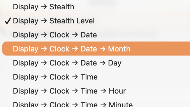

Wayneo Posted January 19 Report Posted January 19 10 hours ago, JoeBingo said: I'm new to eScribe and have not found any settings to change the Watt Increment behavior. These changes and most of what you wish for are found in/under Theme -> Theme Designer -> Screens. Although 'watts' are in 3 places, you should only need to change the Main Page. Easiest way IMHO is to Highlight the field, click options, choose 1 decimal and then the step size to 1 or 2 for point 1 or point 2. Enable 'don't show units'. Click OK. Or if you want to see the W you can go change the font size. You can actually setup conditions such as watts > 10 increment by .5, watts > 20 step by 1, etc. but that's more complicated (and has been done in other themes) I'll address your other wish list items later, or 'search works' better with 'all' better than 'any' (click the magnifying glass. 1

JoeBingo Posted January 19 Author Report Posted January 19 (edited) 3 hours ago, Wayneo said: You can actually setup conditions such as watts > 10 increment by .5, watts > 20 step by 1, etc. but that's more complicated (and has been done in other themes) Is there maybe a downloadable theme here that I might be able to temporarily upload to my device just to see / copy how they did it? EDIT: @Wayneo ... nevermind. Actually your pointing me to the Power Options Settings in themes allows me to do EXACTLY what I need to do for my theme. Thank you sir Edited January 19 by JoeBingo

Wayneo Posted January 19 Report Posted January 19 14 hours ago, JoeBingo said: Right now I only have two(2) screens on my DNA 60C. A lock screen and a main screen that only shows ohms, watts and battery level. That's all I need. ............ For one, I'd like to be able to run in total stealth mode and peek at the main screen with one quick press of the fire button only when needed. I think you need at least a 'New atomizer' screen. The mod, depending on what was written into a profile and the variance detected now writes that new value into your profile or leaves the old. So I'd say 3 screens. Stealth mode has 3 options (Like where I showed above 'Atomizer Power' Above) there are 2 for stealth. The options for stealth level are 'Off', '1', '2', or '3'. Off = Stealth mode is disabled 1 = Dim 2 = Very dim 3 = Screen turns off You'll need to play around to see which you prefer. Years ago in my old tired mind, I think I used a toggle with the 1st field, on something totally unrelated like a battery icon. 1
Wayneo Posted January 19 Report Posted January 19 1 hour ago, JoeBingo said: Is there maybe a downloadable theme here that I might be able to temporarily upload to my device just to see / copy how they did it? There are many DNA60C themes under their Downloads tab. A good designer at a minimum would have written what features are included, some might just show the word. You don't need to upload to your mod initially. Download, and just start Theme Designer, open that file you saved, or even just double click on the saved file. You can use any color theme you wish to learn, beware their features might not be available for your board type. 1
