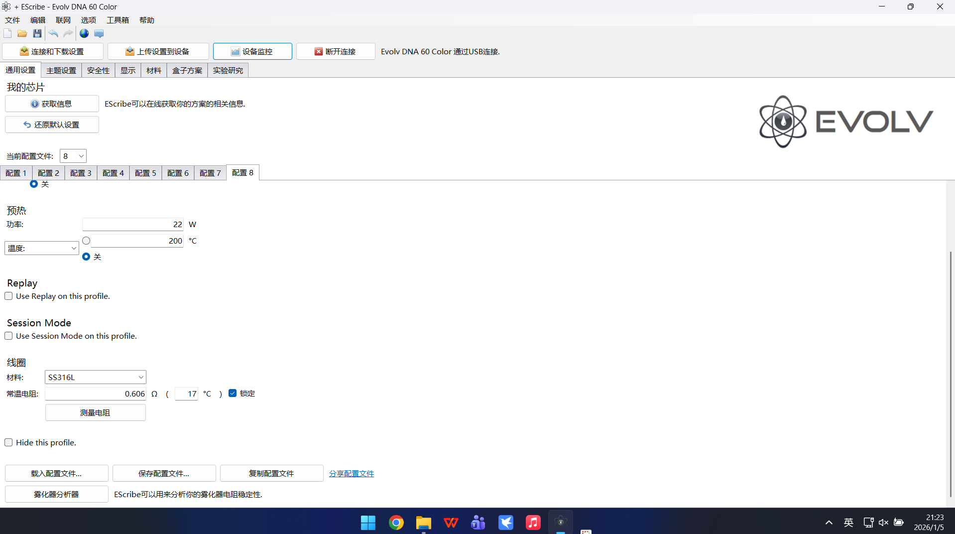

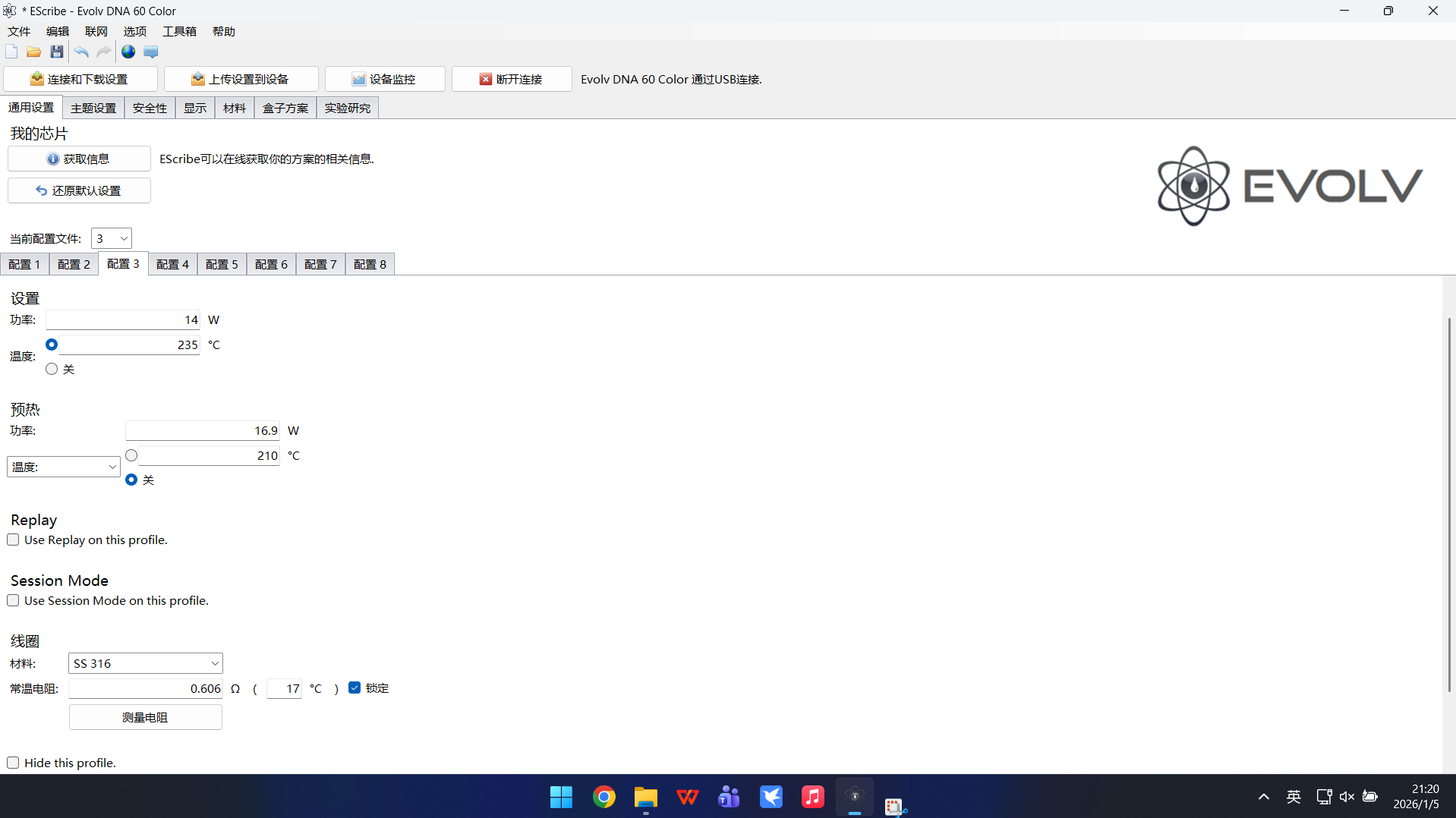

dwcraig1 Posted 8 hours ago Report Posted 8 hours ago You show using a profile for SS316 but say that you are using Ni200 or Ti coils. What material is the coils that you are using?
kzerwu Posted 8 hours ago Author Report Posted 8 hours ago 2分钟前,dwcraig1说: 您显示使用SS316的配置文件,但表示您正在使用Ni200或Ti线圈。你使用的线圈是什么材料? The coil I use is ss316L. I haven't used coils of other materials for a long time. I'm sure that my coil material is not wrong.

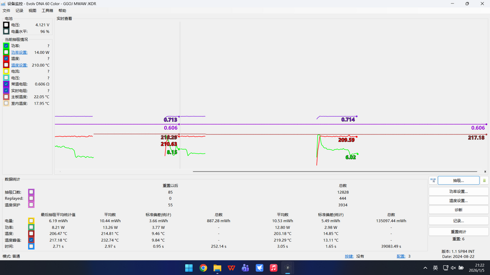

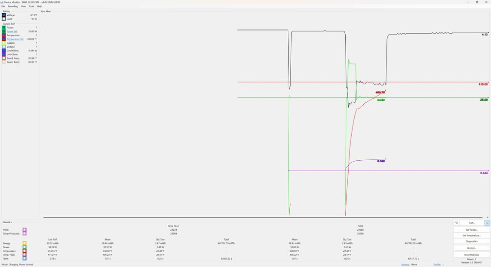

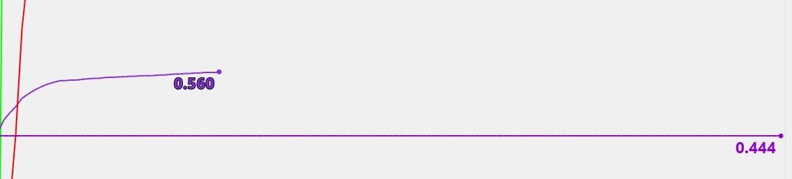

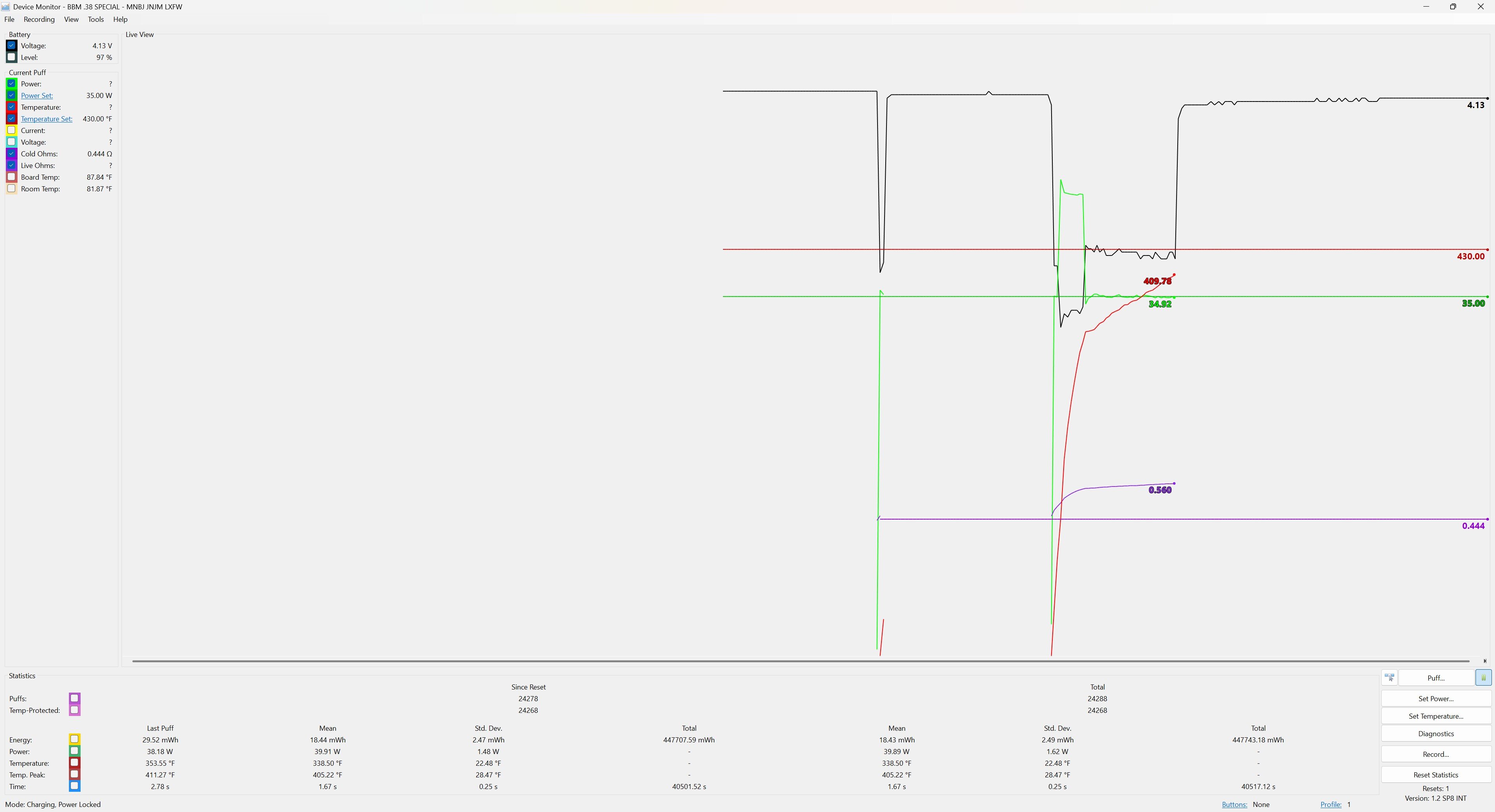

dwcraig1 Posted 7 hours ago Report Posted 7 hours ago I really need to see your Device Monitor showing cold ohms and live ohms when firing. Here is an image of mine, note that the live ohms on mine increase but then level out. The board determines temperature from the difference between the two readings. I suspect yours continues to climb till it hits temp setting.

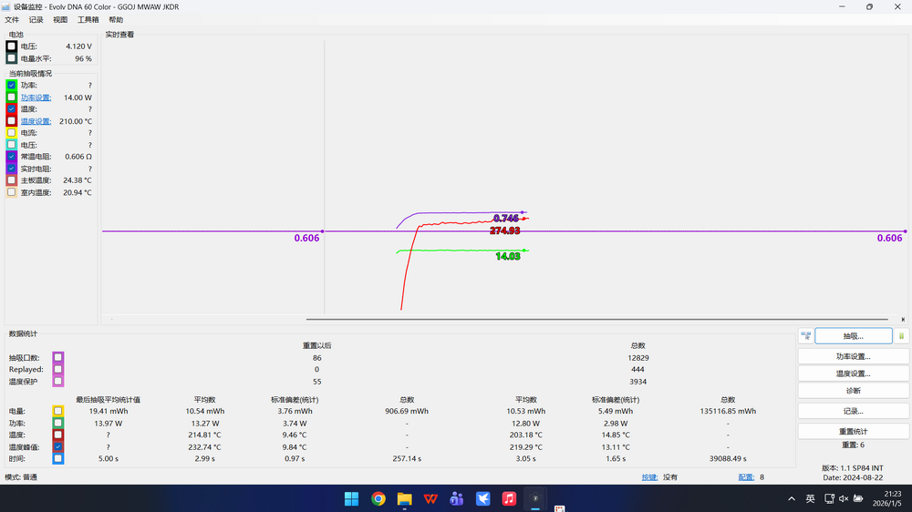

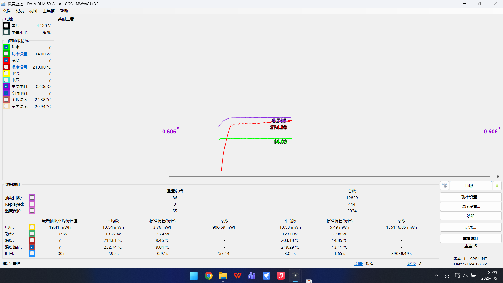

kzerwu Posted 4 hours ago Author Report Posted 4 hours ago 3 小时前, dwcraig1说: I really need to see your Device Monitor showing cold ohms and live ohms when firing. Here is an image of mine, note that the live ohms on mine increase but then level out. The board determines temperature from the difference between the two readings. I suspect yours continues to climb till it hits temp setting. First of all, I would like to thank you for your patient answer, but things seem to have improved. I have been using the default SS316 configuration file, but I am using SS316L coil. I downloaded a CSV configuration file of SS316L from the forum and used it, and the smoke generated seems to be normal. In theory, there shouldn't be such a big difference, after all, the TCR of these two materials is similar. This is my latest device monitor screenshot, and I am not sure if it is normal, but the smoke generated is indeed much higher. Also, it seems like I can't manually adjust the room temperature as it always shows a higher temperature
kzerwu Posted 4 hours ago Author Report Posted 4 hours ago 3 分钟前, kzerwu说: First of all, I would like to thank you for your patient answer, but things seem to have improved. I have been using the default SS316 configuration file, but I am using SS316L coil. I downloaded a CSV configuration file of SS316L from the forum and used it, and the smoke generated seems to be normal. In theory, there shouldn't be such a big difference, after all, the TCR of these two materials is similar. This is my latest device monitor screenshot, and I am not sure if it is normal, but the smoke generated is indeed much higher. Also, it seems like I can't manually adjust the room temperature as it always shows a higher temperature Sorry I didn't take it seriously. The temperature I set was 210, but it actually reached 270

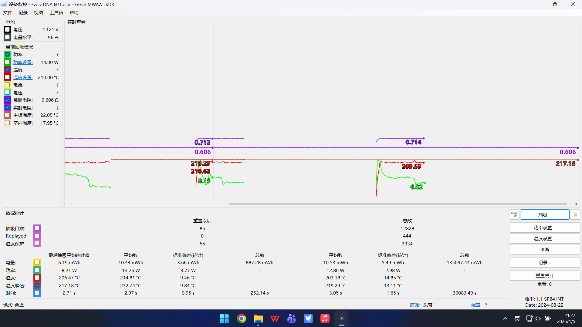

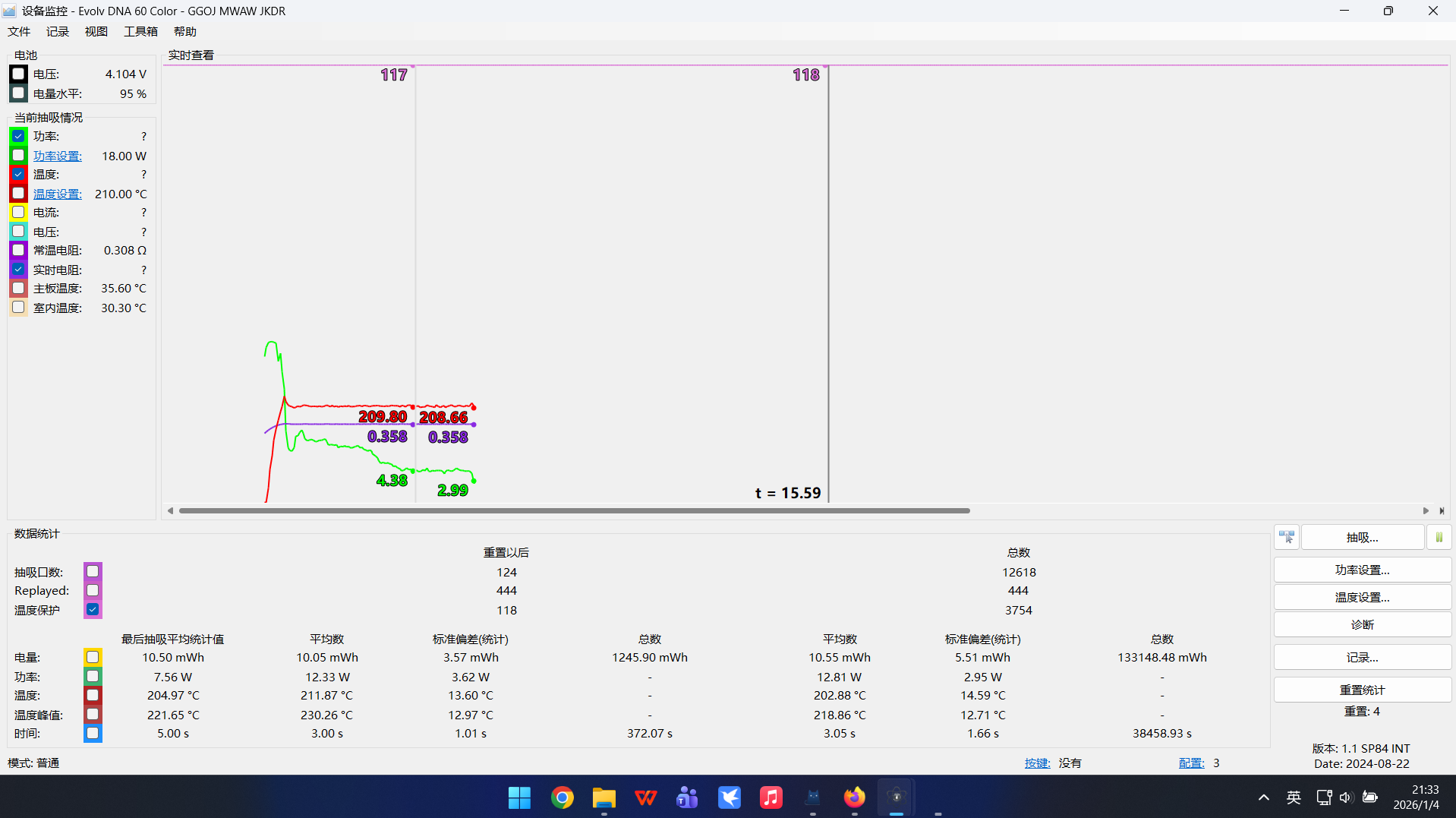

kzerwu Posted 4 hours ago Author Report Posted 4 hours ago This is the data when I use the default configuration file
dwcraig1 Posted 4 hours ago Report Posted 4 hours ago The TCR for 316 and 316L are so close that I consider them to be close enough to be called the same. Setting temp to 210 and getting 273 is puzzling to me.

kzerwu Posted 3 hours ago Author Report Posted 3 hours ago 31 分钟前, dwcraig1说: The TCR for 316 and 316L are so close that I consider them to be close enough to be called the same. Setting temp to 210 and getting 273 is puzzling to me. This is the data from my default configuration file, with a cold resistance of 0.296. According to TCR reverse calculation, the resistance when heated to 210 degrees is 0.346, which is perfect. However, just like the video I posted, it hardly produces smoke. So what's going on here? It's confusing
dwcraig1 Posted 2 hours ago Report Posted 2 hours ago Temp is hitting set temp almost immediately and throttling power down. There are quite a few variables involved here. Post screws not being tight enough is just one that we see often. 510 to 510 connections, ect. Your live resistance is most likely a false reading.
