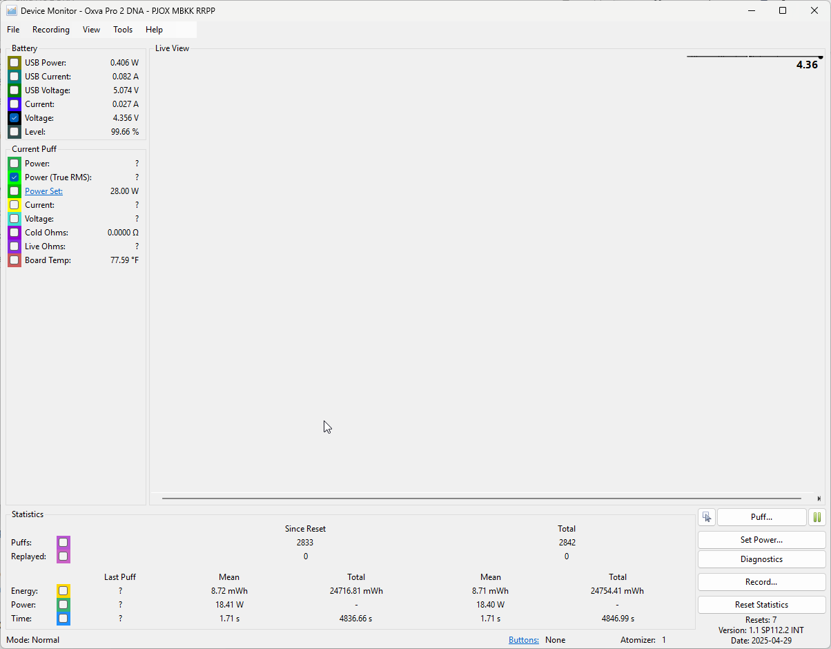

Simon Martin-Lemmon Posted Friday at 07:19 AM Author Report Posted Friday at 07:19 AM Thanks for the prompt reply @Wayneo This is what I have at the moment

James Bellinger Posted Friday at 01:42 PM Report Posted Friday at 01:42 PM Hello, Would you mind posting a screenshot of Device Monitor when taking a puff, or posting a recording CSV of the puff? I'd be interested to see what Power is doing, and what the Live Ohms are. Make sure to check those. You can click on the trace as it scrolls to get the values at a particular moment in time. Your screenshot also shows Cold Ohms as 0, which indicates it hasn't fired yet I assume. What do you measure for Cold Ohms for the coil? I'm curious to see what limit you are running into. Thanks! James
