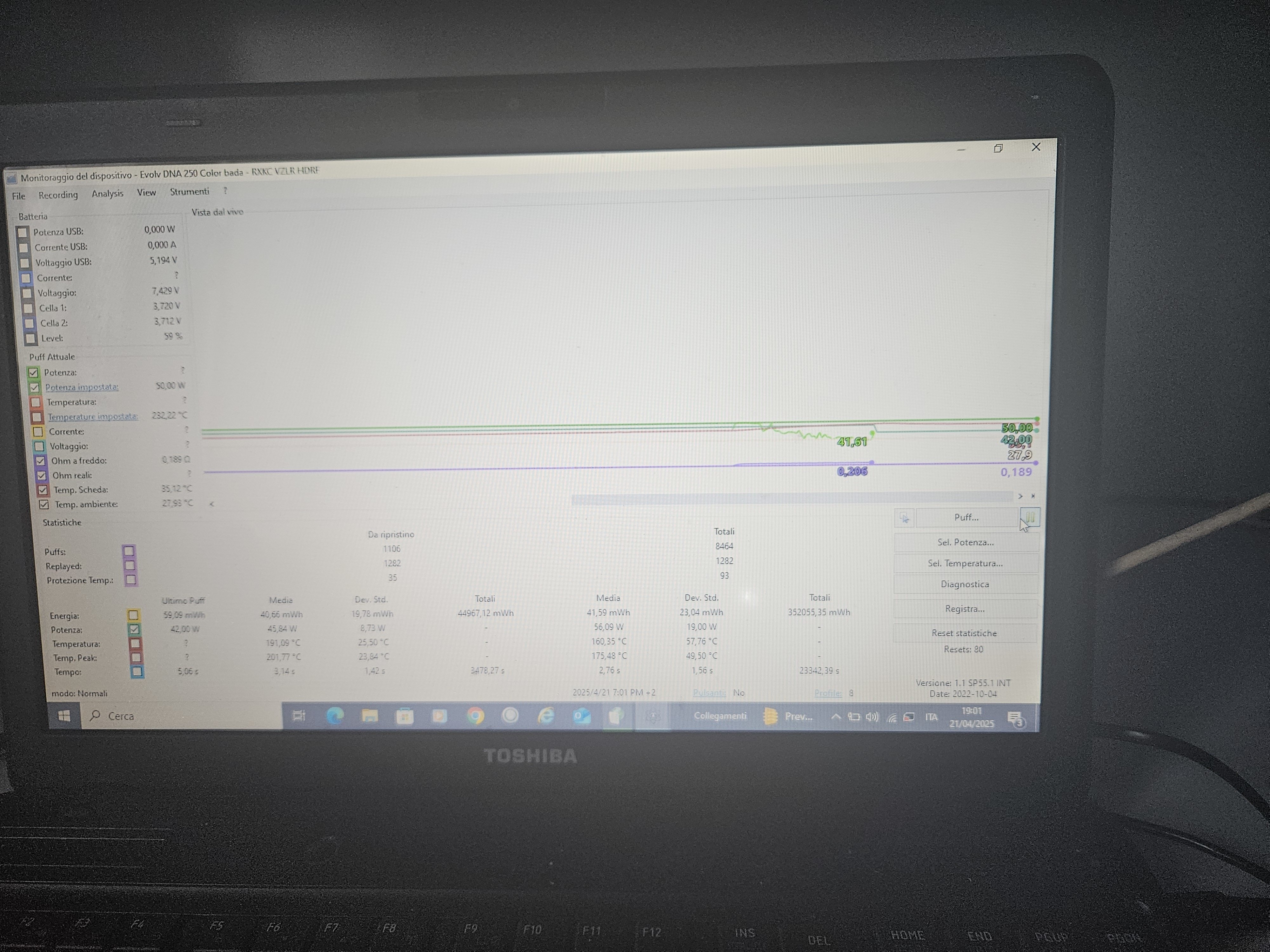

Nicola420 Posted April 21, 2025 Report Posted April 21, 2025 Ciao a tutti Volevo chiedervi un aiuto su un problema che magari è capitato anche a altre persone In pratica io ho una hadron plus dna250c e da poco ho scoperto la modalità Replay Ho come atomizzatore un profile x di wotofo con mesh ss316l e imposto la modalità Replay a 50w faccio un paio di tiri e salvo poi guardando il grafico vedo che i tiri successivi fatti in modalita replay sono scesi di potenza da 50 a 48 a 46 ecc Qualcuno potrebbe avere un idea? Grazie 😉

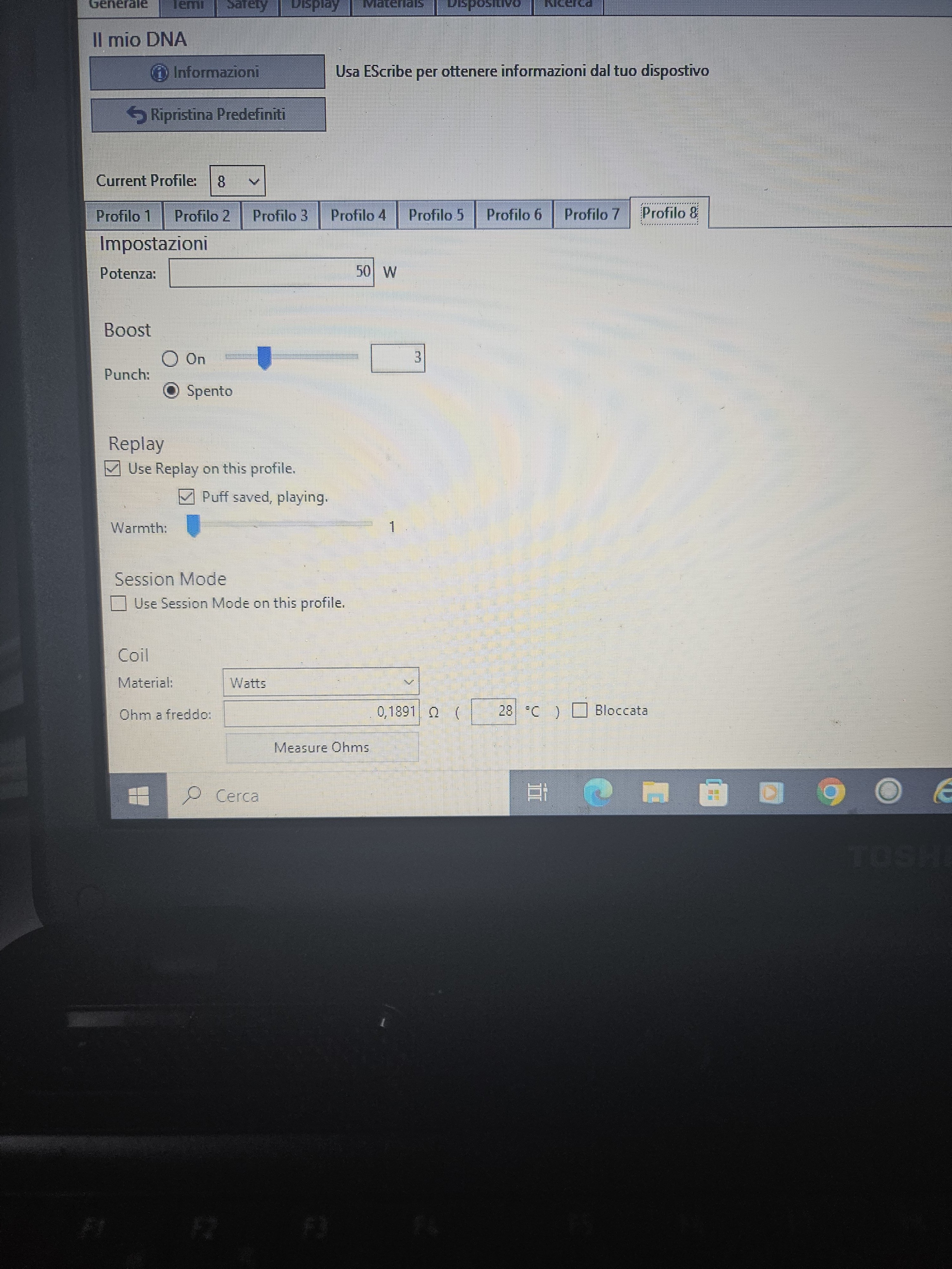

Wayneo Posted April 21, 2025 Report Posted April 21, 2025 @dwcraig was right when he said it could be your wicking, but post an escribe screenshot of the profile you are using. Bolded words have special meanings Screenshot instructions in my signature line ⬇️

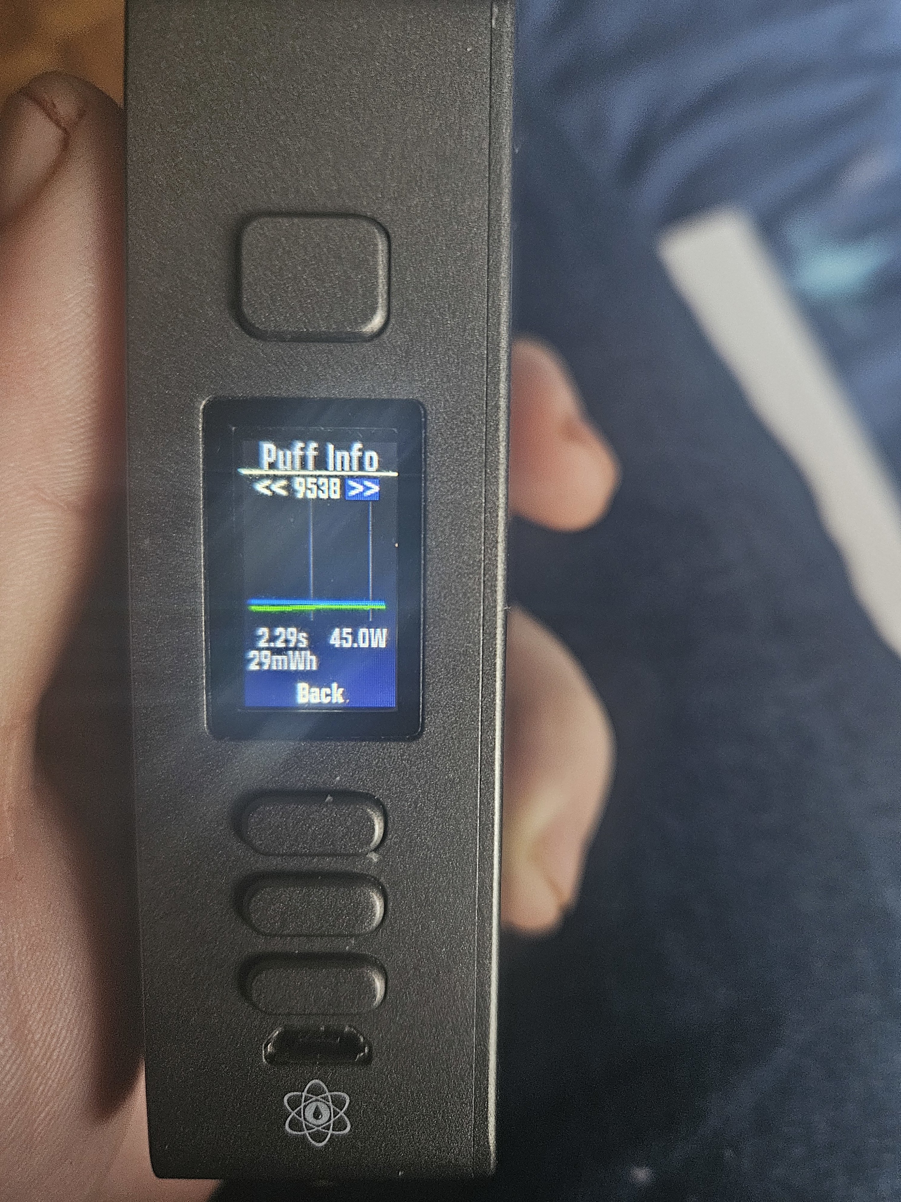

Nicola420 Posted April 21, 2025 Author Report Posted April 21, 2025 Prima di salvare il replay Dopo aver salvato il replay (45w) In questo momento di nuovo a 48 sempre con replay attivo...non capisco non vorrei fosse il circuito

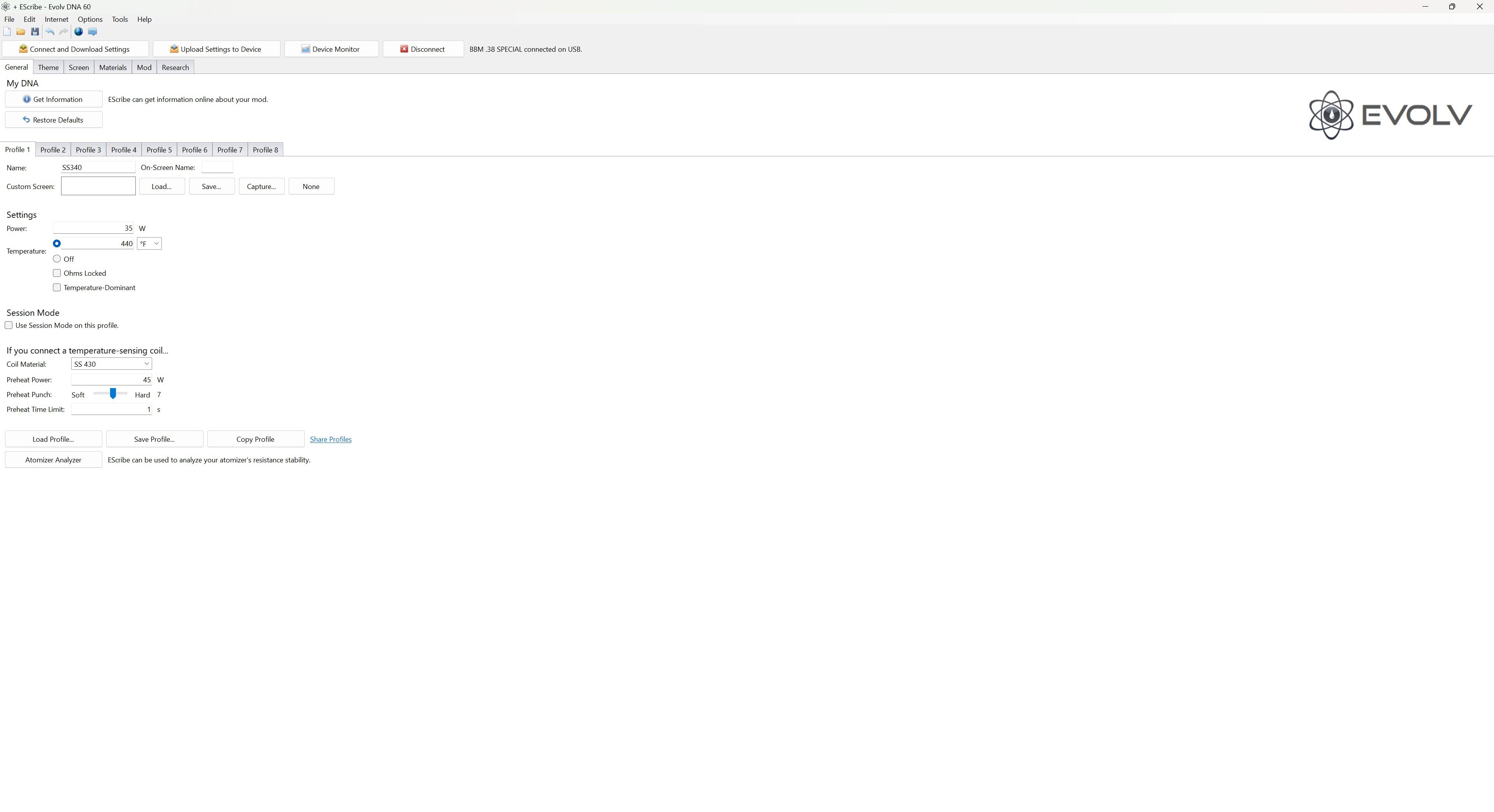

Wayneo Posted April 21, 2025 Report Posted April 21, 2025 8 minutes ago, Wayneo said: but post an escribe screenshot of the profile You need to plug into your PC, and start escribe. I need you to go into escribe (with mod plugged in) and do a full screenshot of the profile you're using. When you start escribe you'll see 'current profile' and a number. Click below on that number then do a screenshot.

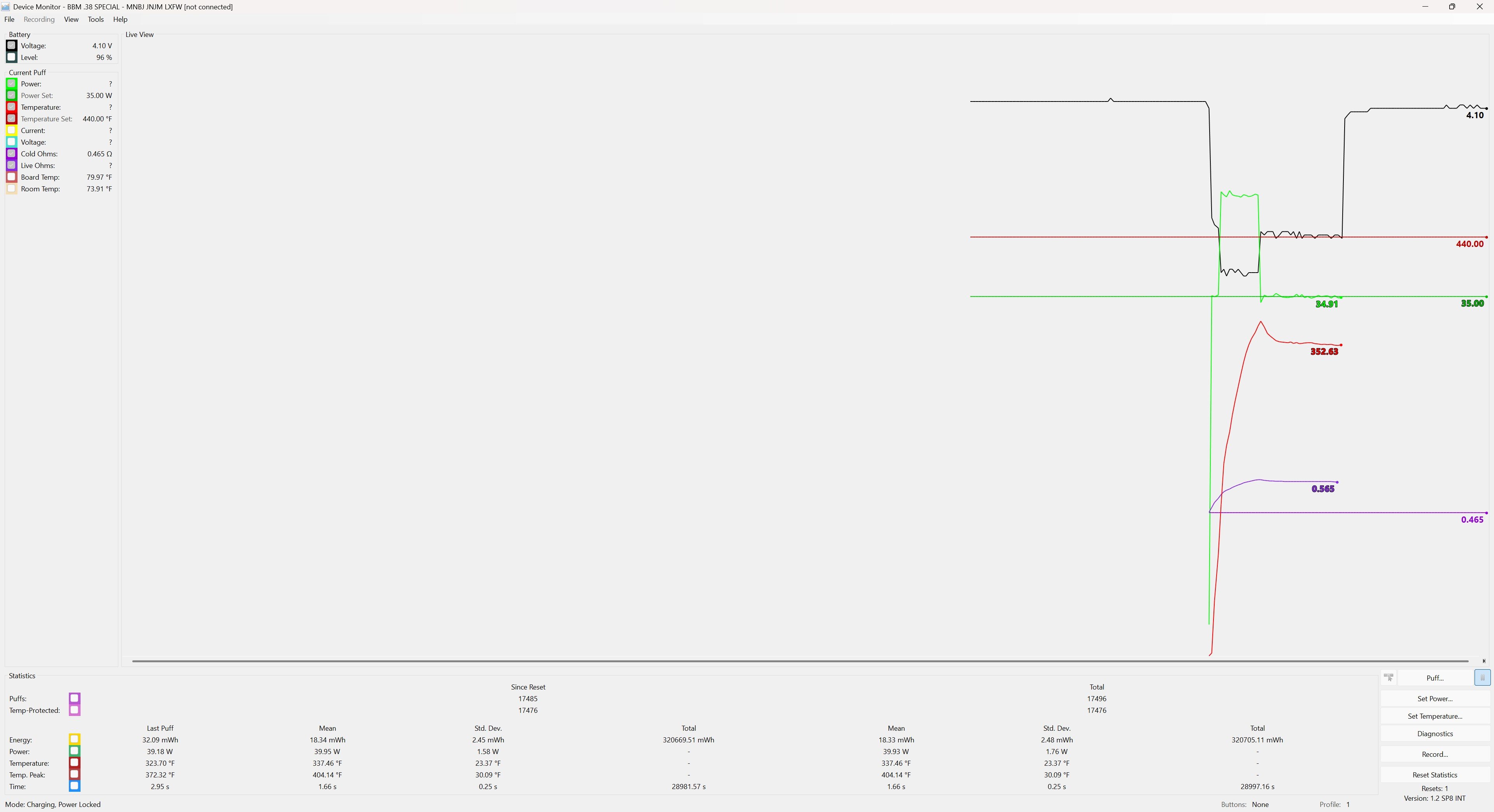

dwcraig1 Posted April 21, 2025 Report Posted April 21, 2025 Here are the screens we want to see, not the screen on the mod.
Wayneo Posted April 21, 2025 Report Posted April 21, 2025 I can't look at that. For the third time, look at dwcraig's S C R E E N S H O T
Wayneo Posted April 21, 2025 Report Posted April 21, 2025 Let me give you a general explanation based on what you have written. Replay wants to recreate the puff you saved. Your coil/mesh will raise its resistance when you fire it, and lower its resistance as it cools back to ambient temperature. When in your 'Replay' mode, but NOT enabled, the mod keeps track of that resistance curve created by your puff. And when you click 'Save Puff' your mod tries to recreate that curve. Sometimes exactly, or at lower wattages. Your mod 'right now' shows 'boost:Punch' at 3 (but not on), 'warmth' at 1. So right now you get no boost of watts initially, and it's just 50 watts. Once you click 'save puff' warmth now enters the picture. IF you were chain vaping your coil before enabling replay and your coil has cooled to ambient you will get even more watts than 50 but not too much. That's warmth. OR depending on different factors you definitely get less watts than what you initially set. Like if your coil is not as saturated as when you enabled replay. You can actually vape that mesh almost DRY without a dry burn. If you have any questions or want me to clarify anything let me know. Or if I have cleared up your understanding. 1
