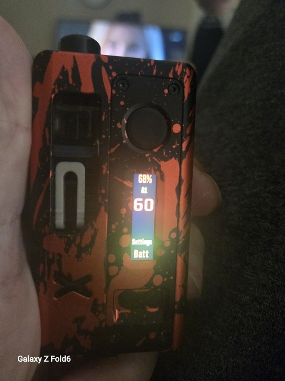

Brent626 Posted Monday at 12:36 AM Report Posted Monday at 12:36 AM (edited) So I recently bought a stubby 21700 and having battery issues. The batt symbol always shows unless a fully charged battery ,after slight use the batt symbol shows. My battery percentage is way off. There is no selection on escribe for 21700 ,only 18650 and poly are the only selectable ones. I have tried to analyze battery and never can because it always says usb disconnected when nothing is. It also doesn't show any stats as far as voltage ,current, live ohms and more on the display even while firing. I hope someone can help. Edited Monday at 01:05 AM by dwcraig1 needed
dwcraig1 Posted Monday at 01:20 AM Report Posted Monday at 01:20 AM The setting for 18650 is correct for a 21700. The difference between the settings is the Cell Soft Cutoff of which an 18650 and 21700 are the same. The items in Device Monitor with the ? mark fill out only when firing. As far as what's on your screen goes that is Theme dependent. You might save your theme and try another one. I recommend starting with Evolv's stock theme. Having all the boxes in Device Monitor checked is quite confusing. I edited your post as it needed it. 1
Wayneo Posted Monday at 01:37 AM Report Posted Monday at 01:37 AM You're seeing the 'batt' warning because you're hitting the 'low voltage' warning because the battery is sagging down to ~2.9v. Look at your Room vs. Board Temp at 150°F. A lot of heat is being generated internally trying to give you that 60watts. Isn't that the solder/wire free mod where everything is just screwed down? If it is, see if any are loose and can tighten them up. P.S Screenshot instructions in my signature line for the future. 1
