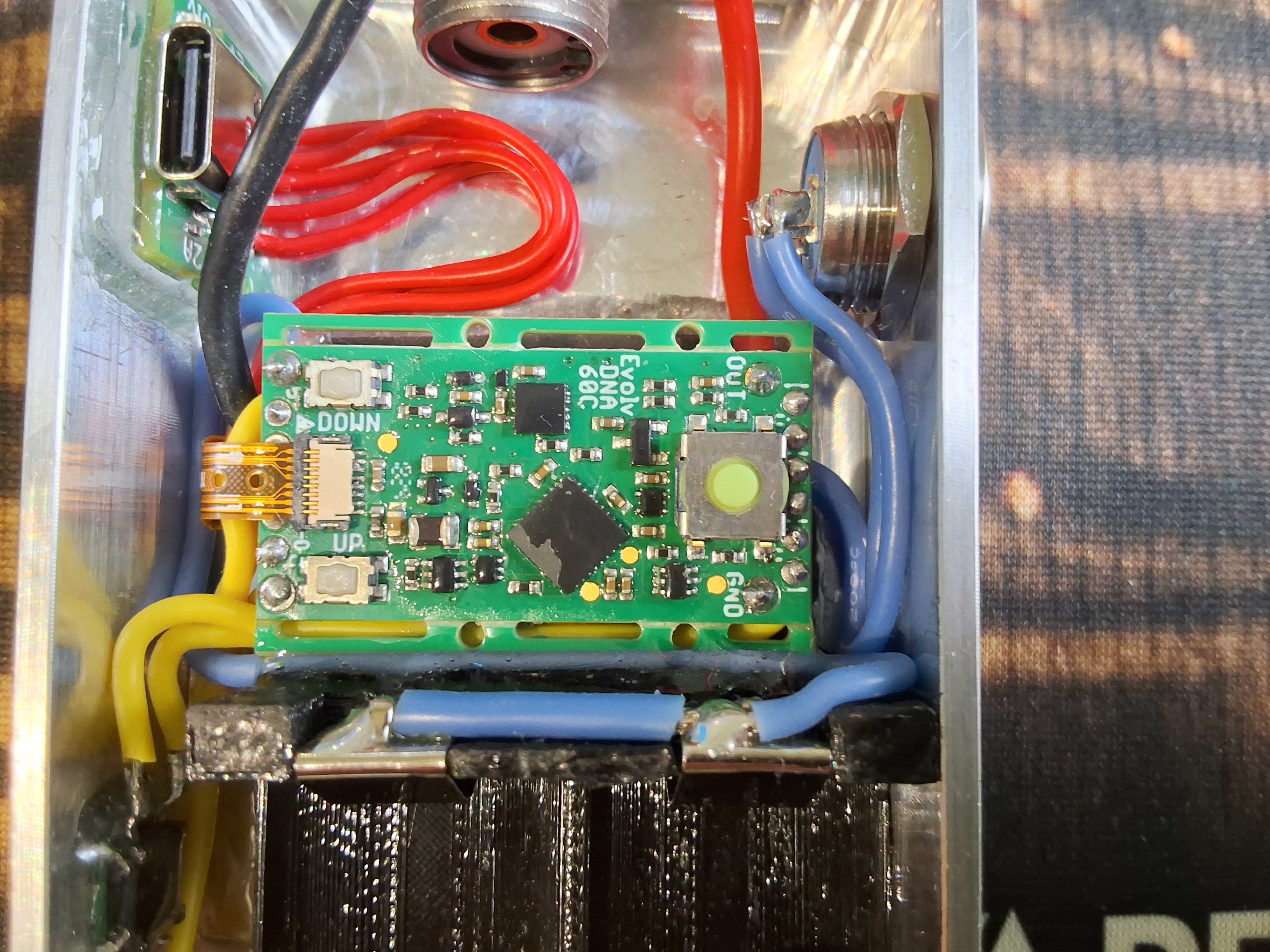

GrumpiTurnip Posted April 13 Report Posted April 13 Hi all I making my own mod have soldered everything where I believe it should be using a 2amp charging board for the dna60c, plugged it into escribe it detected the board then said no device connected. Have tried several USB cables but no difference, it connected one time started to up load the settings and stopped at 6% and wont go no further and escribe just has the spinning wheel I can't even Close escribe. I'm using windows 10, Any help would be appreciated as I am gutted was the last thing to do to complete the build. Have attached a pic below just incase someone can see something I've missed Cheers Si 1
Wayneo Posted April 13 Report Posted April 13 1 hour ago, Pigsy said: ...... it connected one time started to up load the settings and stopped at 6% and wont go no further and escribe just has the spinning wheel I can't even Close escribe. Restart your PC and escribe. Use the cable that worked. No image shown. Don't drag and drop, just choose and upload image (do not insert image). Is it the evolv USB-C board? 1
dwcraig1 Posted April 13 Report Posted April 13 It looks to be wired correctly to an Evolv C board. Avoid using a USB hub. 2

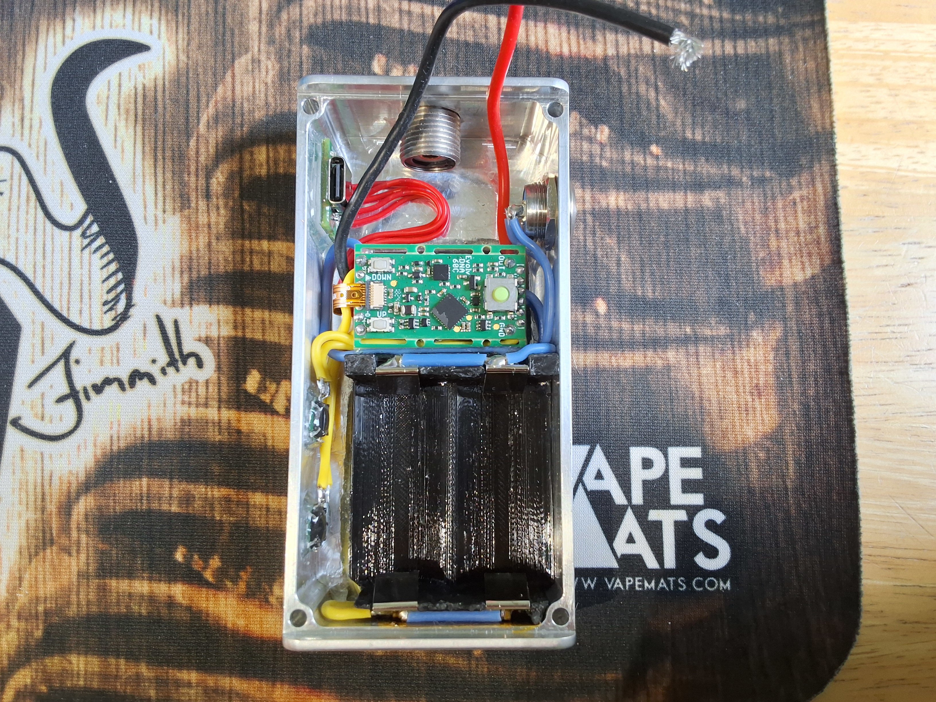

GrumpiTurnip Posted April 19 Author Report Posted April 19 Edit : So I've now mounted the board and type c board in place, I am running 2x18350 Batteries in parallel, plugged it into escribe and it will not recognise the board saying please connect a device 🤔 All I have left to connect is the 510 - and + with the batteries inserted i put a meter on the positive and negative and without pressing the fire button it's showing 3.2v when I press the fire button there is no change in the voltage. I have spent hours building the mod and searching the forum for an answer but to no avail, would anybody have any ideas or suggestions please I'm about to call it a day as it's eating into my long weekend off work. Have attached some pics...... Cheers Simon 1

Wayneo Posted April 19 Report Posted April 19 IMHO you've gotta meter out all your connections. For the USB-C you know it has worked outside the box. I'd lift that off and see if it connects, then lift at the board end if it still didn't connect. What else could it be? Same thing for the battery. Using 1 battery, measure it externally then in each slot at all the connection points to the board. Then do the other battery slot. Same thing for the fire button and up/down. 1
dwcraig1 Posted April 19 Report Posted April 19 The situation where you have 3.2 volts between output and ground is troubling. This is something that I have no experience with so I measured the voltage between output and ground on two of my DNA60s and my one DNA60C, all three read about the same, just over 0.7 volts. And no change if fire button pressed. 1
GrumpiTurnip Posted April 19 Author Report Posted April 19 14 minutes ago, Wayneo said: IMHO you've gotta meter out all your connections. For the USB-C you know it has worked outside the box. I'd lift that off and see if it connects, then lift at the board end if it still didn't connect. What else could it be? Same thing for the battery. Using 1 battery, measure it externally then in each slot at all the connection points to the board. Then do the other battery slot. Same thing for the fire button and up/down. 10 minutes ago, dwcraig1 said: The situation where you have 3.2 volts between output and ground is troubling. This is something that I have no experience with so I measured the voltage between output and ground on two of my DNA60s and my one DNA60C, all three read about the same, just over 0.7 volts. And no change if fire button pressed. yes something is wrong somewhere, ive just soldered the 510 when checking with a meter earth and 510 pin no fire button pressed im getting voltage of 3.2v then press the fire button and no change, Ok it looks like im gonna have to pull it all out and see whats happening, Hopefully i notice something this has totally baffelled me. Thankyou both @dwcraig1 @Wayneo for your time and patience i will start testing connection when i get a bit more time and hopefully have a good outcome 2
