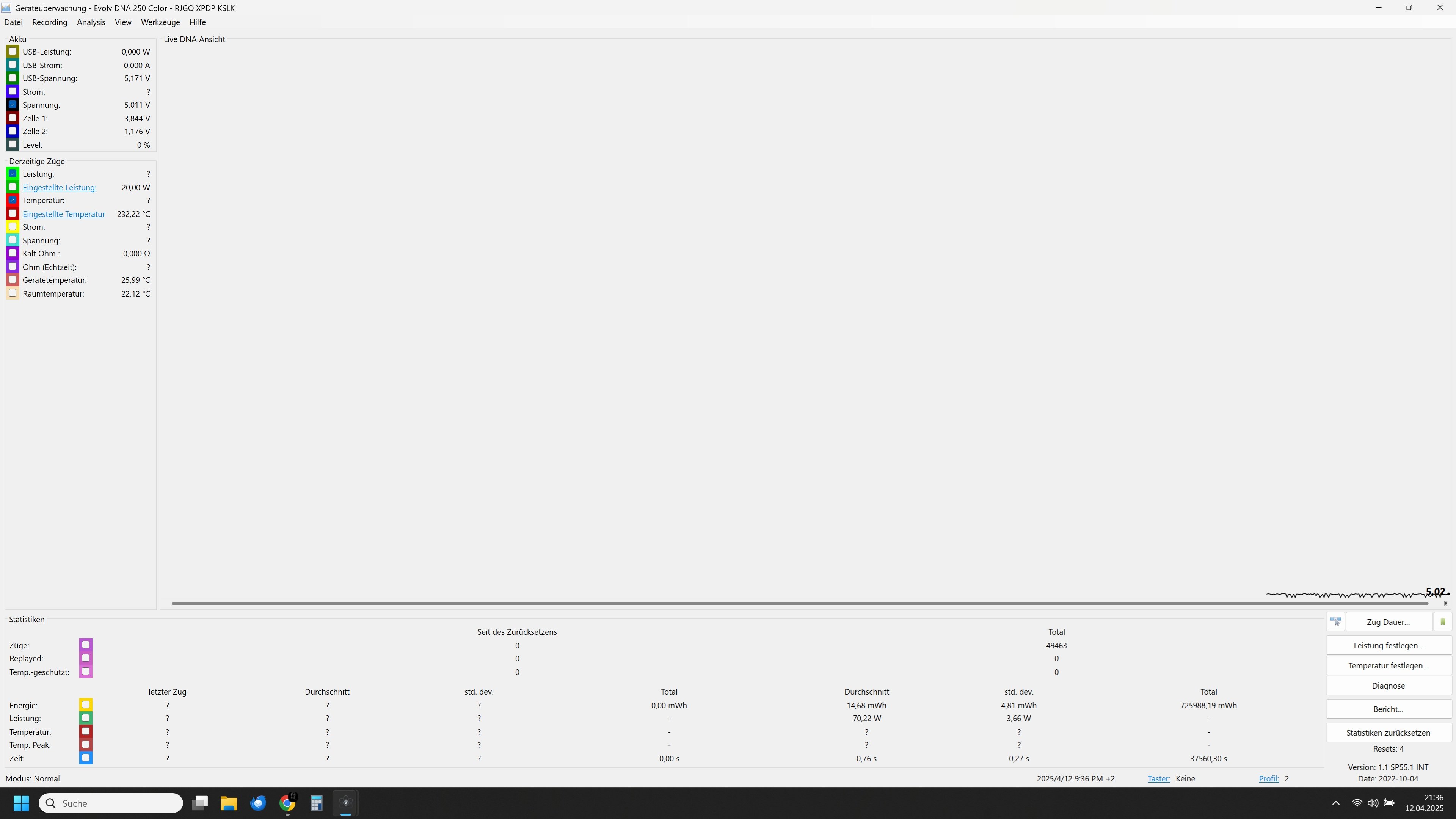

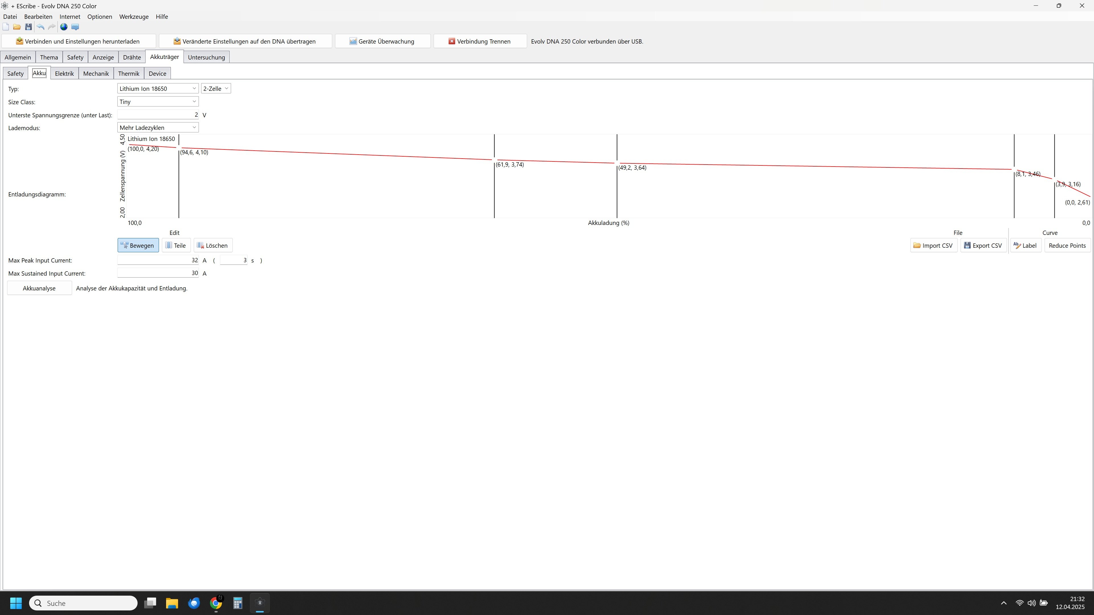

Wayneo Posted Saturday at 07:03 PM Report Posted Saturday at 07:03 PM Did you ever click 'Restore Defaults' in escribe? I need you to go into escribe (with mod plugged in), then start 'Device Monitor' and do a full screenshot. No need to take a puff.
n82freak Posted Saturday at 07:04 PM Author Report Posted Saturday at 07:04 PM Gerade eben schrieb Wayneo: Did you ever click 'Restore Defaults' in escribe? I need you to go into escribe (with mod plugged in), then start 'Device Monitor' and do a full screenshot. No need to take a puff. Yes. Before i installed the actual firmware, i do a complete reset.
Wayneo Posted Saturday at 07:08 PM Report Posted Saturday at 07:08 PM OK, then also (in escribe) click 'mod' -> 'battery' and do another full screenshot
n82freak Posted Saturday at 07:33 PM Author Report Posted Saturday at 07:33 PM (edited) vor 26 Minuten schrieb Wayneo: OK, then also (in escribe) click 'mod' -> 'battery' and do another full screenshot Ok. Here some Screenshots. Edited Saturday at 07:37 PM by n82freak

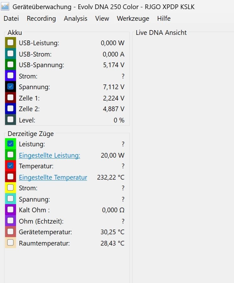

Wayneo Posted Saturday at 08:19 PM Report Posted Saturday at 08:19 PM Thank you. There's all sorts going on there. You need to change your battery specs back to normal. For 'size class' that should be back at 'normal', and 'cell soft cutoff' 2.75 volts. Then 'upload settings to mod' From 'Device Monitor', look at your 'cell 2' it's showing 1.1v. That is the problem. Unplug mod, physically swap your battery positions in the mod. Plug mod back in restart esribe -> device monitor. If cell 2 still shows a low voltage it is your mod wiring or connection. If cell 1 is now low it is a dead battery. 1
n82freak Posted Saturday at 08:27 PM Author Report Posted Saturday at 08:27 PM vor 1 Minute schrieb Wayneo: Thank you. There's all sorts going on there. You need to change your battery specs back to normal. For 'size class' that should be back at 'normal', and 'cell soft cutoff' 2.75 volts. Then 'upload settings to mod' From 'Device Monitor', look at your 'cell 2' it's showing 1.1v. That is the problem. Unplug mod, physically swap your battery positions in the mod. Plug mod back in restart esribe -> device monitor. If cell 2 still shows a low voltage it is your mod wiring or connection. If cell 1 is now low it is a dead battery. Thanks. Yes. It is not the battery. If swap them, always Cell2 shows smaller voltage. So we know the Battery is Ok and there is a Problem by wiring or bord. I check all cables. There is nothing wrong. Is it possible that the bord have defects? What can i do to find out?
Wayneo Posted Saturday at 08:39 PM Report Posted Saturday at 08:39 PM Definitely not a bug, not a board problem. Wiring or connector problem. Do you have a multimeter? I have never seen the innards of a Riva, but you could check the voltage shown for cell 2, and what the board sees. 1

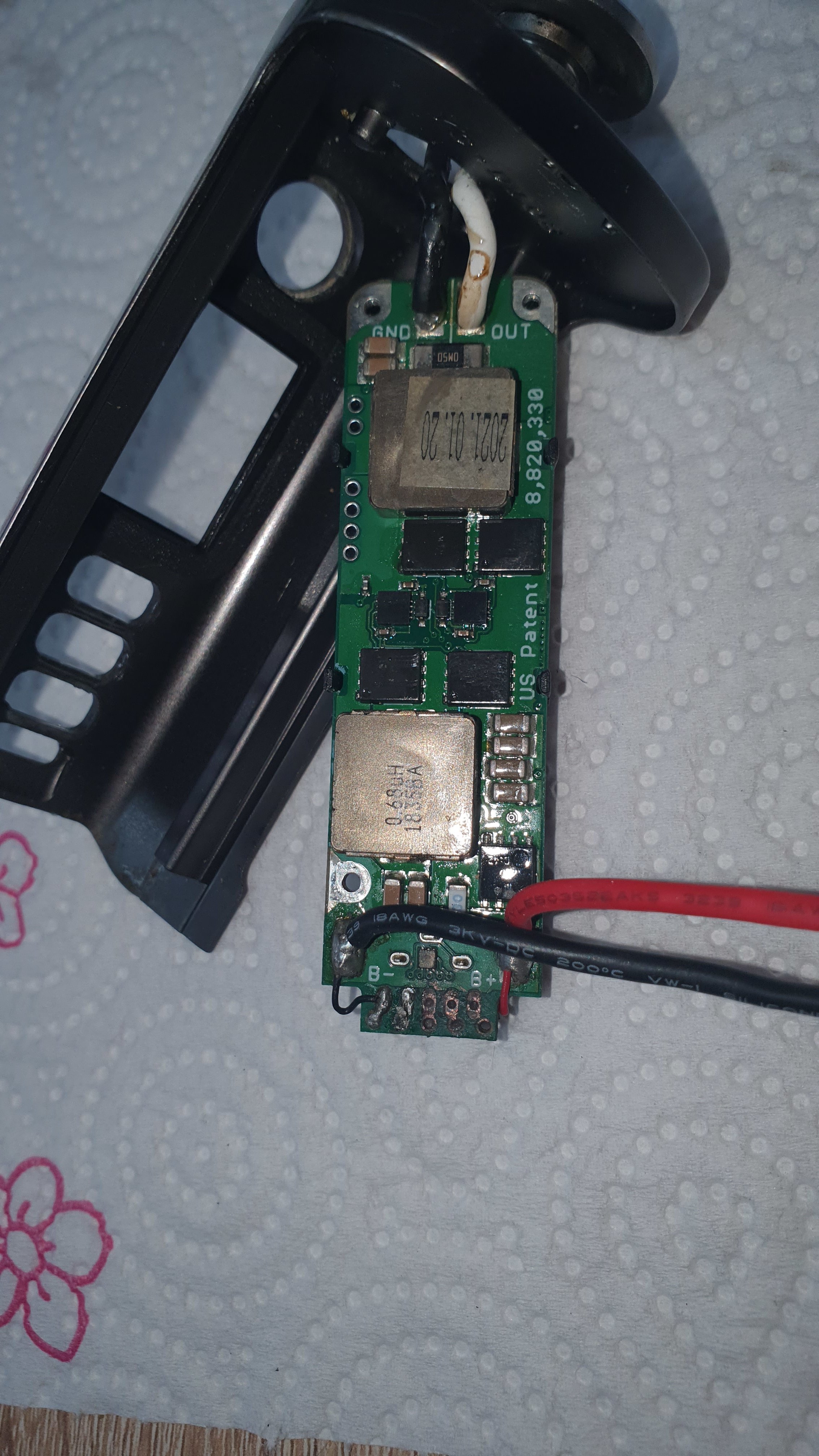

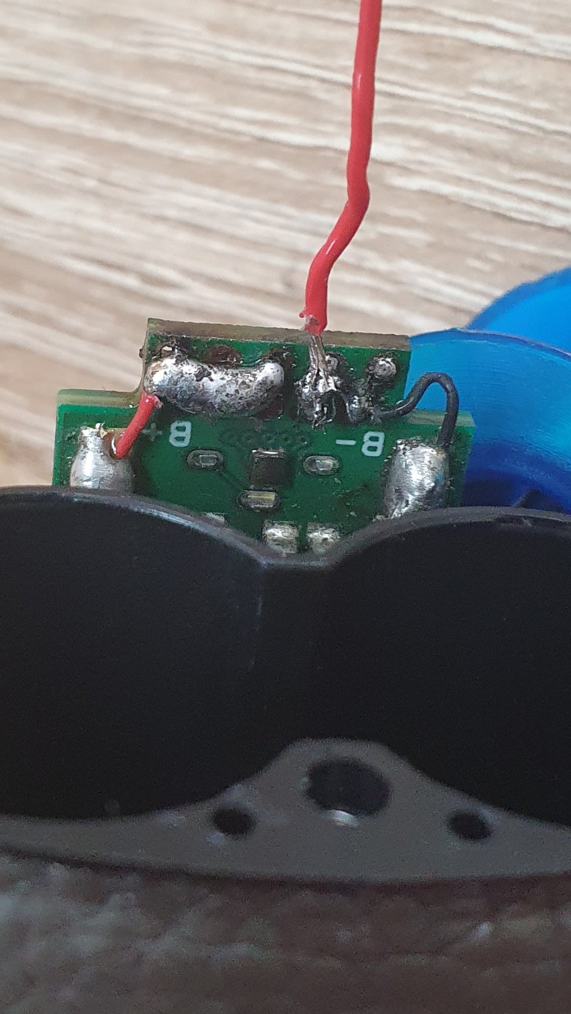

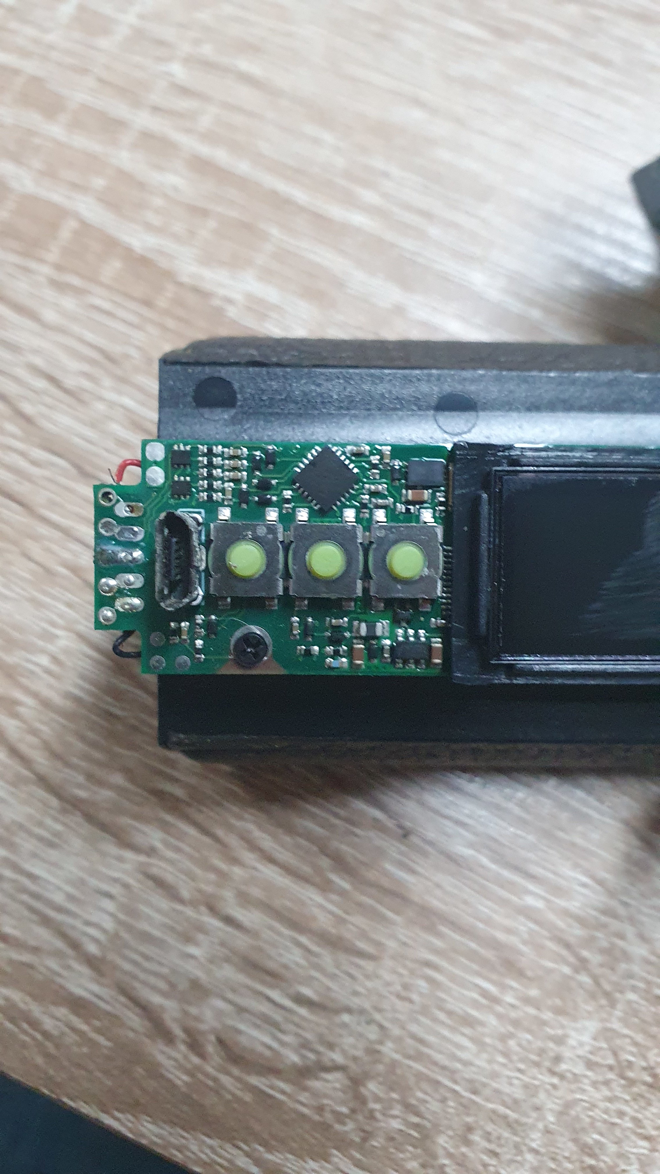

Wayneo Posted Saturday at 08:51 PM Report Posted Saturday at 08:51 PM The bottom of the board has like a little longer section. Is there a white (JST) connector there, or are there some thin wires directly attached to the board? Just a photo or 2 of that area would be good. 1

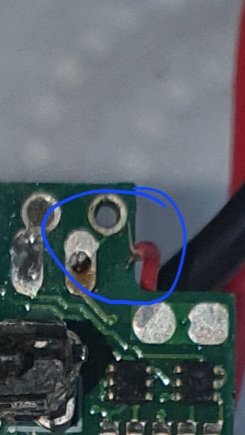

n82freak Posted Sunday at 08:32 AM Author Report Posted Sunday at 08:32 AM (edited) vor 12 Stunden schrieb Wayneo: The bottom of the board has like a little longer section. Is there a white (JST) connector there, or are there some thin wires directly attached to the board? Just a photo or 2 of that area would be good. I am not shure but i think i found the "bug"! There is a little red cable wich have no contact to the board. I think it should go the first pin at the same side. I solved the cable. But the board show the same wrong mesurement as before. I dont know what to do. Now i think the board is broken. Edited Sunday at 08:58 AM by n82freak

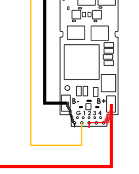

dwcraig1 Posted Sunday at 11:04 AM Report Posted Sunday at 11:04 AM Either with wire or solder bridge. G and B- need to be bridged together. Then 2,3, 4 and B+ need to be bridged together. The yellow is cell #1 positive.
n82freak Posted yesterday at 11:21 AM Author Report Posted yesterday at 11:21 AM (edited) Am 13.4.2025 um 13:04 schrieb dwcraig1: Either with wire or solder bridge. G and B- need to be bridged together. Then 2,3, 4 and B+ need to be bridged together. The yellow is cell #1 positive. Hi.. i sold it like your picture. Now intern at the Diagnosticscreen from Vape it shows 7.2 Volts but at normal screen it shows 4% and check batteries. Edited yesterday at 11:30 AM by n82freak
Wayneo Posted yesterday at 03:42 PM Report Posted yesterday at 03:42 PM On 4/12/2025 at 4:19 PM, Wayneo said: From 'Device Monitor', look at your 'cell 2' it's showing 1.1v. That is the problem. ............... DO YOU SEE ME POST %'s IN MY POSTS? Now look at your cells. You really need to redo that soldering or clean it up so solder is only each pad from ground, pin 1, and pin2. I'll tell you from now, if I see a single % in anymore of your posts, someone else can help you.
n82freak Posted 23 hours ago Author Report Posted 23 hours ago vor 59 Minuten schrieb Wayneo: DO YOU SEE ME POST %'s IN MY POSTS? Now look at your cells. You really need to redo that soldering or clean it up so solder is only each pad from ground, pin 1, and pin2. I'll tell you from now, if I see a single % in anymore of your posts, someone else can help you. Should the red line only going to pin 2 or should it bridged with pin 3 + 4? I interpret the circuit diagram that red is bridged with pin 2 + 3 + 4 And yellow with pin 1 and black goes to gnd.
Wayneo Posted 22 hours ago Report Posted 22 hours ago B- and G ground is cell 1 negative. Pin 1 is cell 1 positive and cell 2 negative. Yes, Pin 2 is cell 2 positive and needs to be bridged to 2-4 plus B+ like you have. But you need to clean it up. I also worry about all that exposed wire on the red. When you're done, use your multimeter and measure Ground + Pin1 (cell 1 voltage), then Pin1 + Pin2 (cell 2 voltage). 1

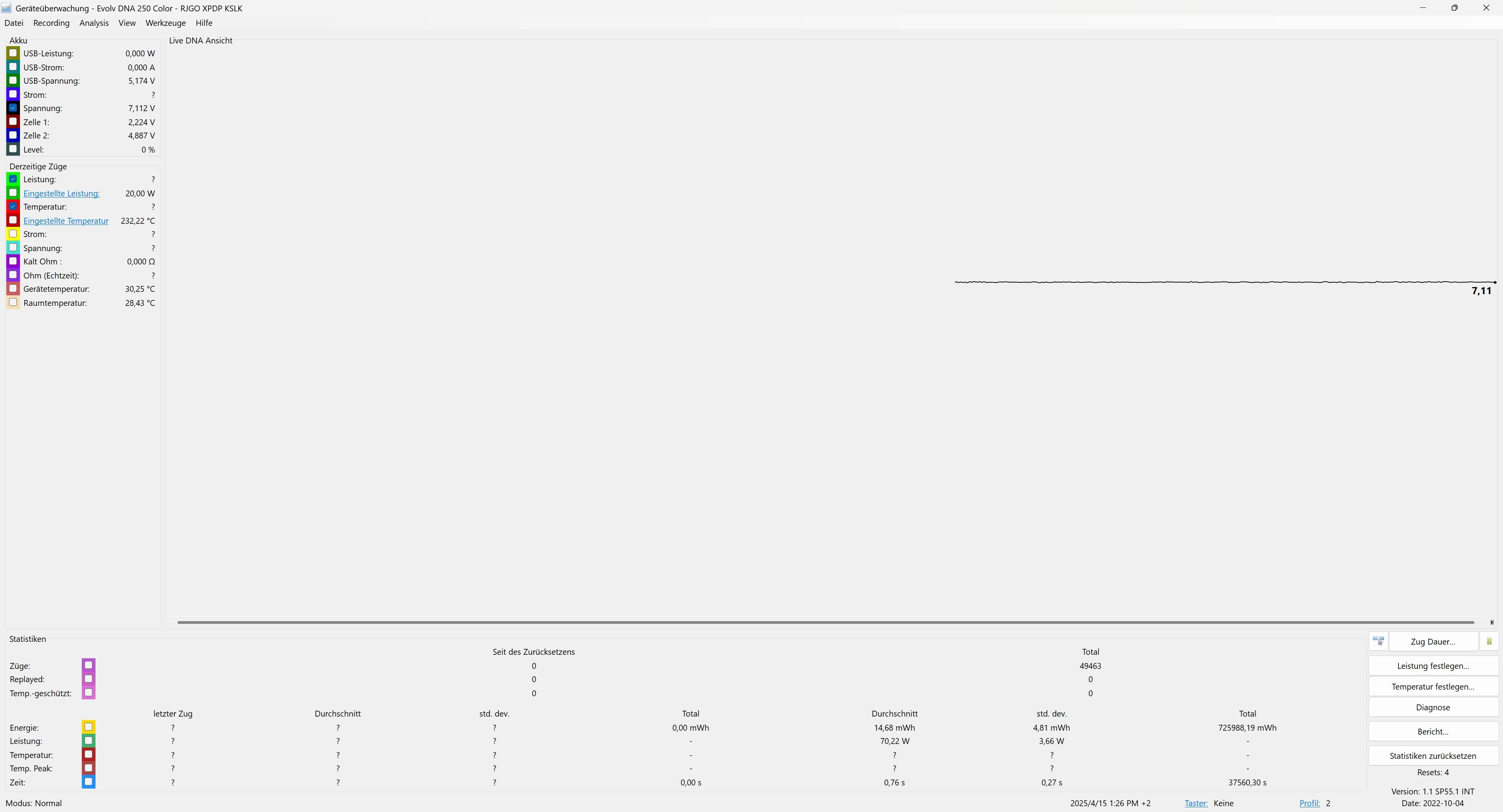

n82freak Posted 21 hours ago Author Report Posted 21 hours ago vor 32 Minuten schrieb Wayneo: B- and G ground is cell 1 negative. Pin 1 is cell 1 positive and cell 2 negative. Yes, Pin 2 is cell 2 positive and needs to be bridged to 2-4 plus B+ like you have. But you need to clean it up. I also worry about all that exposed wire on the red. When you're done, use your multimeter and measure Ground + Pin1 (cell 1 voltage), then Pin1 + Pin2 (cell 2 voltage). Cell 1 - 4.18V Cell 2 - 4,19V Cell 1 + 2 - 8,38V But in eScribe it shows complete wrong Volts.
Wayneo Posted 20 hours ago Report Posted 20 hours ago I'm too tired to guess what Device Monitor shows
n82freak Posted 19 hours ago Author Report Posted 19 hours ago vor einer Stunde schrieb Wayneo: I'm too tired to guess what Device Monitor shows
Wayneo Posted 18 hours ago Report Posted 18 hours ago Well, if that was after i said 3 hours ago, n82freak said: But you need to clean it up. I also worry about all that exposed wire on the red. When you're done, use your multimeter then open a Help Desk ticket. ⬇️ Link in my signature line. ⬇️
