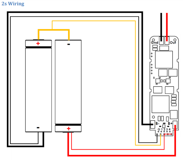

Wayneo Posted February 2, 2025 Report Posted February 2, 2025 Hope you have a voltage meter. If they're both at 4.2V then you need to check and clean all the connections. Both the XT30/60 and the balance cable connector ends starting at the battery side. IIRC pin 0 (-)&1(+) would be cell 1, pin 1 (-) @2 (+) would be cell 2. Each should show 4.2V PIN 0, on the board is the tiny hole at the left when you're seeing the 2 inductors (or no visible buttons). This diagram is for the 250, you would not have pin 4 The photo below the diagram actually shows a DNA200, face/buttons up 1
