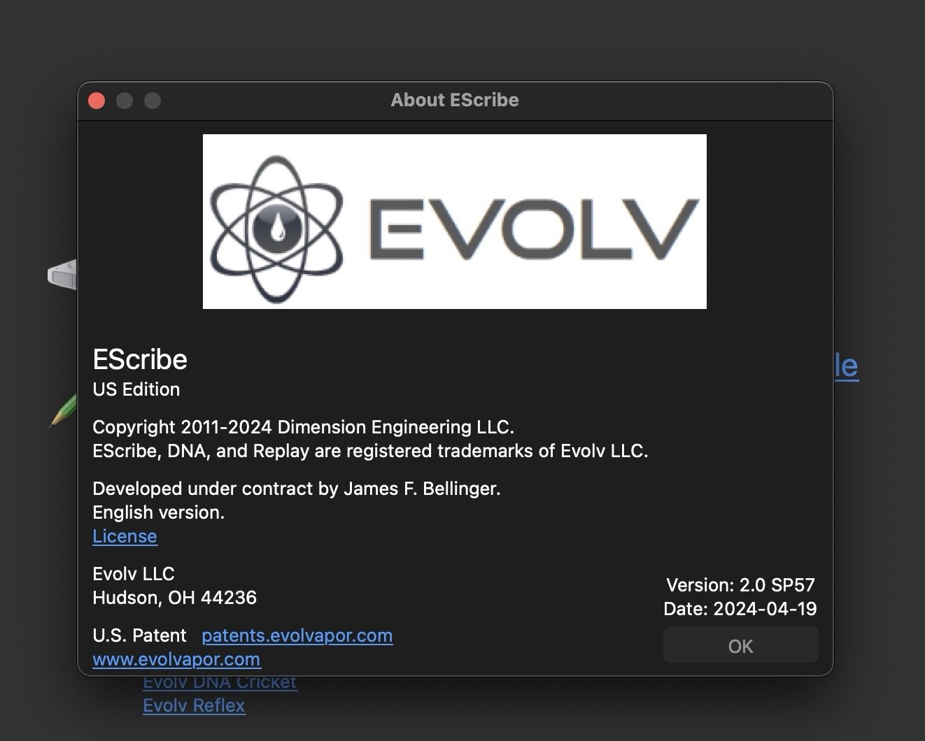

Wayneo Posted February 1 Report Posted February 1 Start escribe, click 'about escribe', post screenshot.
Dizzard Posted February 1 Report Posted February 1 Not to sound like a stupid question, but have you updated escribe?
Conanthewarrior Posted February 1 Author Report Posted February 1 32 minutes ago, Wayneo said: Start escribe, click 'about escribe', post screenshot. Here is what you said to do, I hope it helps
Conanthewarrior Posted February 1 Author Report Posted February 1 I tried downloading and installing Escribe from Evolv's website, but still end up with the same version and date? Is this the latest release?

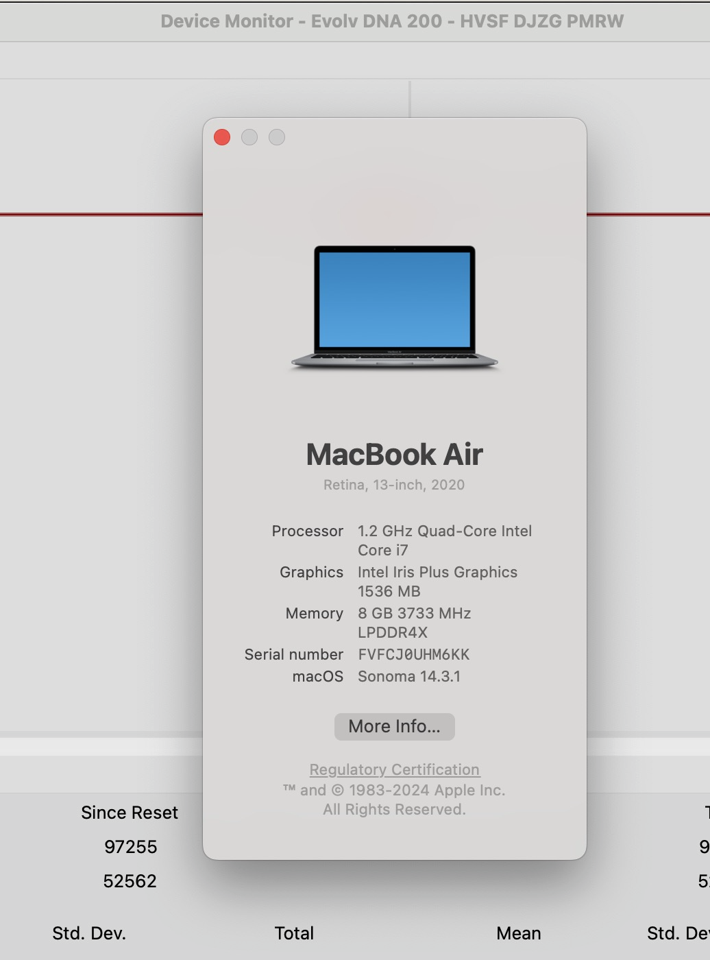

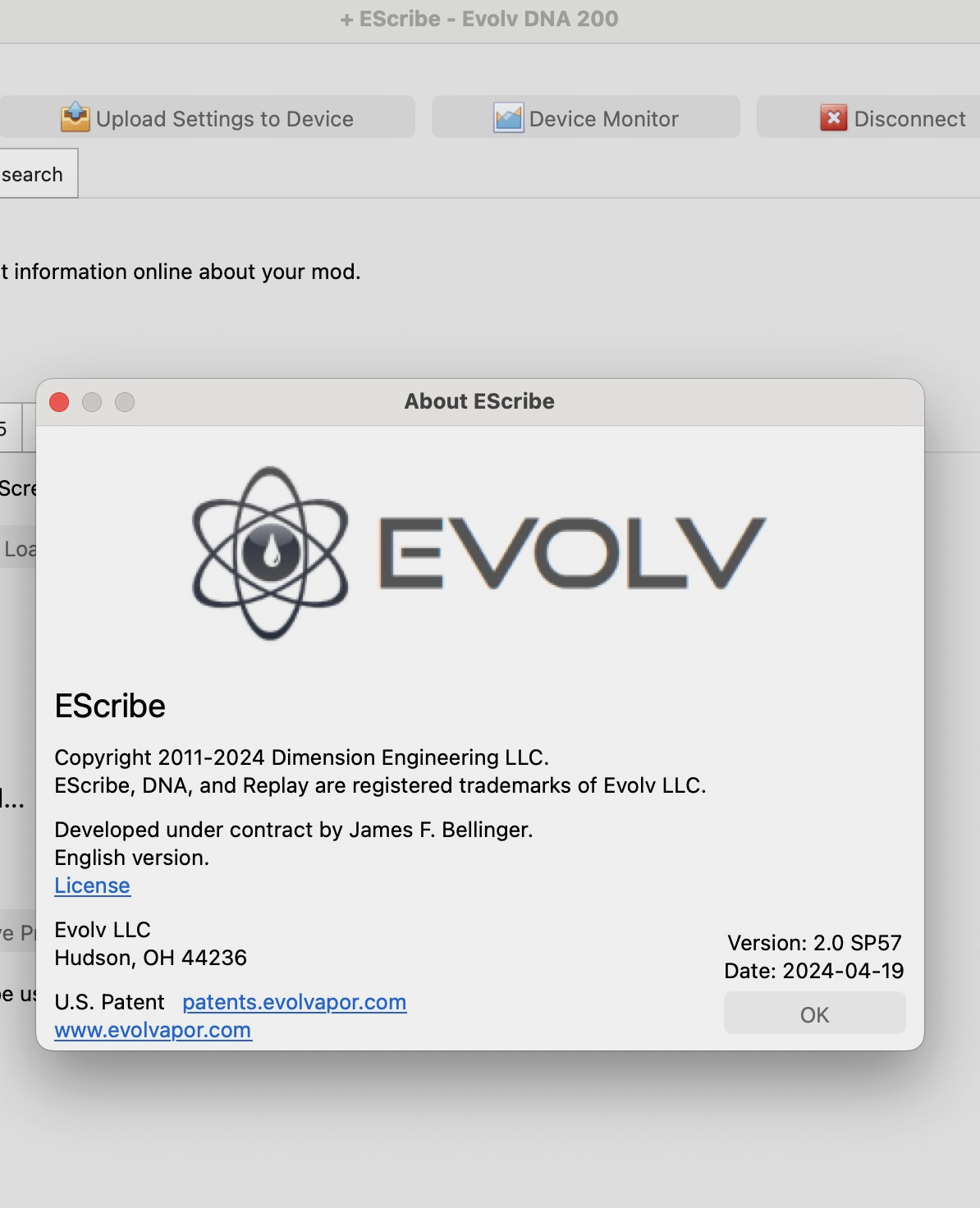

Wayneo Posted February 1 Report Posted February 1 Yes, that's the latest. I just tested both a 75 & 200 on my M1 Air and both worked. It was the only thing plugged into my hub. Perhaps try different cables.
