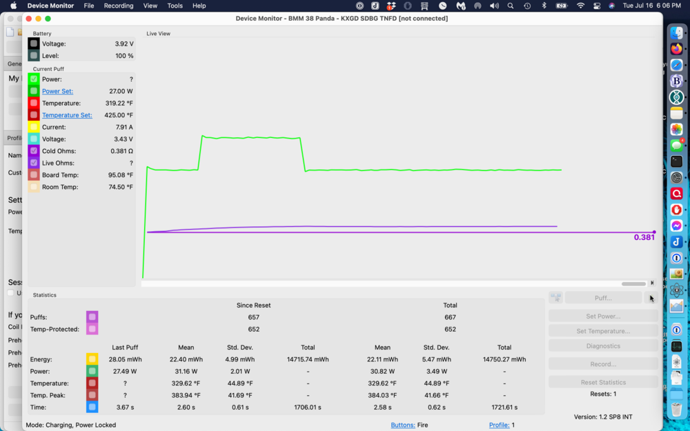

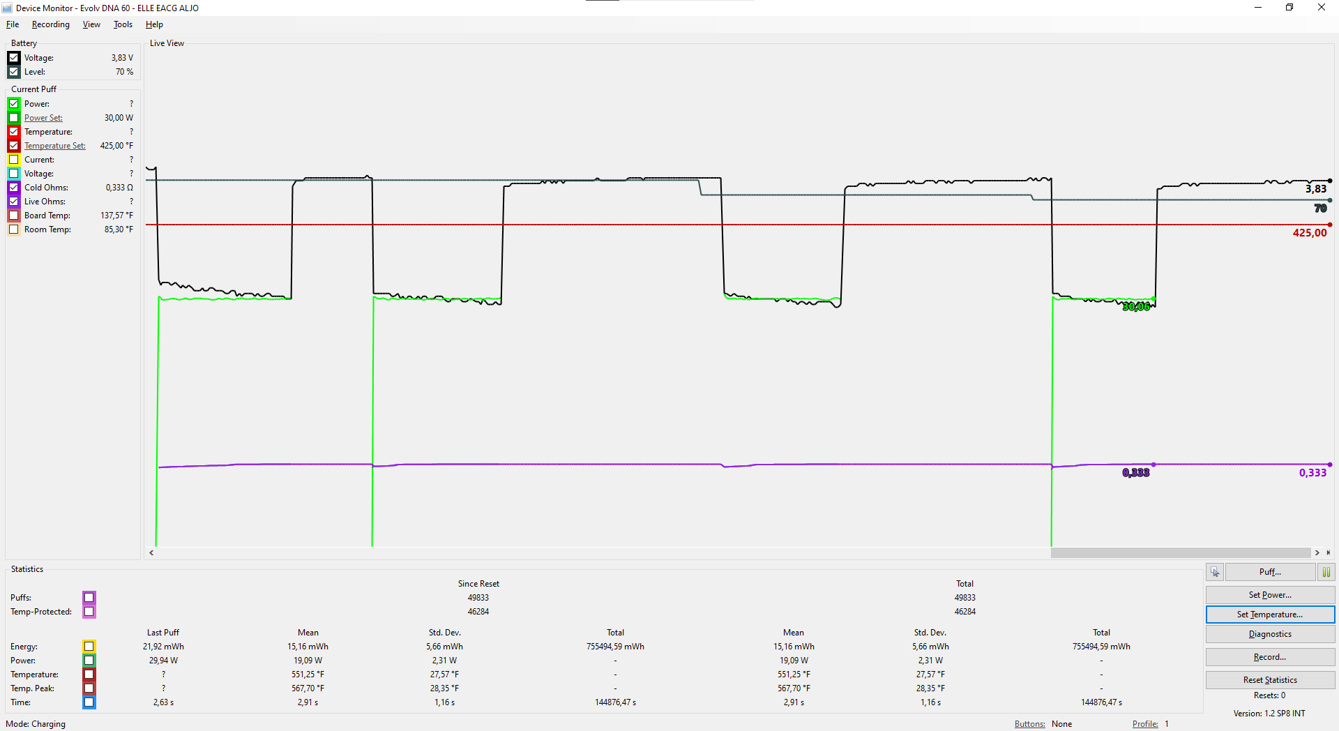

moa285 Posted July 16, 2024 Report Posted July 16, 2024 Hi everyone, I'm having an issue with my SKNKWORX - DotAIO D-01 and the new revision of Dotmod DotCoil - 0.3 ohm coils. Recently, Dotmod introduced a revised version of their DotCoil, which supposedly has better sealing or something along those lines. However, I've run into a problem: temperature control doesn't work with these new coils. According to the inscription on the coil, it's made of the same material as the previous version, but Escribe software detects it as Kanthal, which doesn't support temperature control. Has anyone else experienced this issue? Any advice on how to fix this would be greatly appreciated! Thanks in advance!
Wayneo Posted July 16, 2024 Report Posted July 16, 2024 1 hour ago, moa285 said: According to the inscription on the coil, it's made of the same material as the previous version And what would that be? 1 hour ago, moa285 said: but Escribe software detects it as Kanthal, which doesn't support temperature control. No DNA mod detects material type at all. YOU have to change that. If you post a full 'device monitor' screenshot, showing 'cold ohms' and 'live ohms' during a puff it would be more helpful. EDIT: Click/enable 'cold ohms' and 'live ohms' for them to show.

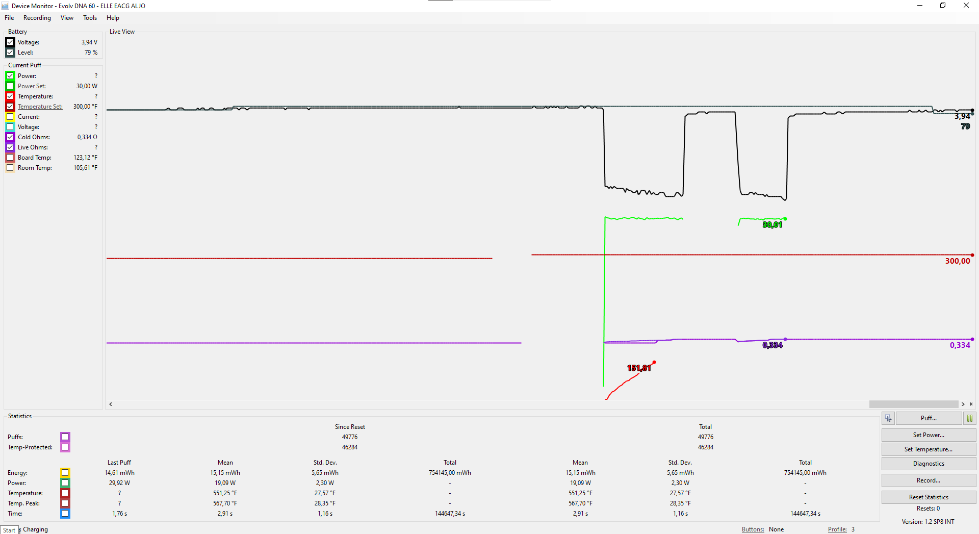

moa285 Posted July 16, 2024 Author Report Posted July 16, 2024 (edited) SS316L I hope I got you right and that's what you asked for. Atomizer analyzer is showing me kanthal. Edited July 16, 2024 by moa285
Wayneo Posted July 16, 2024 Report Posted July 16, 2024 Change to a TC (SS316) profile on your mod. Let the coil cool down (like 10 minutes) and ONLY enable 'Power' 'cold ohms' and 'live ohms'. Do another screenshot. Right now I saw no increase in the resistance between cold and live (and with all these different boards I believe 'live' always showed) but I could be wrong or it's not SS or it's not cold. Having said all that, Device Monitor says you've already done > 40K TC puffs?

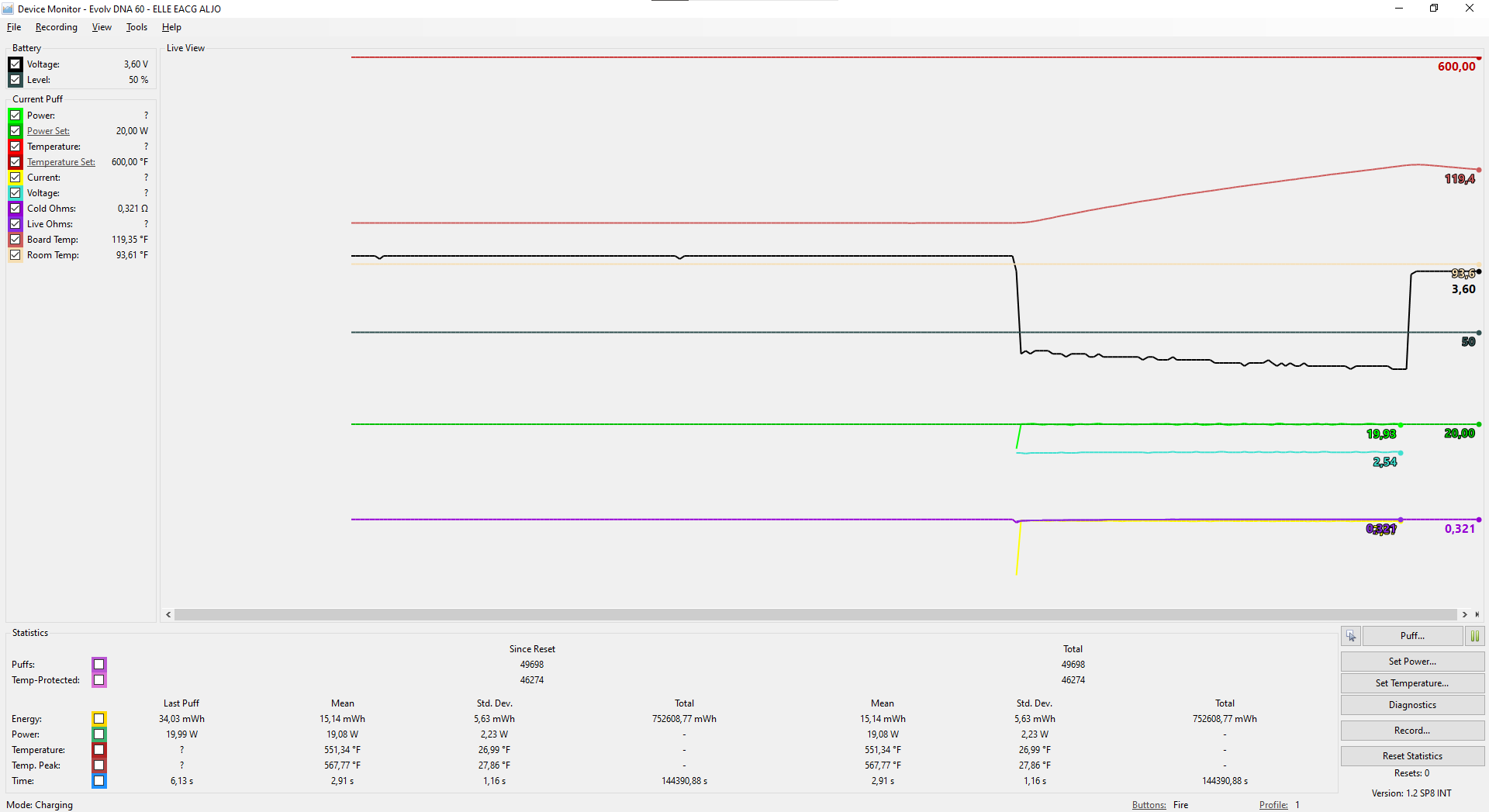

Wayneo Posted July 16, 2024 Report Posted July 16, 2024 Just checked on my own. My first is in watts mode and you can tell the rise but it's not as easy. The second while in TC mode shows the rise better. This is an SS coil.
moa285 Posted July 16, 2024 Author Report Posted July 16, 2024 17 minutes ago, Wayneo said: Change to a TC (SS316) profile on your mod. Let the coil cool down (like 10 minutes) and ONLY enable 'Power' 'cold ohms' and 'live ohms'. Do another screenshot. Right now I saw no increase in the resistance between cold and live (and with all these different boards I believe 'live' always showed) but I could be wrong or it's not SS or it's not cold. Having said all that, Device Monitor says you've already done > 40K TC puffs? I have been using these coils since the beginning and everything has always worked without any problems. Only now that they have "modified" them on the package and coils it still says SS316L 0.3ohm. The only change I have noticed is that there is more rubber underneath the coil. See the picture below, left with less rubber, everything works and right with more rubber, the TC doesn't work and it wasn't a defect of one piece, it's the second coil, that's why I'm only addressing it now. Just the "non-temperature-controled" puffs were with the new coil.

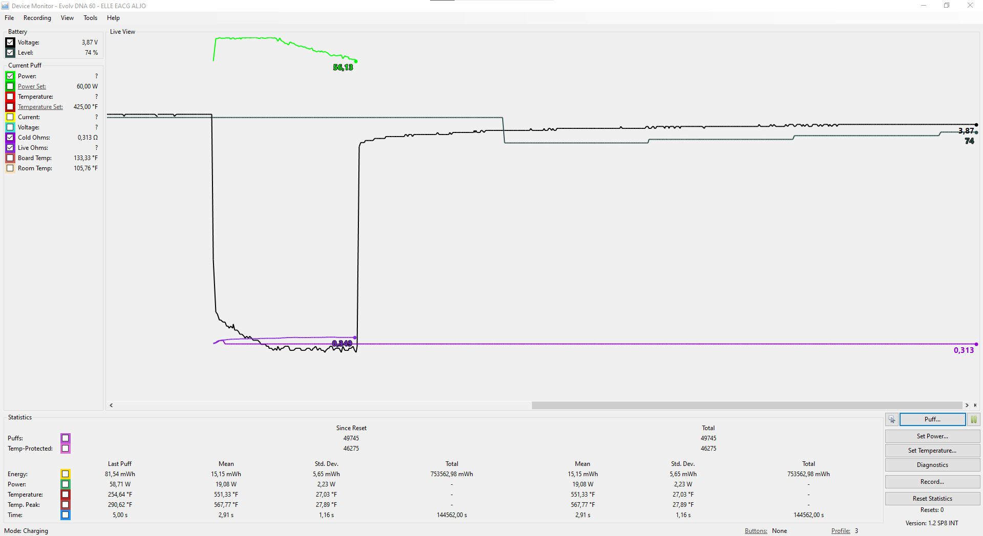

Wayneo Posted July 16, 2024 Report Posted July 16, 2024 That looked like a TC puff (barely) to me. If you were to now click 'temp' and 'temp set' you should see the 2 red lines. I find it hard to believe you need that much power to get that coil to hit that max 425F. (actually it barely hit 300F when you ended the puff, but with your battery not being able to keep up). As your coil cools even more, that .313Ω (cold ohms) might drop even lower. I see what you mean about the amount of rubber, if anything you might want to let dotmod know these new coils are inferior.
moa285 Posted July 16, 2024 Author Report Posted July 16, 2024 (edited) I never used the SS316 profile, so it had default values. I was on SS316L from the beginning. At one point I also thought I felt that switching to SS316 fixed it. I'll let dotmod know. Now I tried going back to the default settings and it seemed like the TC worked (SS316 profile) for a while and then immediately stopped. No idea why. It was measuring the temperature and then it automatically switched to OFF on the mod screen Edited July 16, 2024 by moa285
Wayneo Posted July 17, 2024 Report Posted July 17, 2024 1 hour ago, moa285 said: I never used the SS316 profile, so it had default values. I was on SS316L from the beginning. I have no idea what you mean by that. You had both a 316 AND a 316L material type and you're switching between the two? Well, you have 2 solid 30 watt puffs shown. If your mod shows "OFF", it did that because your coil is not TC controlable(even if it is SS the ohms are not rising enough), and so it fires at the power you set and your mod has turned TC off.
moa285 Posted July 17, 2024 Author Report Posted July 17, 2024 (edited) I downloaded the SS316L profile to my device immediately after purchase and have been using it ever since. I never used the SS316 that was in the device when I purchased it. Sorry, English is not my first language. Anyway, it seems there's nothing we can do about it here, so at least thank you for looking into it with me and for your time. And when I talked about the SS316 profile having default values, I was responding to when you said "I find it hard to believe you need that much power to get that coil to hit that max 425F." I'm gonna go complain to Dotmod. Edited July 17, 2024 by moa285

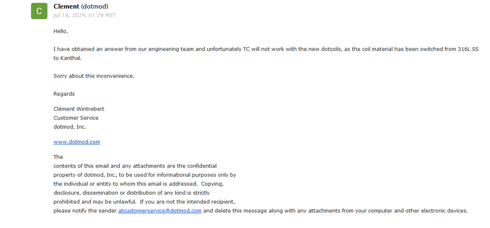

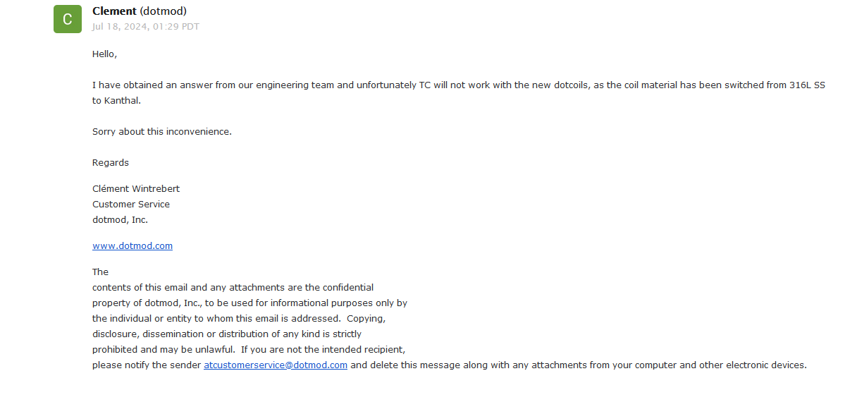

moa285 Posted July 19, 2024 Author Report Posted July 19, 2024 Well, that settles it. The problem is that it still says SS316L on the coils packaging and on the coils themselves. 1
