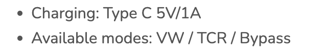

LacocoRoco Posted January 23, 2024 Report Posted January 23, 2024 Hi, on the 23.05.2023 i bought the Dovpo Odin 100 Mod from Oxyzig. In the FAQ they mentioned Dovpo Odin is using the DNA Evolv Chip. I tried to Update the Firmware with all available EScript Suite installations. But it is not possible to connect the Dovpo Odin 100 with the Software. I also can't find it in the Device Manager. Changing USB Ports or USB Cable. Nothing worked. Do they lock the Firmware? Or did i miss something else? Does anyone have some suggestions to fix this problem?
Wayneo Posted January 23, 2024 Report Posted January 23, 2024 Welcome @LacocoRoco but if the link you posted is correct, what you have IS NOT a DNA mod. If you can find your 'bypass' mode that is NOT a feature on any DNA or 1A charging. 2
LacocoRoco Posted January 23, 2024 Author Report Posted January 23, 2024 This is possible. I will check it when i get home back from work. If this is true, could i probably replace it with the Evolv DNA 100 Color? Or should i buy a new mod? (Probably this forum would be the way to go)
Wayneo Posted January 23, 2024 Report Posted January 23, 2024 It says right there in the product description "...............The Odin 100 is equipped with the DOVPO chipset" 1 hour ago, LacocoRoco said: could i probably replace it with the Evolv DNA 100 Color? You'd need to measure from the center of the bottom actuator to the center of the usb and if it's about 8mm then a swap would probably work. IF you want to use Replay or temperature control then you might want a DNA. If you're just a straight watts user ... save your money. 2
