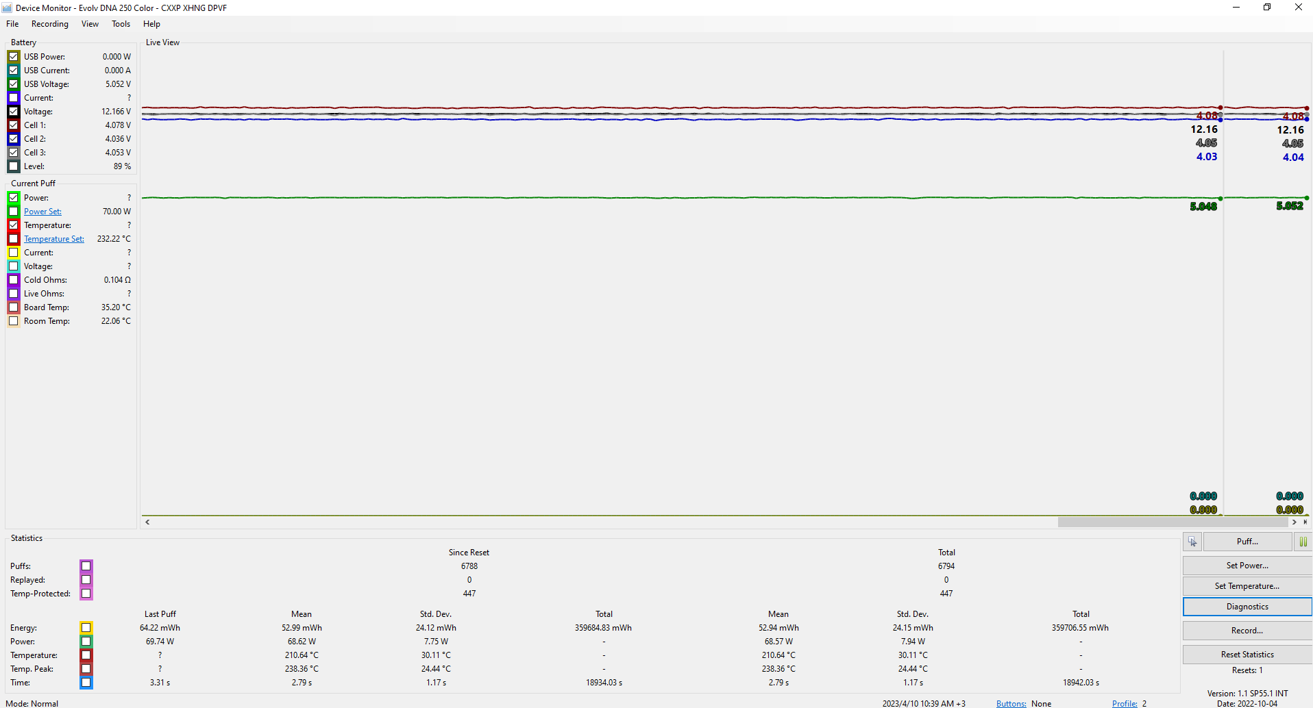

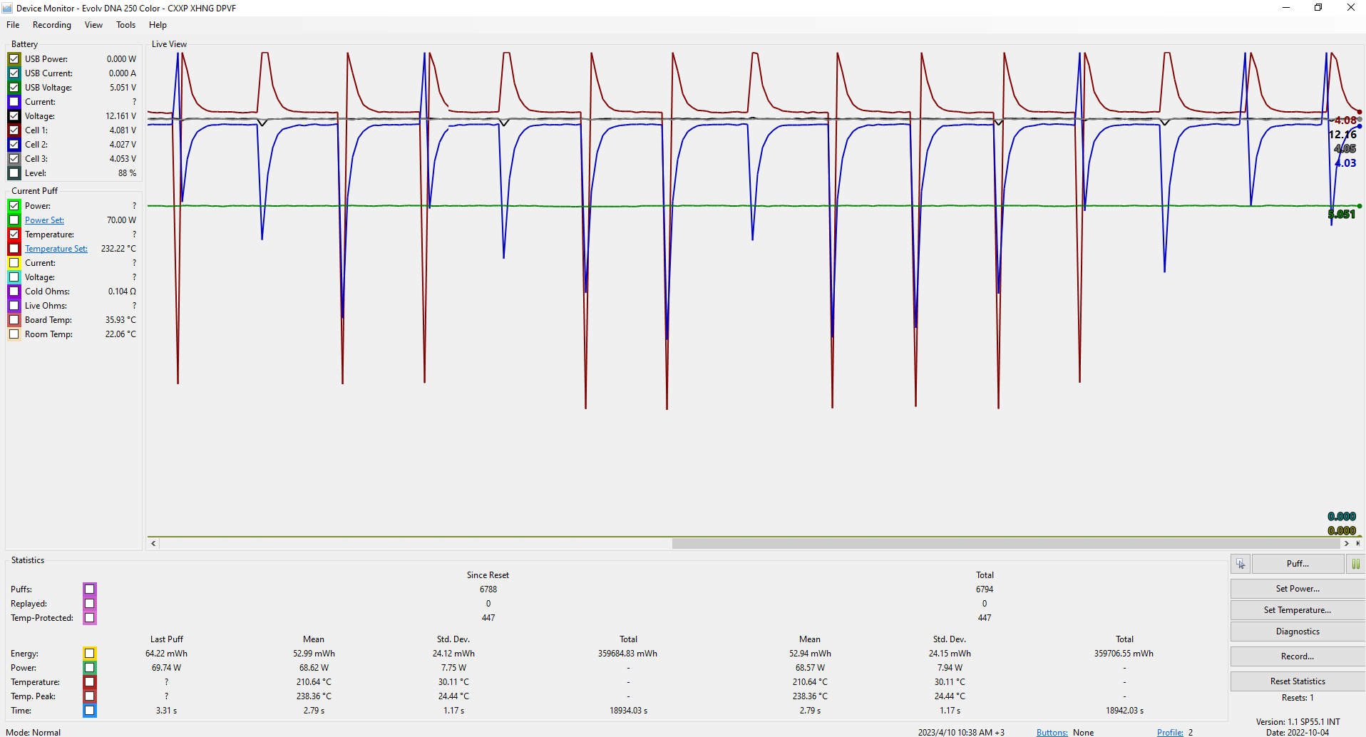

However now i have an issue. USB charging will not work. It tries to charge (4 long red pulses then green) but after 5 seconds it stops.
Using the monitor here is with USB charging enabled (top photo) and disabled (bottom photo)
My guess is that one of the balance wires/connection is bad, but during my inspection and from the voltage monitoring they seem good. Any idea on what might be causing this and/or how to troubleshoot it?
From what i've seen could be a faulty Texas Instruments charging chip. In that case can i get a replacement? Bought from an Evolv vendor in Germany.

For future reference i found the issue and fixed it, one of the balance wires was broken internally. Replaced it and works perfectly fine now.
