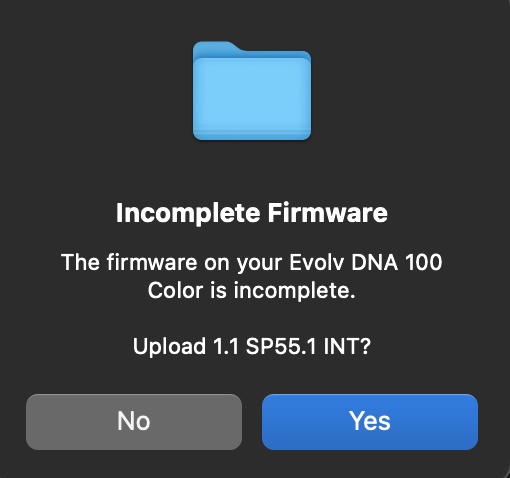

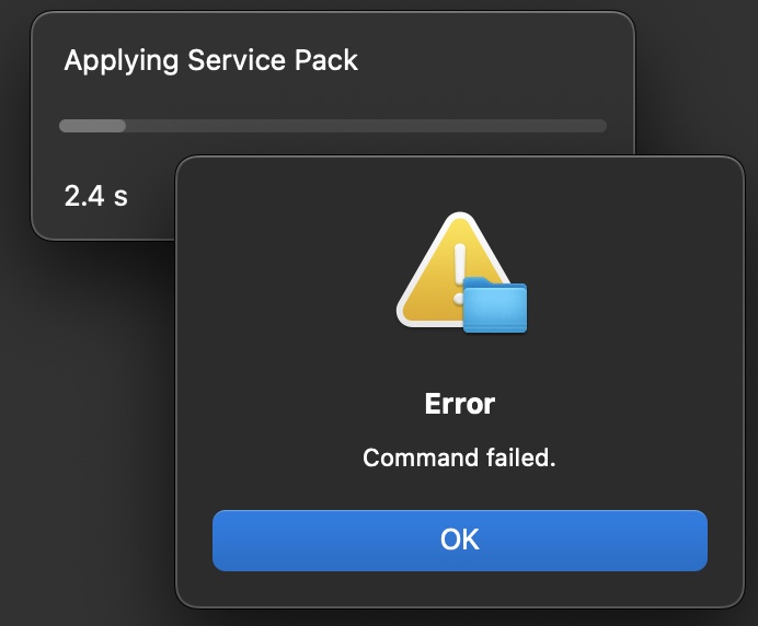

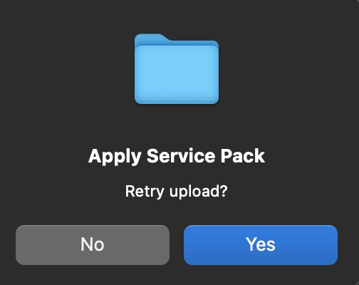

I've been having a weak battery error for some time, decided to try updating firmware with most recent service pack. Upon launching the suite on mac, updated the pack and connected mod, tried to update the mod with the service pack and the installation failed. I tried several times and it failed every time. Now I can't even download the settings from mod to suite because I have incomplete firmware.

Ideally restart Mac and with a different cable plugged in directly (not with a hub) and a different port.
Start escribe and try to upload firmware
If it fails/doesn't work
Tools -> Diagnostics -> Reboot -> Hard reboot -> Try upload firmware again
