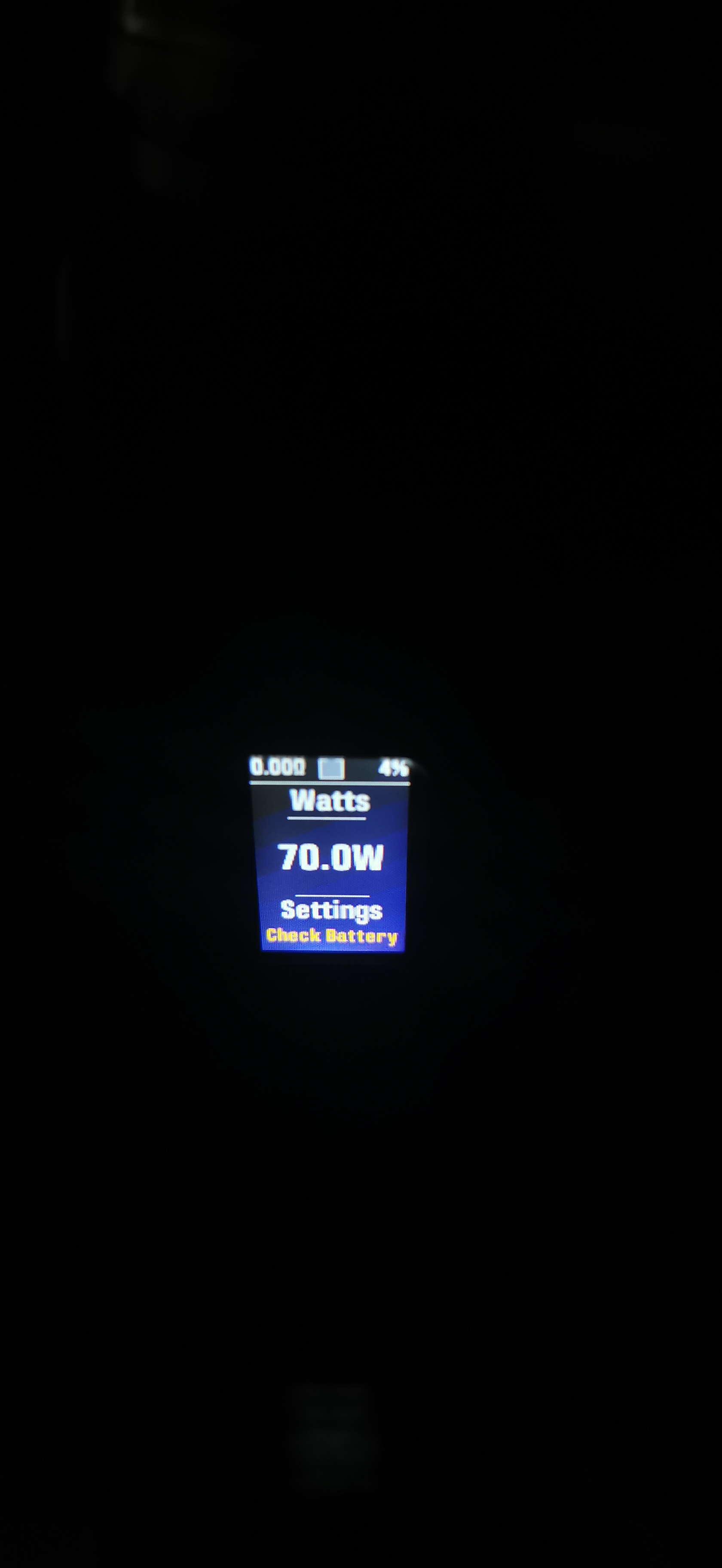

TLP DESIGN Posted November 9, 2022 Report Posted November 9, 2022 (edited) Hi guys. first of all sorry for my bad english. I have a problem with battery percentage which is not shown properly. I left the box on charge for at least 5 hours, it never reaches the 100% (in the past I had no problem with it.) The percentage drops from 54% after 5 hours charging to 8%, this happens more after I puff. I have no idea how to use Escribe software to make correct settings, I use the box on Watts profile, 0.2 Ohm and 70 watt. I've seen there is a cell option (I have 2) and I can change it but I'm afraid to do it, I don't want to make troubles... I attach some screenshots, thank you very much for your support. EDIT: I've done a settings reset and now it says "check battery", battery is plugged by USB but it's not charging....if I click settings > atomizer > measure it does nothing... please help I love this product and I don't want to change it... :(( log_3.csv Edited November 9, 2022 by TLP DESIGN

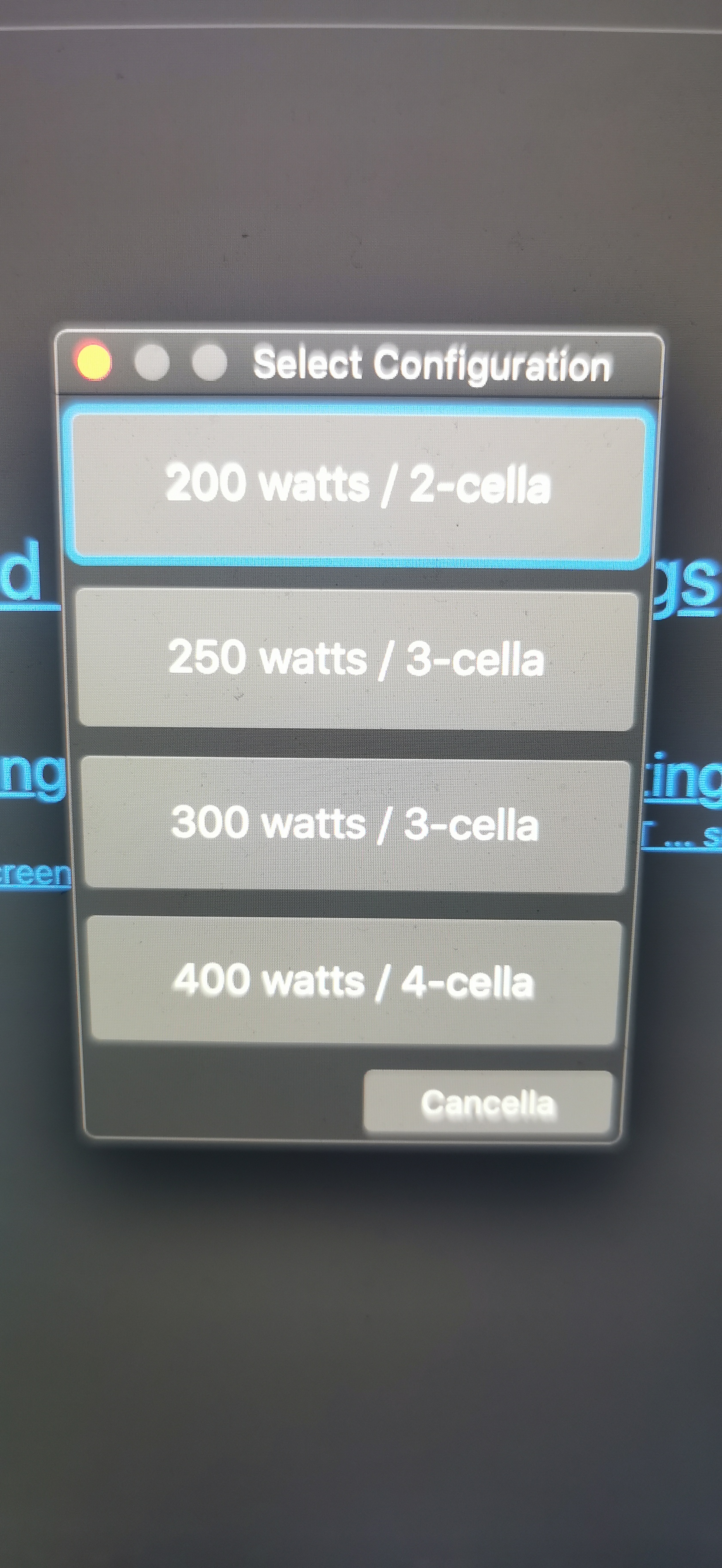

dwcraig1 Posted November 9, 2022 Report Posted November 9, 2022 On all your screens the settings look good. After you did the reset is it possible that it changed from 2 cells to 3? If so change it back to 2 and upload settings. You have it set for maximum recharges which is fine but charging wil stop at around 94% On your 1st screen those wavy lines are not good.
TLP DESIGN Posted November 9, 2022 Author Report Posted November 9, 2022 (edited) Hello, first of all thank for your answer. The problem is that I did a reset and now is even worse cause It keeps saying "check battery". which one I've to choose of this? I selected 250W 3 cell cause I thought it should be this for the 250C VTBOX. it's 200watt 2 cell or 250w 3 cell? Unfortunately I don't know anything about this box. Edited November 9, 2022 by TLP DESIGN
Wayneo Posted November 9, 2022 Report Posted November 9, 2022 18 minutes ago, dwcraig1 said: After you did the reset is it possible that it changed from 2 cells to 3? If so change it back to 2 and upload settings.
TLP DESIGN Posted November 9, 2022 Author Report Posted November 9, 2022 (edited) 4 minuti fa, Wayneo ha scritto: yes I just did it and now it says 34% percentage but this is not possible cause the battery is charging since 06 AM this morning :(( but at least now I can use it the problem is that I will never know when batteries are low... Edited November 9, 2022 by TLP DESIGN
