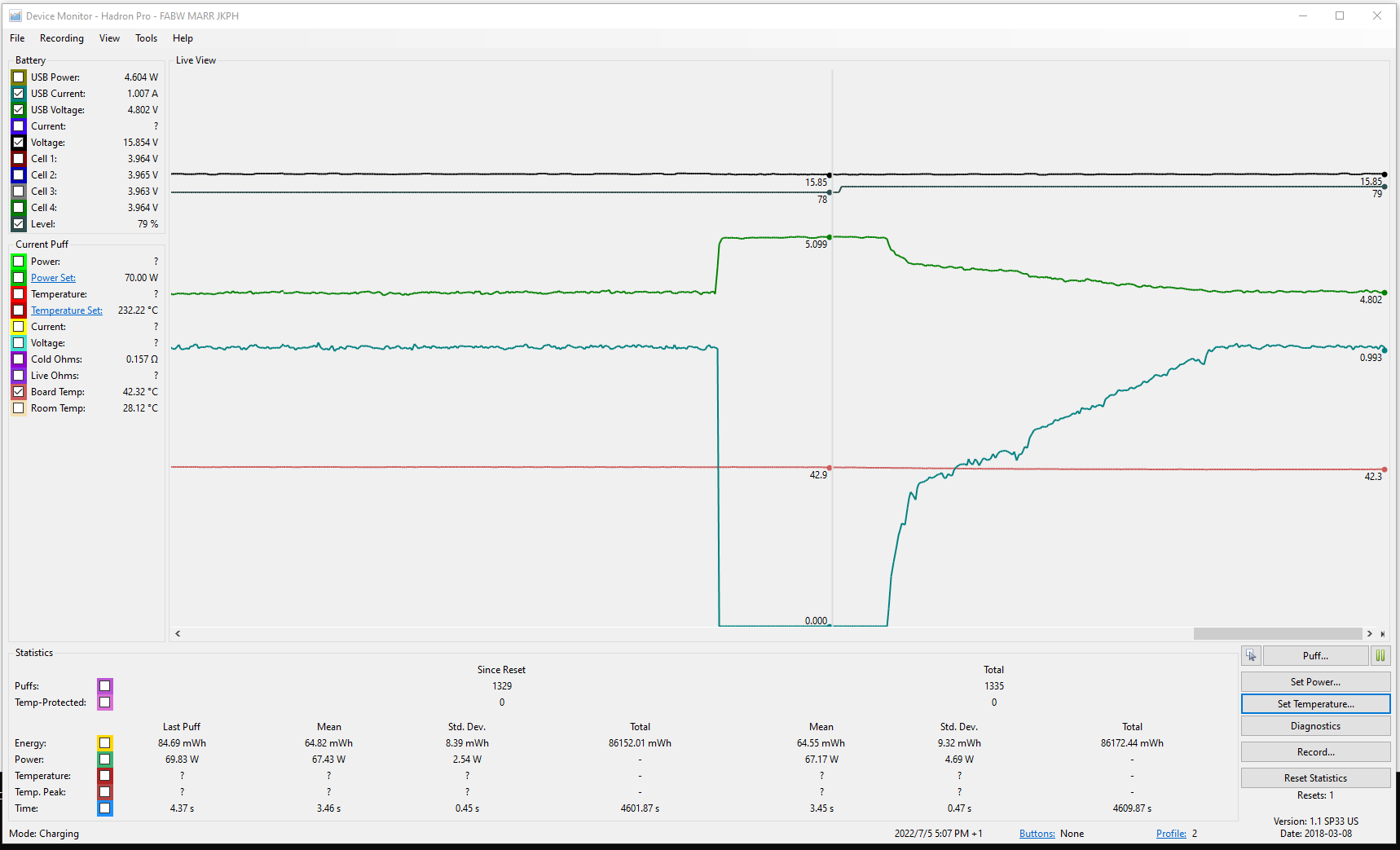

I've had the Steam Crave Hadron Pro since last week. I've been charging the LiPo battery via USB and that's been fine for the 4-5 days prior to today when it seemed really slow to charge. I noticed the charging lightning bolt on the battery icon appears to disappear semi-regularly, so I checked on device monitor and every so often the USB voltage will spike a little and the current will drop to zero.
Is this normal or is my unit going faulty in under a week?

The dissapearing lightning bolt from the battery icon has happened with multiple cables on a phone style USB brick adapter, and also plugged into the USB output of a Nitcore SC4 battery charger. The behaviour shown in the screen shot happened with 2 different leads while plugged into the PC, across several different USB ports.
