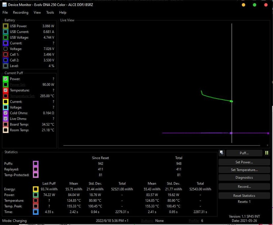

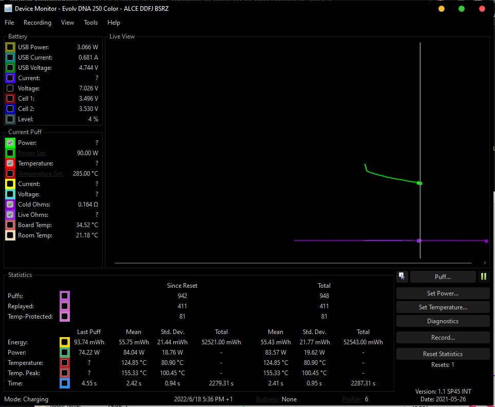

illogik Posted June 18, 2022 Author Report Posted June 18, 2022 (edited) On 6/16/2022 at 7:36 PM, Wayneo said: This can be one of the most difficult issues to find due to so many different reasons. Was this a new coil or new wire or a new atty? Was the coil checked for any hotspots before using, and screws were still a tight connection? Was the coil installed at room temperature? Describe the coil and Ω's. Using Atomizer Analyzer tell me how much the coil fluctuates over a minute. While taking a puff using Device Monitor (and the same 3 fields as below(1)), pause the screen (2), hover your mouse over near the end of the puff (3) and click for that vertical line, and post the full screenshot like I did. It was an already used coil in an already used tank, both used already on this dna mod. No hotspots and all screws tight. Installed at room temp yes. The coils are a pair of SS316 SSFC's at 4mm ID, 0.16Ω In Atomizer Analyzer the coil sits at 0.164Ω and every few secs will go up to 0.165Ω briefly then back to 0.164Ω Here is the screenshot from one of my hadron plus that has this issue. One of my hadron pro's has the issue also but that is a build I did a while ago so I'm going to check the coils first. Edited June 18, 2022 by illogik

Wayneo Posted June 18, 2022 Report Posted June 18, 2022 3 hours ago, illogik said: It was an already used coil in an already used tank, both used already on this dna mod. No hotspots and all screws tight. Installed at room temp yes. The coils are a pair of SS316 SSFC's at 4mm ID, 0.16Ω In Atomizer Analyzer the coil sits at 0.164Ω and every few secs will go up to 0.165Ω briefly then back to 0.164Ω Here is the screenshot from one of my hadron plus that has this issue. One of my hadron pro's has the issue also but that is a build I did a while ago so I'm going to check the coils first. I hope all these comments relate to the screenshot you posted. If you look at my screenshot (3) you'll see my cold ohm raised from the live ohms (from .363 to .430). Yours are a flat line. So long as your coil is SS your live ohms should rise no matter what based on your answers. You can try swapping atty's, and the current on working on your Plus should work on the Pro. During the swap, check the positive connection on your atty's are tight, and wipe down the threads on your mod and atty with a qtip and some ISO or windex. Edit: I didn't ask you to click on the Power Set option, but if you looked at the screen you might've seen the 'low battery' warning based on your green line. And there are no values shown like in my screenshot (3). Edit 2: And can you post a screenshot of your Mod -> Battery page. Did you change the battery curve on that Plus?

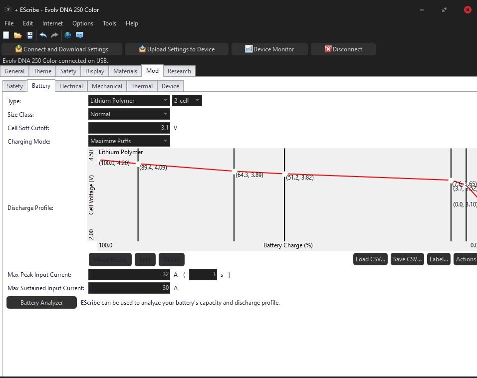

illogik Posted June 18, 2022 Author Report Posted June 18, 2022 I didn't click on the power set option? How do I turn on those values? They aren't there on my escribe. I didn't change the battery curve as it's not a lipo mod, it's dual 21700. Should I still be changing it?
Wayneo Posted June 18, 2022 Report Posted June 18, 2022 3 minutes ago, illogik said: I didn't click on the power set option? How do I turn on those values? It's right there below the 'Power' I asked you to post a screenshot of your Mod -> Battery page. I only asked if you had changed it.
illogik Posted June 18, 2022 Author Report Posted June 18, 2022 I know whats up with it lol. I just remember I swapped out those coils for some I got sent in the mail from somebody and they are ni80 so ofc not compatible with tc. Oops! Battery shot here.
illogik Posted June 18, 2022 Author Report Posted June 18, 2022 Theres 3 arrows in your screenshot at point 1. Pointing to Power, Live ohms and cold ohms. Those are the same 3 I selected. I didn't click power set.
Wayneo Posted June 18, 2022 Report Posted June 18, 2022 Thank you for the screenshot 👍 1 hour ago, illogik said: Those are the same 3 I selected. I didn't click power set. Yeah, I know, I already said that. After seeing that green line I was saying I should have. Moving on, that's horrendous that SteamCrave would configure those parameters. Change the battery type from (Lipo) Lithium Polymer, to Lithium Ion 18650 Ideally, you should use your actual battery specs and run the analyzer yourself, or search for someone elses curve for your battery. Upload settings to mod. 1
