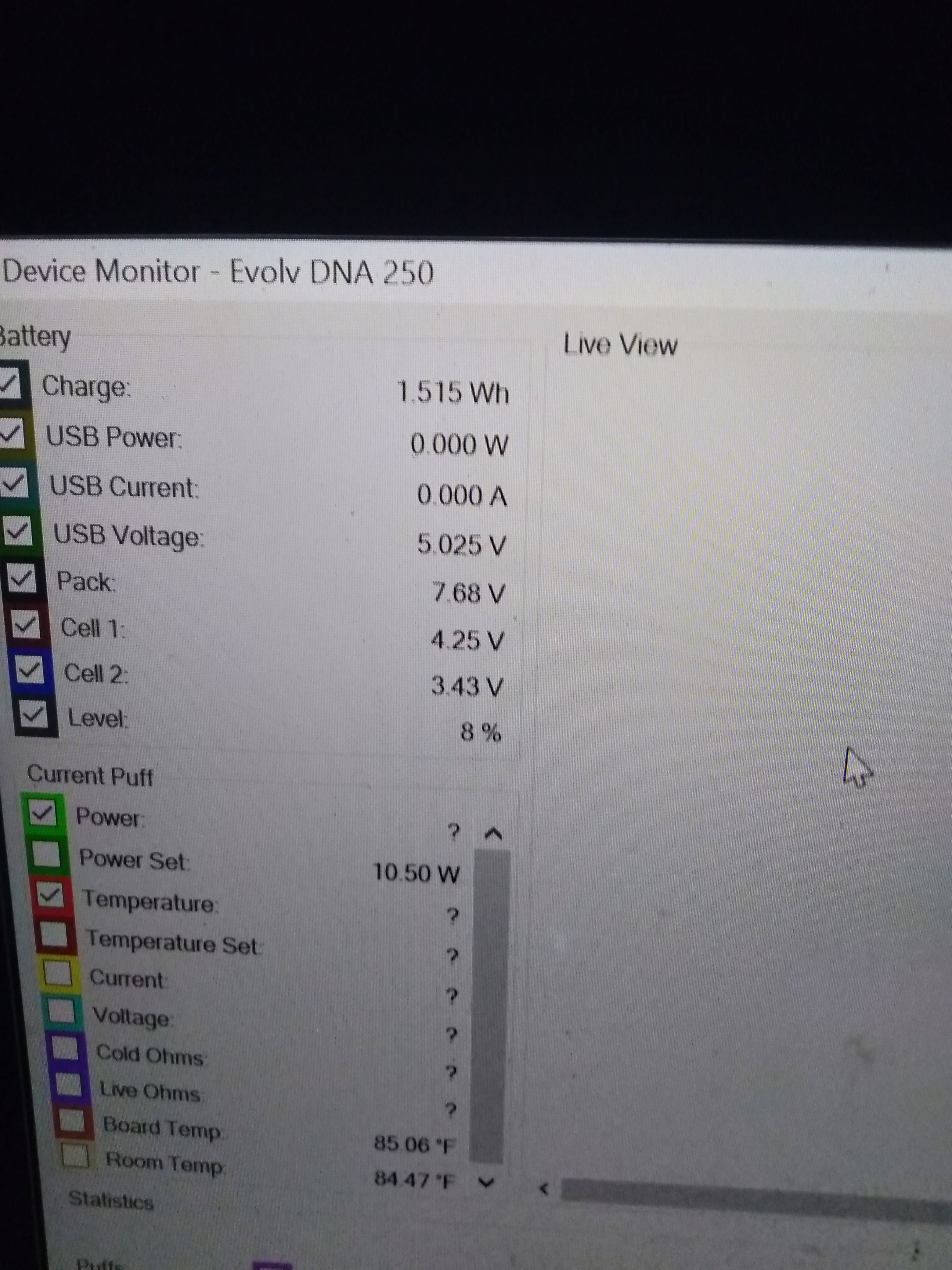

Bluepandaxx Posted September 17, 2021 Report Posted September 17, 2021 Hi everybody..! I have DNA 250 non C, but there is a problem with cell 2. after I looked at the device monitor, cell 2 reads lower voltage than cell 1, even though the battery is in good condition and both are still full. I've tried to move the battery position, and always cell 2 reads less than 3.7v. My question is, where is the problem? Is it from the board or is there an error with the escribe? if it's from the escribe I don't think so because I have reset it to factory settings with type 2 batteries. thank you for your attention, I hope I get an answer soon stay safe. 1
Wayneo Posted September 17, 2021 Report Posted September 17, 2021 That looks like ejuice down at the bottom of the board in/on the JST connections or where they connect to the board. I think if you open up your mod you'll find ejuice that needs to be cleaned off. 1
