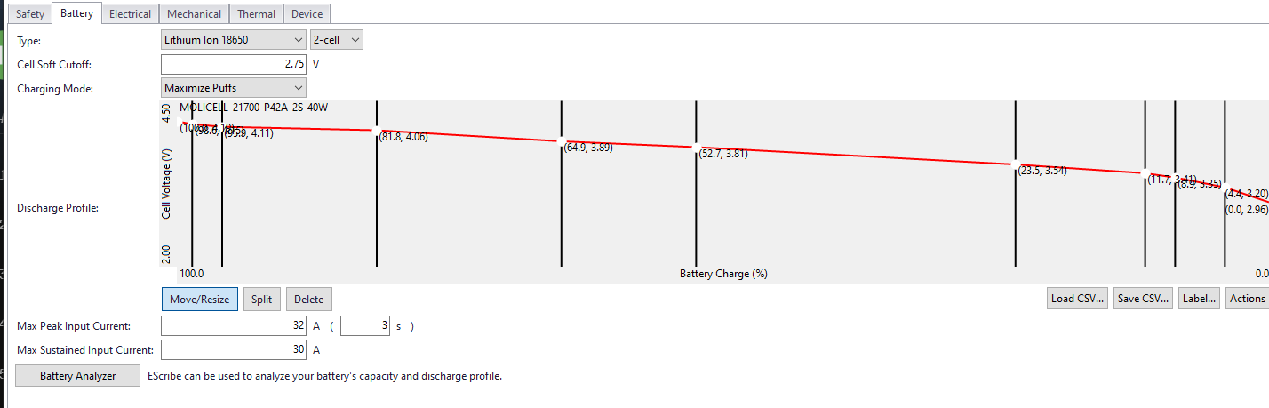

dl12345 Posted July 13, 2021 Report Posted July 13, 2021 Every so often, randomly it seems, I'm getting a weak battery warning with my Dovpo twin 21700 mod using two brand new Molicel P42As. Not sure what's causing it - the problem happens even at well near to 100% battery. My preheat is set to 200w (dual coil SS304 claptons @ 0.26v) punch 11 and then normal power is 120w My battery setup is below Anyone have as to what in my setup might be causing this? I doubt I have dud batteries as I bought them from the official UK distributor

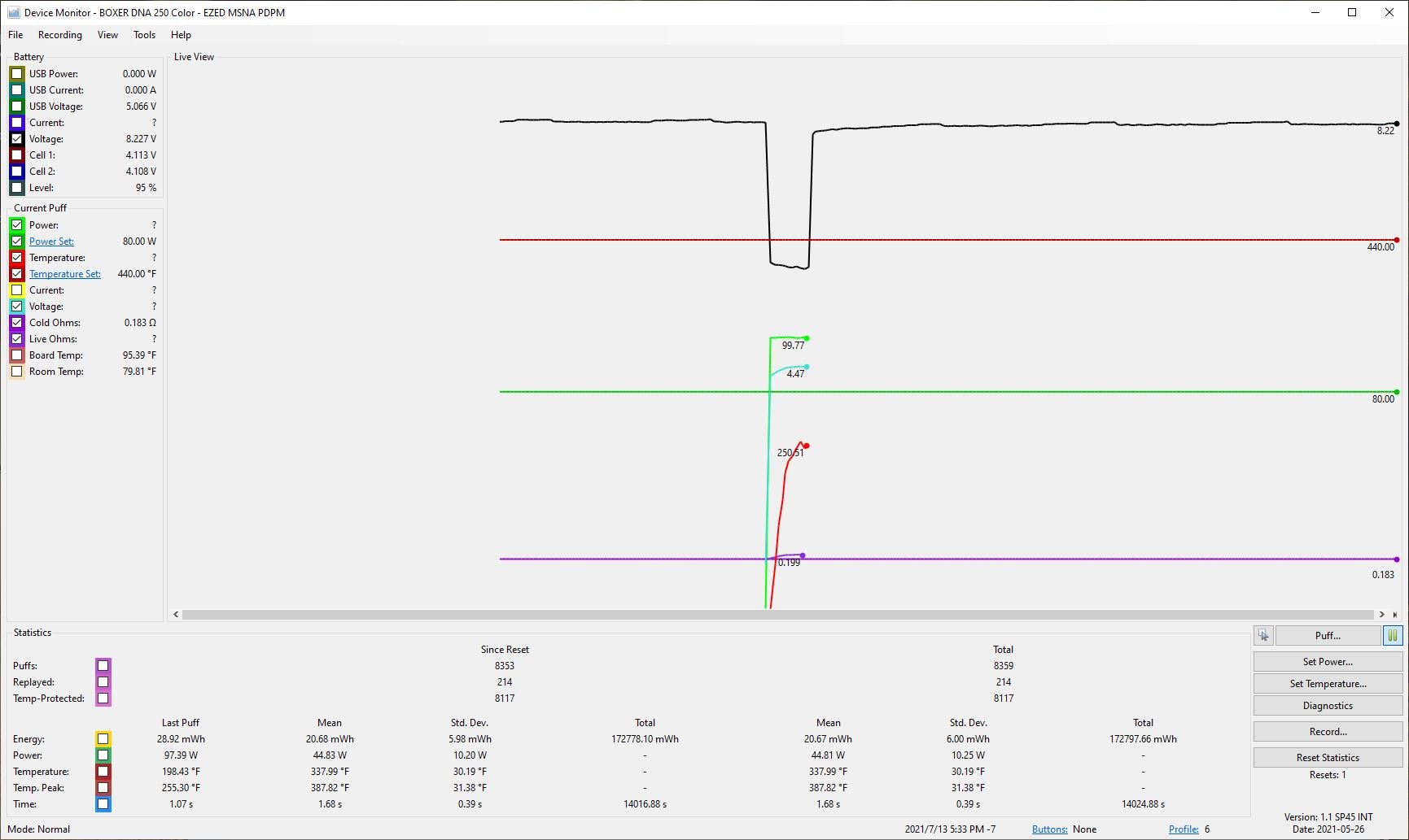

retird Posted July 13, 2021 Report Posted July 13, 2021 Connected to Device Monitor in EScribe you can see how the device is managing watts/temp/battery/battery sag and etc. while firing You are not using Kanthal from what you posted which is stainless steel.... wondering if it is just battery sag while firing?? 1

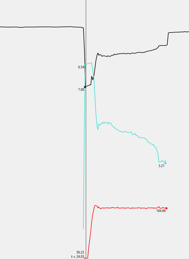

dl12345 Posted July 13, 2021 Author Report Posted July 13, 2021 40 minutes ago, retird said: Connected to Device Monitor in EScribe you can see how the device is managing watts/temp/battery/battery sag and etc. while firing You are not using Kanthal from what you posted which is stainless steel.... wondering if it is just battery sag while firing?? Max voltage draw and battery sag values highlighted. Does this shed any light?
dwcraig1 Posted July 14, 2021 Report Posted July 14, 2021 It looks to me that you are hitting the set temperature and the board is throttling down the power. Your lowest voltage drop on the pair of cells appears to be 7.08 volts, half being 3.54 volts, well above the 2.75 volt cutoff. Could you post the entire screen with the boxes checked like this snippet?
