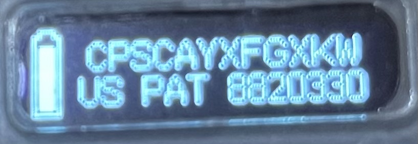

vape vape Posted June 18, 2021 Report Posted June 18, 2021 (edited) I get this screen and can't operate at all. What is this screen? Edited June 18, 2021 by vape vape
dwcraig1 Posted June 18, 2021 Report Posted June 18, 2021 On 6/18/2021 at 3:42 AM, vape vape said: I get this screen and can't operate at all. What is this screen? Expand I assume that's a DNA40. Its the serial number of the board. 1
vape vape Posted June 18, 2021 Author Report Posted June 18, 2021 This is DNA 60. I get this screen and the wattage keeps dropping and I can't operate it.😭
BillW50 Posted June 18, 2021 Report Posted June 18, 2021 (edited) 10 minus clicks displays serial number on an iTaste SVD 2.0 (DNA20). Might work that way with other DNAs too. And coupled with the fact the wattage keeps dropping,.. sounds like the down button is intermittently making a connection. Or at least the board thinks so. Edited June 18, 2021 by BillW50
