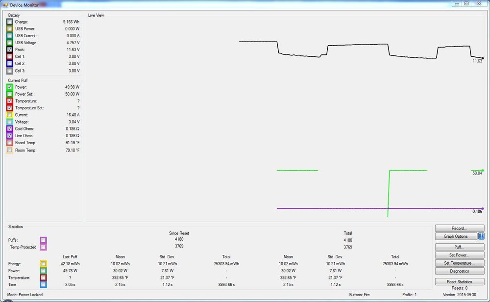

dwcraig1 Posted May 28, 2021 Report Posted May 28, 2021 Are you seeing this in EScribe or on the mods screen?
dwcraig1 Posted May 28, 2021 Report Posted May 28, 2021 I suggest checking it with EScribe's Device Monitor. The screen really doesn't keep up as quickly. Note: The purple line.
Wayneo Posted May 28, 2021 Report Posted May 28, 2021 11 hours ago, vape vape said: when I press the button to heat it up, the resistance drops a little How much is a little? 11 hours ago, vape vape said: After it goes down, it stabilizes Stabilizes at the higher value, or the lower value? Post a screenshot like above while firing, showing that behavior 1

Wayneo Posted June 10, 2021 Report Posted June 10, 2021 A 0.03 drop is nothing to worry about at all, especially with a Kanthal coil in power mode. Surprised you could even see that on the screen, but next time if you're concerned, you can Post a screenshot like above while firing, showing that behavior 🙌
