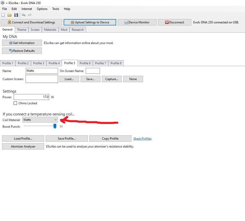

If I put on a sub ohm it works fine but only using 65 watts. The rda I’m pushing 90 to get a vape. I know the ohms change a lot when I fire it. The pic below is the one giving me the error.  Works fine on my Ursa Quest. Hope someone can help.

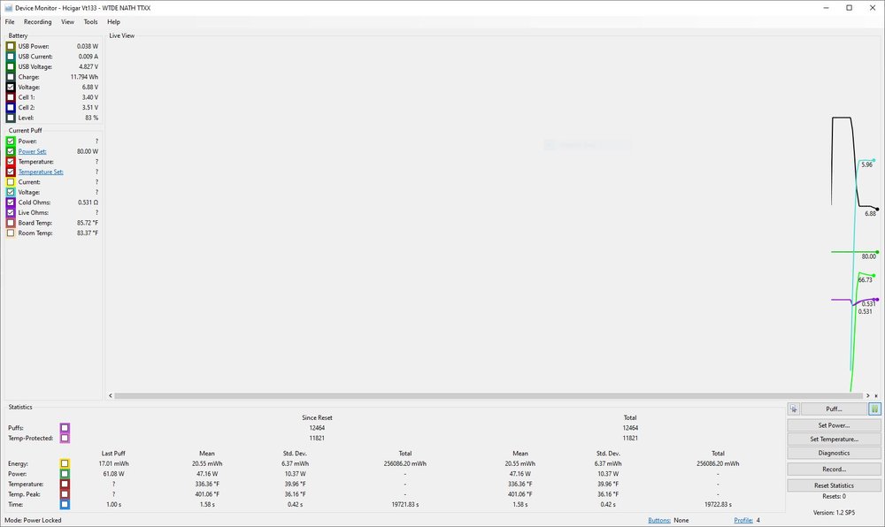

Here is a snippet of my 2 cell DNA200 firing at 80 watts (set to 80). I was going to ask you to post the same of yours when I seen mine doing the same.
Here is why mine only reached 66 watts and not 80. All of the DNA boards that use cells in a series are buck only meaning that their output voltage will never be more than battery pack voltage. In this case the 200 board powered by 2 cells has a maximum output of 6 volts.
Note in my snippet that @ 66 watts the output voltage is maxed out at 5.96 volts (blue line), if I built a lower resistance coil it could hit 80 watts with the right resistance.
Could it be that you have the same thing going on?
The max voltage on a DNA250 board powered by two cells is 6.2 volts and the 250C is in that range also.
But looking at your build I doubt if that is your problem.
I would like to know what your pack/cell voltage drops to when firing. 6.88 v in my snip.

I am definitely saving these replies.  What I am assuming is it was do to a setting from something I downloaded into the mod.  What I did was restore the mod.  I then did an update and reinstalled a theme I liked but did not miss with any other settings.  I also realized when doing that I forgot dry fire and remove the hot spots from the coil so I am assuming that played a role in it.  Just from the fact I have seen coils vary after being dry fired for mech mods.  Thanks for taking the time and helping out!!
