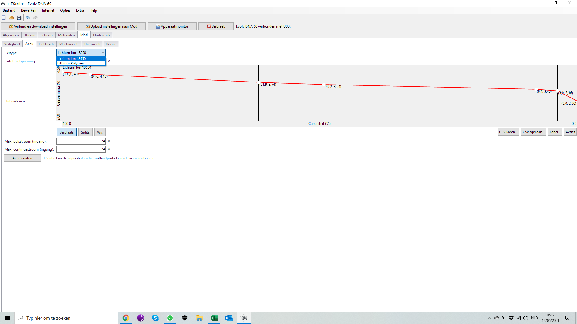

bigcloud80 Posted May 19, 2021 Report Posted May 19, 2021 I got a custom made dna60 mod powered by a 21700. Once my battery is at 40% it's starts blinking after every puff. The modder doesn't have a clue. I think I have this issue because on escribe it says there is a 18650 in it. I can't change it to 21700 the only options I have is Lithium 18650 or Lithium polymer. Is there someone with the right settings for my device? I know the Thrill plus is also a DNA60 powered by a 21700.

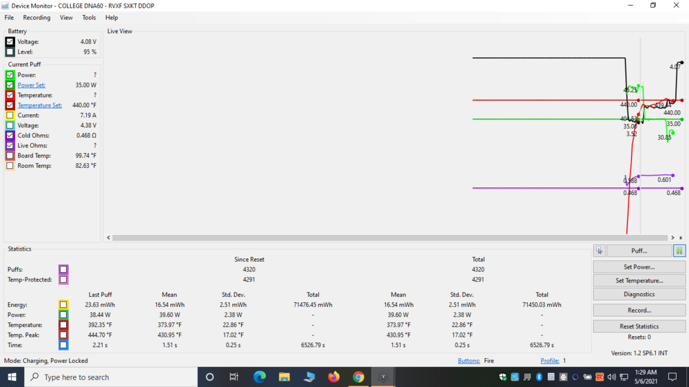

dwcraig1 Posted May 19, 2021 Report Posted May 19, 2021 The 18650 battery setting is correct, it more or lees just means round replaceable type cell. The Cell Soft Cutoff is set at 2.75 volts normally with a round cell. What is the standing voltage of the cell when it reports 40%? Can you post a snippet of Device Monitor firing under the conditions described in your post like the one below? Note on mine the voltage dropped to 3.52 while firing at 45 watts. Had it dropped to below 2.75 volts the low battery error should display. 2
