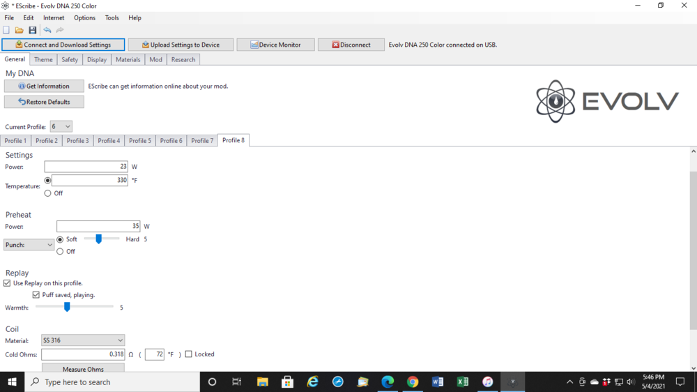

hittman Posted May 4, 2021 Report Share Posted May 4, 2021 I bought a new Dovpo Riva Dna250c the end of February and have been using it in replay mode with coilology 316ss flat braided coils in a geekvape zeus rta. It had been working fine until I went into escribe and changed how many times the fire button has to be pressed to wake up the unit. After uploading the settings to it, the Replay doesn't work. I checked in escribe and the box that says allow replay is selected. I've tried loading default settings and it made no difference. A friend sent me the orginal file for it and I installed that and it still doesn't work. It shows an empty box where it should say either "save puff" or cancel. I started a help ticket with evolv but haven't found a solution yet. I was thinking maybe someone else has had this problem and already has a solution. I hope so anyway. I downloaded the latest version of escribe yesterday and tried again to install the original file and there is no difference. 1 Link to comment Share on other sites More sharing options...

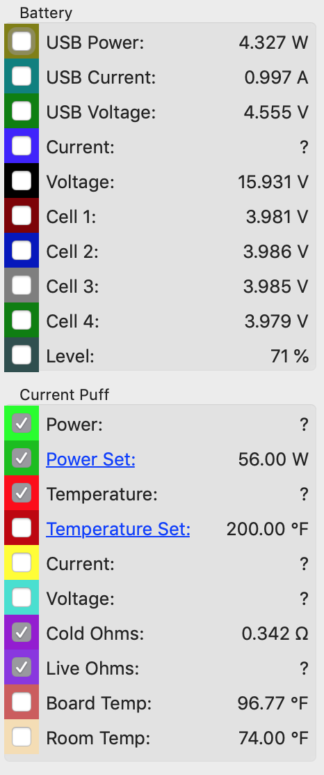

Wayneo Posted May 4, 2021 Report Share Posted May 4, 2021 Can you vape this coil in straight TC? Can you post a Device Monitor screenshot with the following fields ticked while in TC. Thanks. PS You know I know the whole backstory. 😉 1 Link to comment Share on other sites More sharing options...

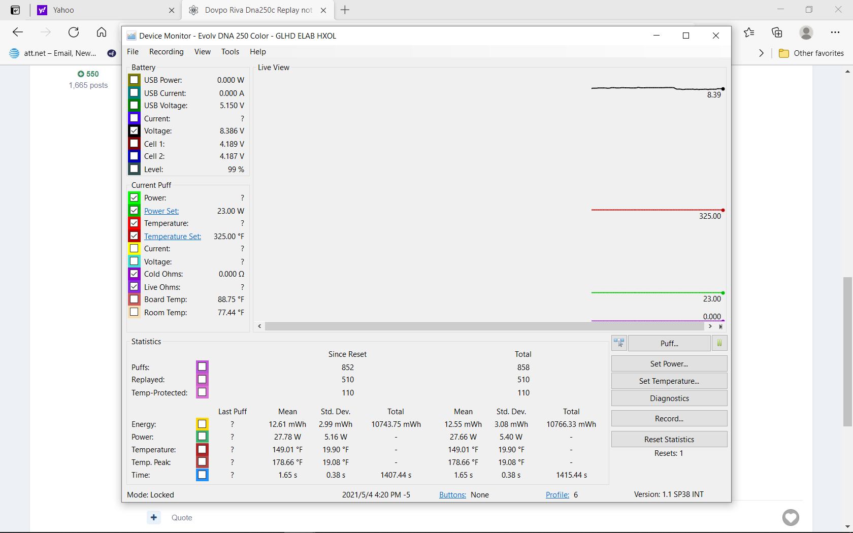

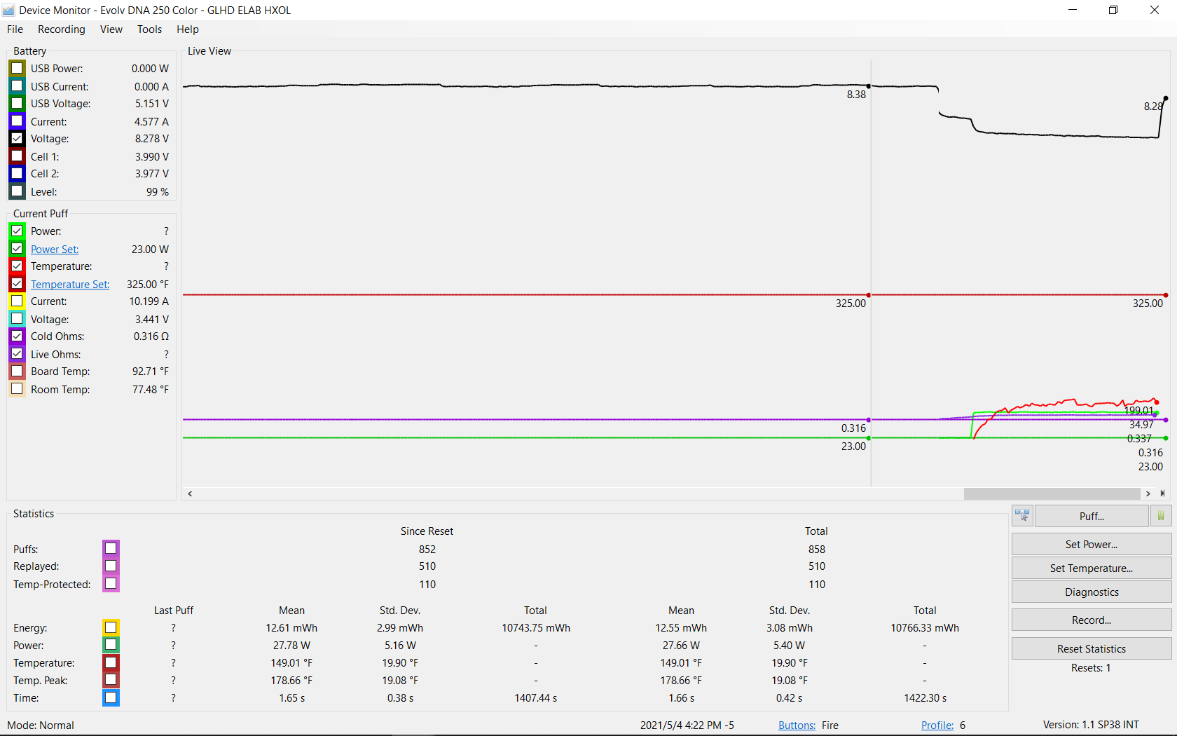

hittman Posted May 4, 2021 Author Report Share Posted May 4, 2021 I wasn't sure if you meant to fire it or not but here is the settings cold. And here it is firing. I can't do it long since I'm at work and can't let the boss see me. 1 Link to comment Share on other sites More sharing options...

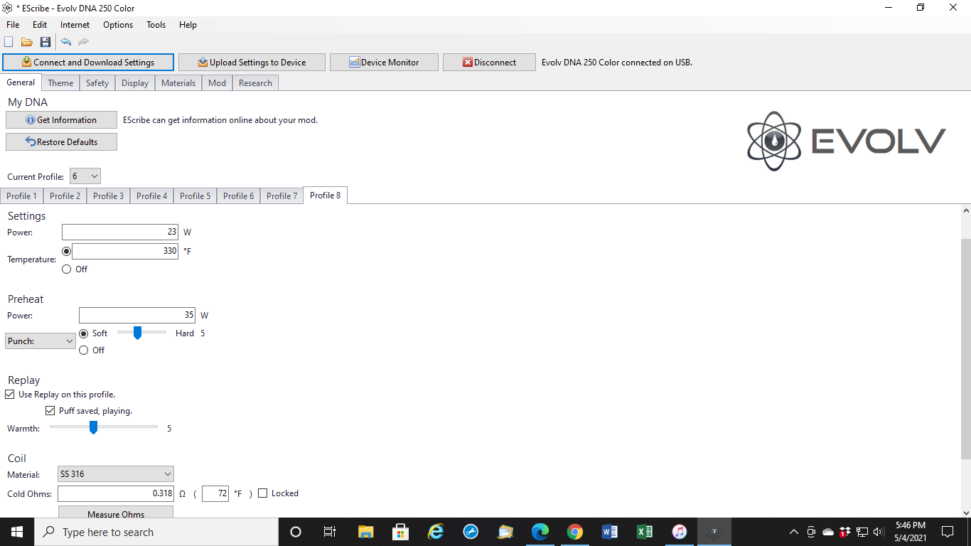

Wayneo Posted May 4, 2021 Report Share Posted May 4, 2021 Now can I see a Printscreen of your 'Replay' profile? No puff required 😉. Should be profile 1 or 8 in escribe 1 Link to comment Share on other sites More sharing options...
hittman Posted May 4, 2021 Author Report Share Posted May 4, 2021 1 Link to comment Share on other sites More sharing options...
Wayneo Posted May 4, 2021 Report Share Posted May 4, 2021 See how that 'puff saved' playing is ticked? Untick that. Change the ohms to 0.316 like you showed in TC. Upload settings to mod. Take a puff. 1 Link to comment Share on other sites More sharing options...
hittman Posted May 4, 2021 Author Report Share Posted May 4, 2021 Should ohms be locked? I tried what you said and still not working. 1 Link to comment Share on other sites More sharing options...
Wayneo Posted May 5, 2021 Report Share Posted May 5, 2021 (edited) 18 minutes ago, hittman said: Should ohms be locked? No. Do a Top Bar of escribe Tools - Diagnostics - hard reboot. Then a connect and download settings. Then tell me if that box (the second one - puff saved playing) is still ticked for the replay profile Edited May 5, 2021 by Wayneo PUFF SAVED PLAYING BOX 1 Link to comment Share on other sites More sharing options...

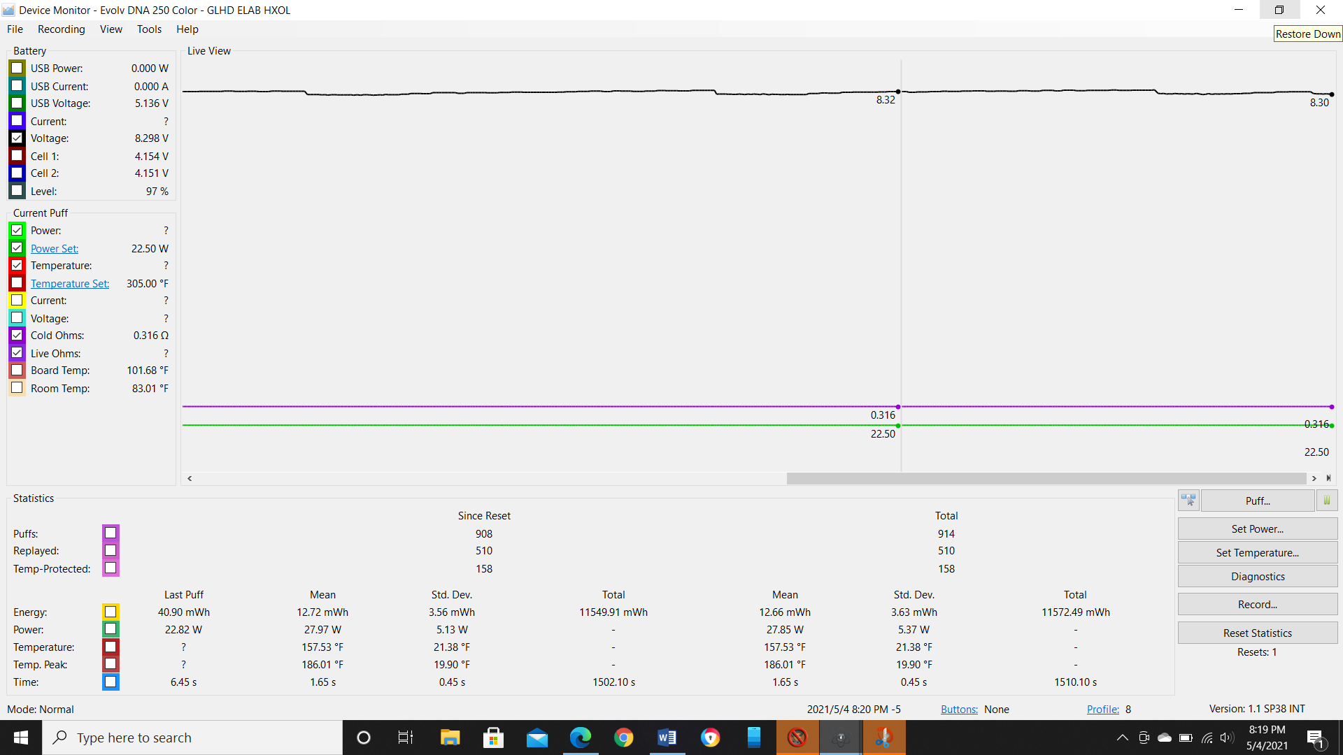

Wayneo Posted May 5, 2021 Report Share Posted May 5, 2021 All normal what you see. Did you see 'save puff'? Edit: On your 1st printscreen you never exceeded 35 watts, but you can increase the punch in 'watts'. Link to comment Share on other sites More sharing options...
hittman Posted May 5, 2021 Author Report Share Posted May 5, 2021 No, still doesn't say save puff. Link to comment Share on other sites More sharing options...
Wayneo Posted May 5, 2021 Report Share Posted May 5, 2021 And set the watts to 35 Link to comment Share on other sites More sharing options...

Wayneo Posted May 5, 2021 Report Share Posted May 5, 2021 Yup and a printscreen. Your 1st puff barely hit 200F. Adjust the watts till it feels good, then look at the screen. You might need 40+ watts. 1 Link to comment Share on other sites More sharing options...

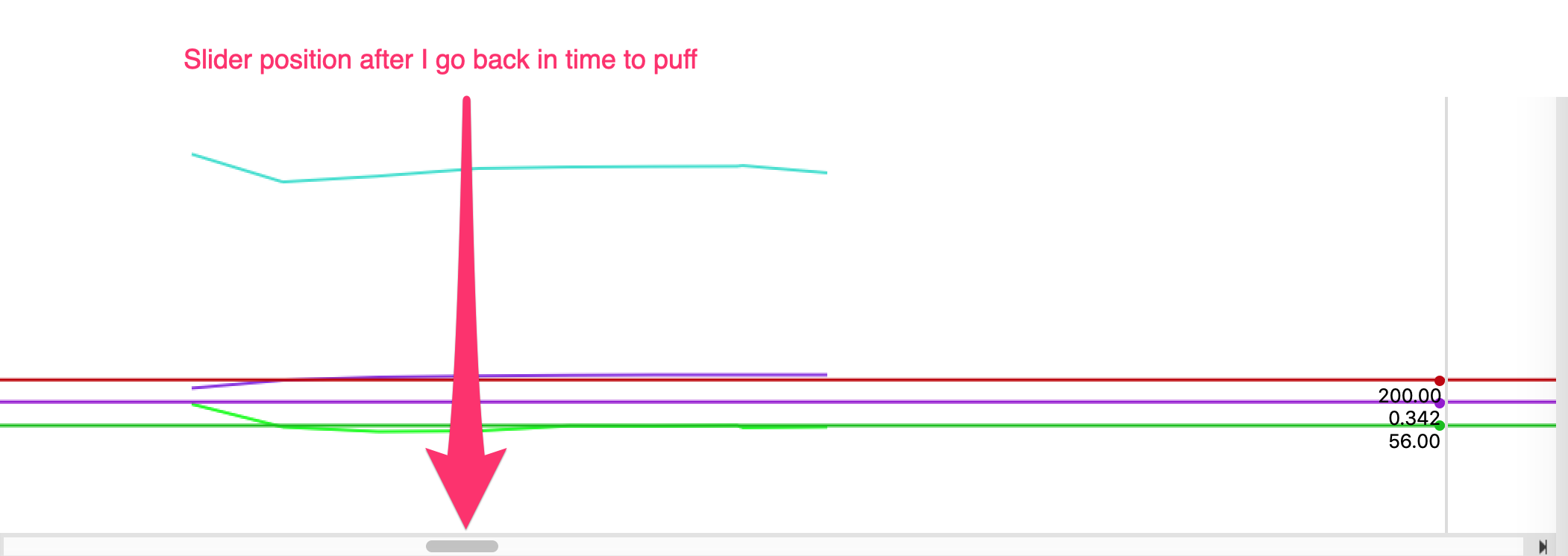

Wayneo Posted May 5, 2021 Report Share Posted May 5, 2021 10 hours ago, hittman said: I’m going to log out for tonight. I sure appreciate you trying to help. Sure. Later. The thing that surprises me is that your last printscreen showed no resistance rise at all. Let me prepare a .ecig file for you for tomorrow to load onto your mod. It'll contain the same 'default' file, SP 38 firmware, and theme. All defaults, Profile 8 set at 35 watts. Same default theme, etc. To load, you'll connect and start escribe, Up top "file - open' and then select the file I'll send. It'll load it on your mod. Then go to the 'replay' profile on your mod, and click the 'measure' word. Take a puff when you can. Edit: I gapped that your last printscreen didn't show the puff lines at all (during the puff). At the bottom of Device Monitor window there's a pause button and a slider if your puff goes off screen. Were you using the Default theme? Link to comment Share on other sites More sharing options...
Wayneo Posted May 5, 2021 Report Share Posted May 5, 2021 * I edited my last post, in case you had already read it Here's a bone stock evolv firmware with just a few changes. Default theme. 'Unlocks' set to 2 fire button presses Resistance set at .316Ω, 72°F like yours was yesterday. To load, you'll connect and start escribe, Up top "file - open' and then select the file I sent that you just saved. It'll load it on your mod. UNPLUG MOD. The 'replay' profile should be visible. Take a puff when you can. If you do NOT see 'save puff', leave the mod for 15 minutes or so, then all on your mod, go to 'settings' 'atomizer' scroll to 'measure', select button, click 'measure'. 'back', 'back', (should be on the main screen) take puff. I tested successfully on a Paranormal. Were you using a different theme other than the default? The default would not allow you to change the material type. hittman replay.ecig Link to comment Share on other sites More sharing options...
hittman Posted May 5, 2021 Author Report Share Posted May 5, 2021 11 hours ago, Wayneo said: Sure. Later. The thing that surprises me is that your last printscreen showed no resistance rise at all. Let me prepare a .ecig file for you for tomorrow to load onto your mod. It'll contain the same 'default' file, SP 38 firmware, and theme. All defaults, Profile 8 set at 35 watts. Same default theme, etc. To load, you'll connect and start escribe, Up top "file - open' and then select the file I'll send. It'll load it on your mod. Then go to the 'replay' profile on your mod, and click the 'measure' word. Take a puff when you can. Edit: I gapped that your last printscreen didn't show the puff lines at all (during the puff). At the bottom of Device Monitor window there's a pause button and a slider if your puff goes off screen. Were you using the Default theme? Yes, default theme. I didn't know about pause button. I was trying to hold the mod, fire, and press control and print screen at the same time. Link to comment Share on other sites More sharing options...

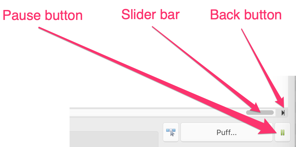

Wayneo Posted May 5, 2021 Report Share Posted May 5, 2021 2 hours ago, Wayneo said: To load, you'll connect and start escribe, Up top "file - open' and then select the file I sent that you just saved. Do an 'Upload settings to mod' It'll load it on your mod. Hittman, my bad. I've bolded and modified the above. 1 hour ago, hittman said: I didn't know about pause button 1 hour ago, hittman said: Well, I thought I was using the default theme. You mean the default wouldn't let me change material on the mod or in escribe On the mod you can't change the material from watts. WITH THE DEFAULT THEME MOVE THE SLIDER BAR. Better images shown Link to comment Share on other sites More sharing options...
