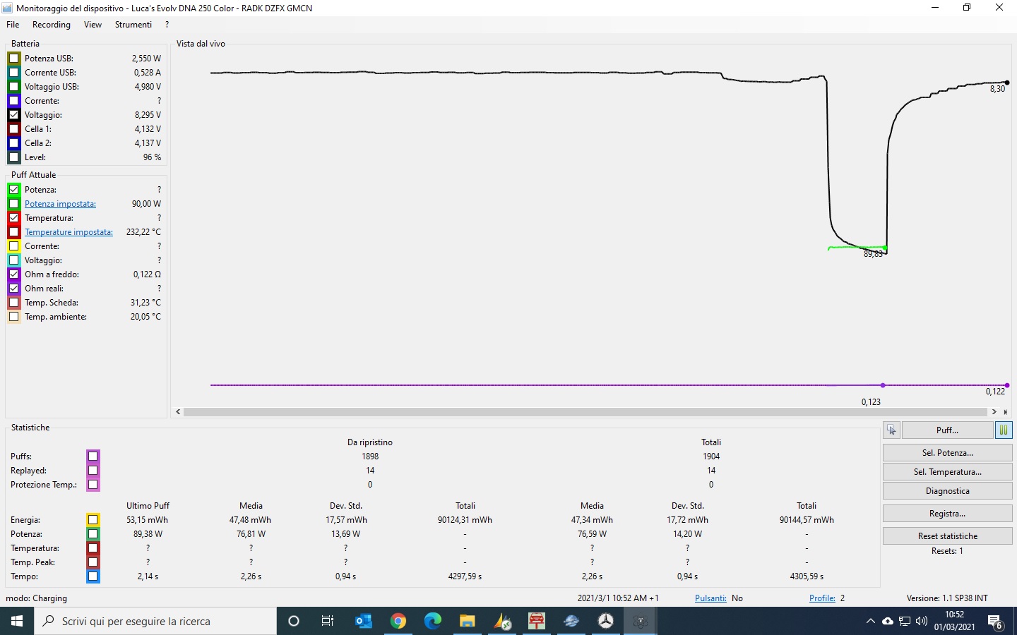

luca4bass01 Posted March 1, 2021 Report Posted March 1, 2021 Thanks for reply! i'm replying with a backup account, cannot login with my originakl account. By the way, i've tried with other three atty, all dual coil, two with the same coils as the goon 24 and the third one with ss316 flatwire but all three with 0,12 ohm resistance: temp control and replay still doesn't work. i attache the test screen. tried also with a wasp nano (single coil parallel 5 wraps 24 gauge ss316 0,15 ohm) and the replay/temp control WORKS! maybe the goon has too low resistance? for answer your previous question, yes i've tried in the replay menu, in escribe the replay option is selected the monitoring screen attached is made with the goon 24 thanks!
Wayneo Posted March 1, 2021 Report Posted March 1, 2021 I see what you're saying luca. It could be so many things, from dirty threading or clamps on the goon or 510 positive pin or the wire or coil. Or just that resistance You could try the goon with a single coil first, or dual at higher Ω's Failing that, with this being used before you, you could go under File -> Save, and keep a copy of this entire setup, then reset defaults which resets everything back to the Evolv defaults and start from a known place. I do not believe there were any meaningful changes with that mod when new from the LV. About having to create a second ID. Why couldn't you log in?
