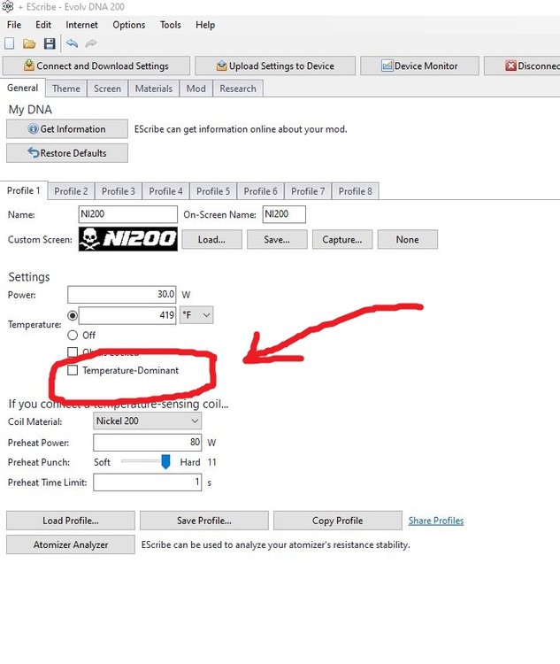

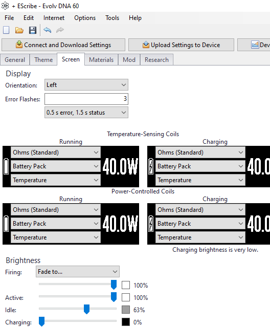

dwcraig1 Posted January 15, 2021 Report Posted January 15, 2021 Make your desired adjustments here and upload settings.
dwcraig1 Posted January 15, 2021 Report Posted January 15, 2021 Look here for resample coil resistance.
dabberbid Posted January 15, 2021 Author Report Posted January 15, 2021 Thank you for both of your responses dwcraig1! I see the ohm re-read now, thanks! For the dynamic temperature display when firing, exactly what do I need to change in the screen you provided above? I can't figure out what should be changed. Thanks again for your help!
dwcraig1 Posted January 15, 2021 Report Posted January 15, 2021 Do you have this box checked/unchecked? If so uncheck or check it depending with what you want and upload settings.
dabberbid Posted January 15, 2021 Author Report Posted January 15, 2021 Thanks. I'll try that later today. That will cause the mod to update the temperature while it's firing?
dwcraig1 Posted January 15, 2021 Report Posted January 15, 2021 this gets me this. With temperature dominant the large number will be temperature instead of watts.

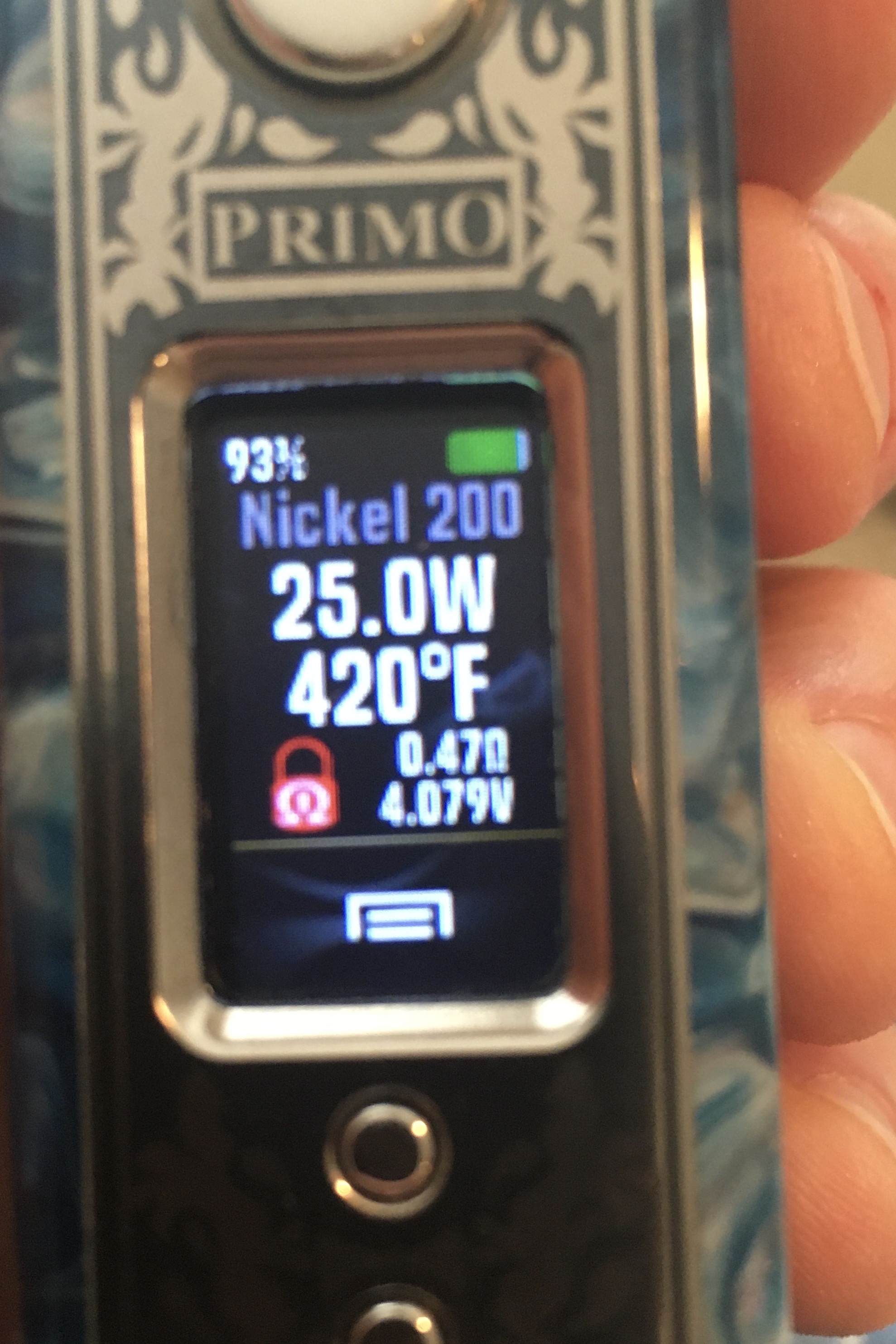

dabberbid Posted January 15, 2021 Author Report Posted January 15, 2021 Thanks. The size of the number isn't really the issue though. The issue is whether the temperature updates in real time when firing. Here's what the screen looks like now. The temperature remains fixed when firing. I'd like to set it up like my Mirage, which displays the actual temperature in real time during firing. Does unchecking "temperature-dominant" do that?

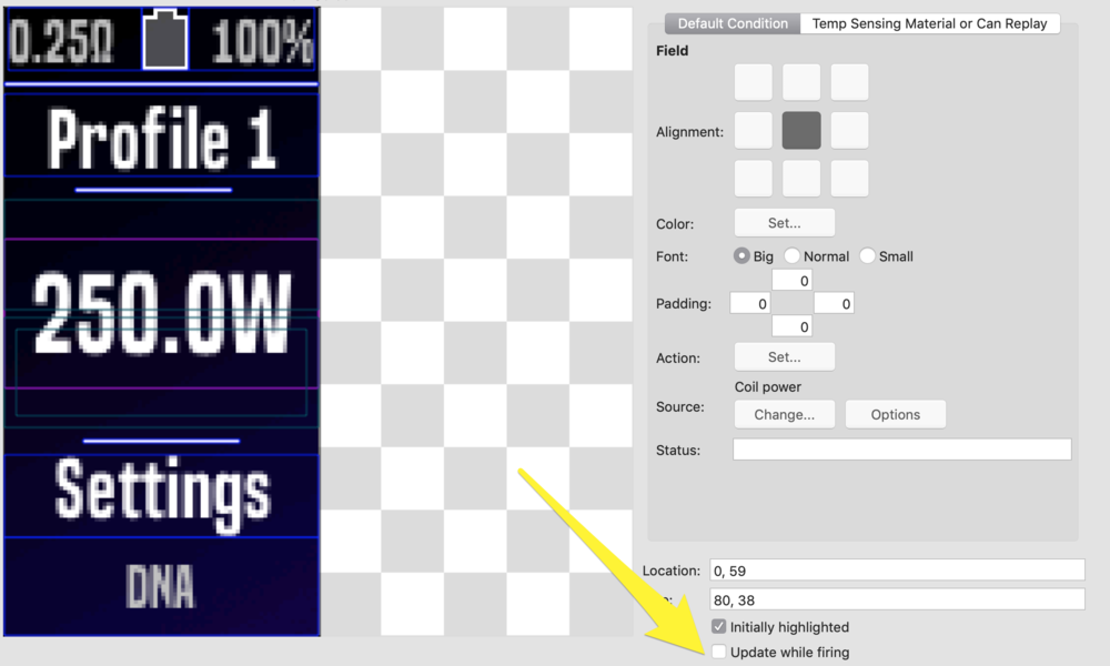

dwcraig1 Posted January 15, 2021 Report Posted January 15, 2021 i have mistakenly been giving you advice for a non color board, my apologies. Wayne sent me this just now.
dabberbid Posted January 15, 2021 Author Report Posted January 15, 2021 Won't that just update the watts?
dwcraig1 Posted January 15, 2021 Report Posted January 15, 2021 Honestly I don't know, I've been looking for that setting on my VA Spade in Theme Designer and can't find it. Perhaps Wayneo knows and will answer,
dabberbid Posted January 15, 2021 Author Report Posted January 15, 2021 Thanks, I appreciate it. Who's Wayne?
Wayneo Posted January 15, 2021 Report Posted January 15, 2021 @dabberbid Find the field you want to keep being updated in your theme, and make sure that option is enabled 2

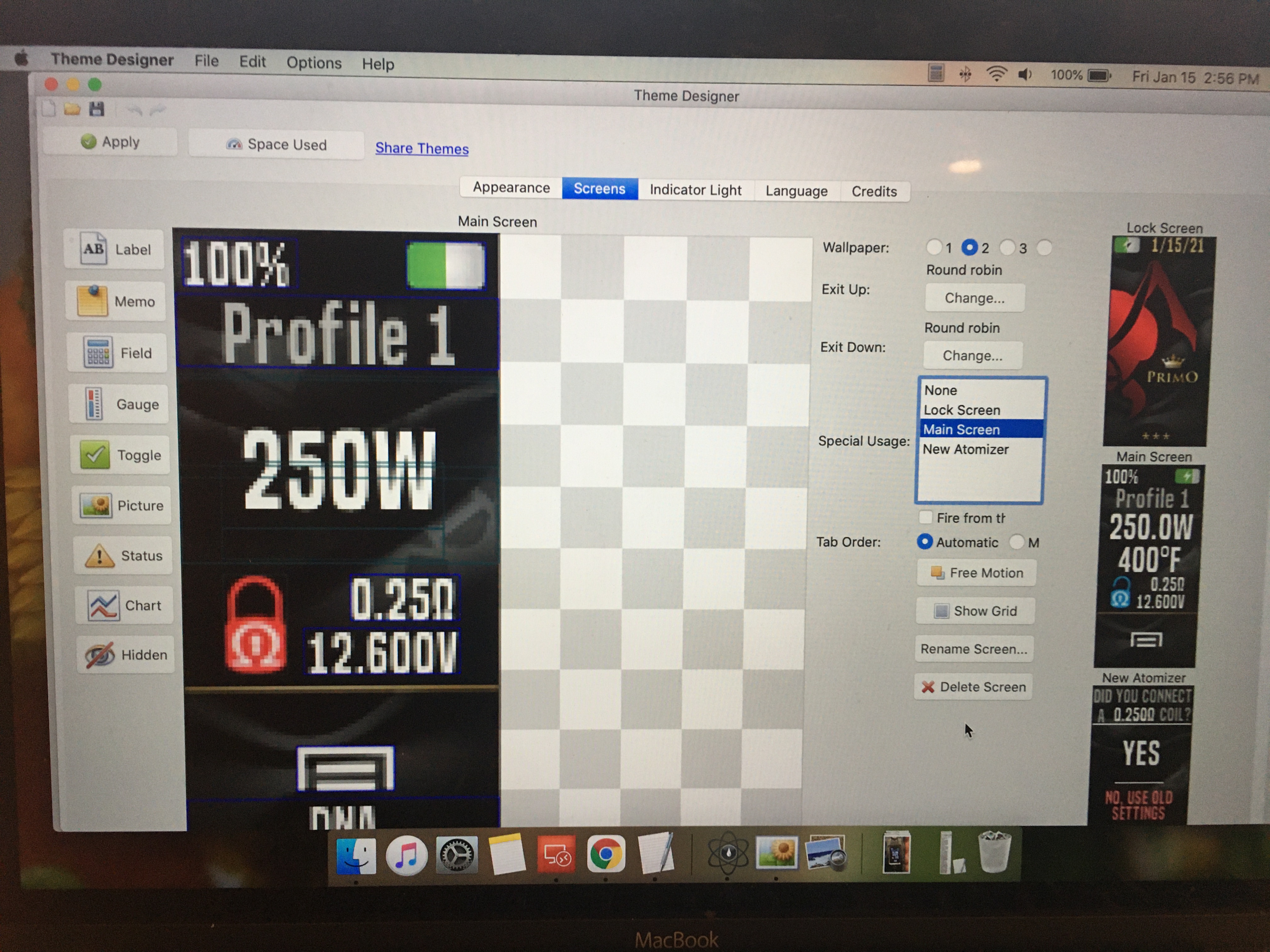

dabberbid Posted January 15, 2021 Author Report Posted January 15, 2021 Thanks, I think we're getting somewhere, but I'm still not getting it. If you look in my post above, you'll see a photo my my mod's screen with Nickel 200 temperature control. Note that both watts and temperature are displayed on the mod screen. Below is pic of my Escribe Theme Designer screen for the mod. There is only one small screen icon on the right of the photo below listed as "Main Screen" and it doesn't appear to have anything to do with Nickel 200. Further, although the small screen icon on the right of the photo shows both watts and temperature, like the actual mod screen does, the large *working* screen on the left shows only watts. I can't even click on any temperature to change any settings, because there's no temperature to click on. Can you "please* help? I'm not getting anywhere by myself, and I'm having trouble even understanding what Escribe and Theme Designer are showing me. Where is the screen for Nickel 200 temperature control? How do I get to it? Once I find it, what do I do to keep the temperature updated? THANKS!
Wayneo Posted January 15, 2021 Report Posted January 15, 2021 Theme creators can do whatever they want in their themes. On that Main Screen if you highlight that .47Ω field, you'll see what that represents, probably 'coil cold ohms' (measured). Because I see nothing else, you could add a new field (or change an existing field), with 'coil temp' and update while firing option. OR you could just copy over your Mirage theme to this mod. * Misc ... See all those squiggly horizontal lines through the 250 numerals in your pic? Those are all different fields, etc. depending on your profile or mode or conditions. That 'Nickel' is picked up from one of your Profiles (out of 8 in escribe 'general' tab as the material type, same as the watts, coil ohms, etc. 1
