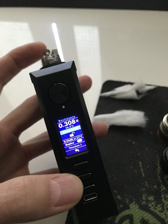

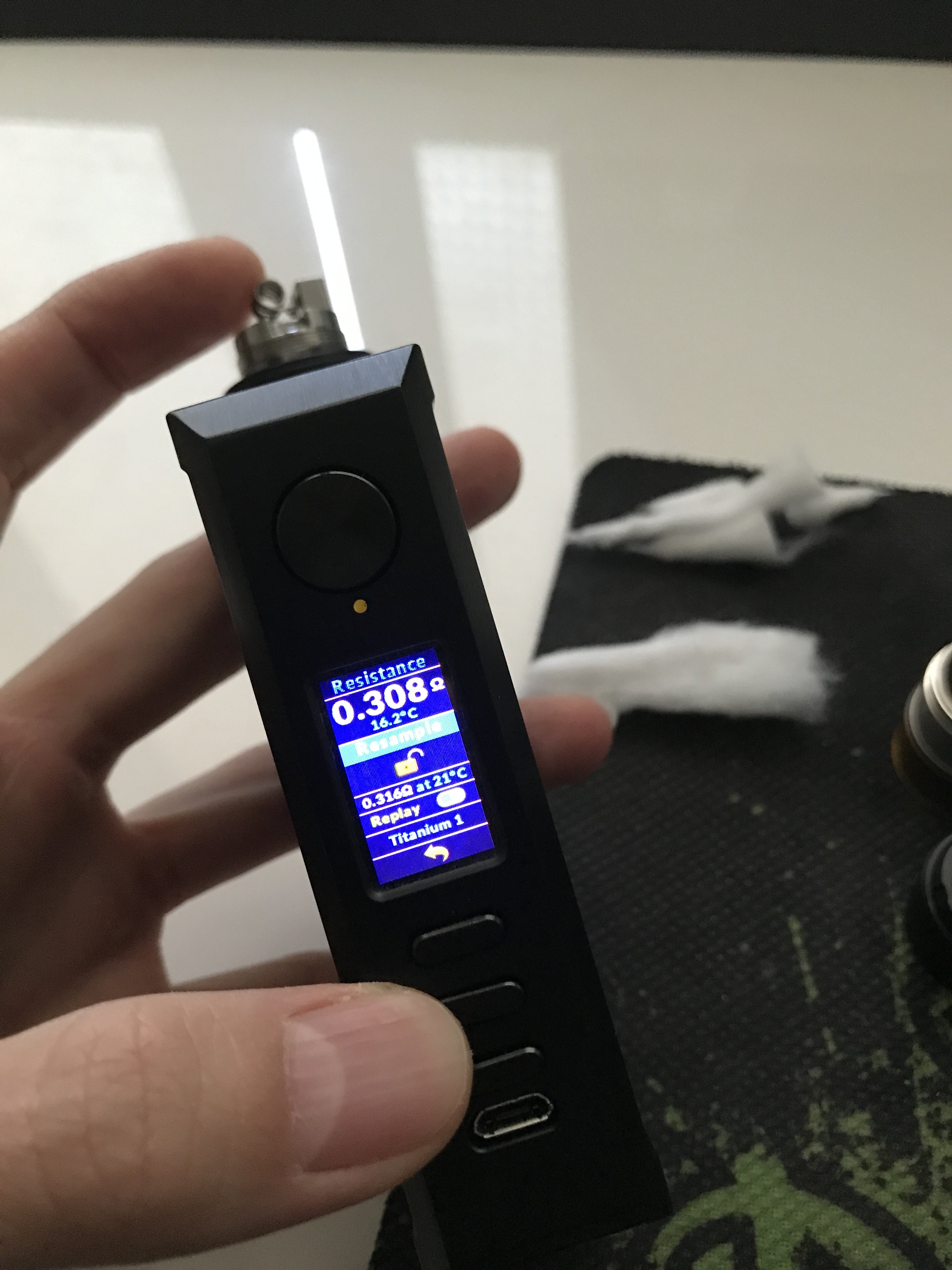

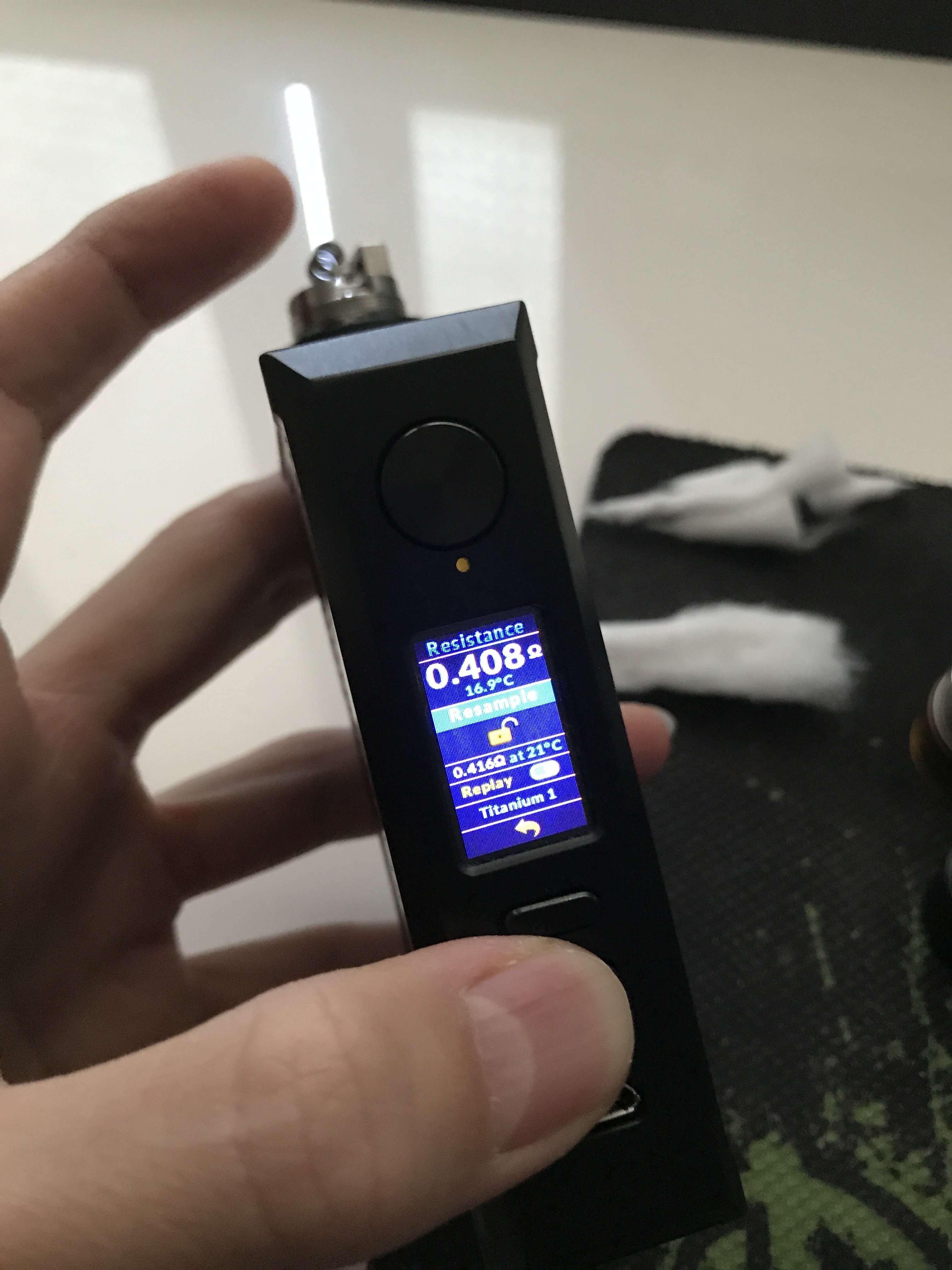

Djini Biba Posted October 27, 2020 Report Posted October 27, 2020 Dna 250c Titan 1 installed on the atamizer.the resistance of 0.333 on the bench press for a few ohms very often reaches about 0.415 and the wire is very hot.I do not click often it decreases back less and less !Is this how it should be?Maybe I need a profile for titanium 1 other.:For example, titanium ready esgo ?And what soprotivlenie it is necessary to establish that minimum ?And then it jumps as I described the problem from above!
Wayneo Posted October 28, 2020 Report Posted October 28, 2020 15 hours ago, Djini Biba said: installed on the atamizer.the resistance of 0.333 on the bench press for a few ohms very often reaches about 0.415 and the wire is very hot.I do not click often it decreases back less and less !Is this how it should be? I do not understand the bolded text, but it is normal for Titanium 1 to increase the resistance more than that while in use. That coil only raised in temperature to ~90°C which is still below the boiling point of water. And yes, it should decrease. 15 hours ago, Djini Biba said: Maybe I need a profile for titanium 1 There should already be a profile for Titanium 1 on your mod. You can use that. 15 hours ago, Djini Biba said: And what soprotivlenie it is necessary to establish that minimum ?And then it jumps as I described the problem from above! I do not understand this at all. It might be easier if you write in Russian, and I will use a translator.

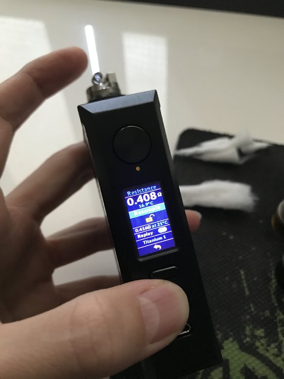

Djini Biba Posted October 28, 2020 Author Report Posted October 28, 2020 Теперь понятен мой вопрос про титан ,? что с ним происходит ,почему сверху он горяч ?(там где Коил )coil

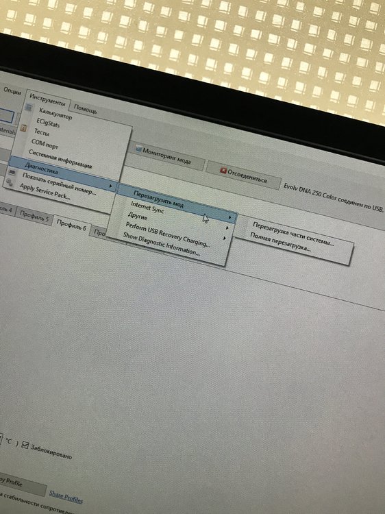

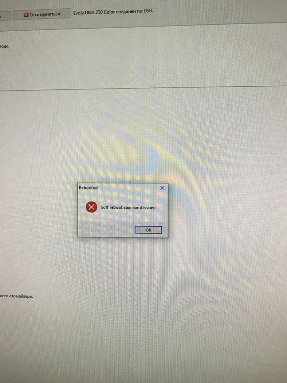

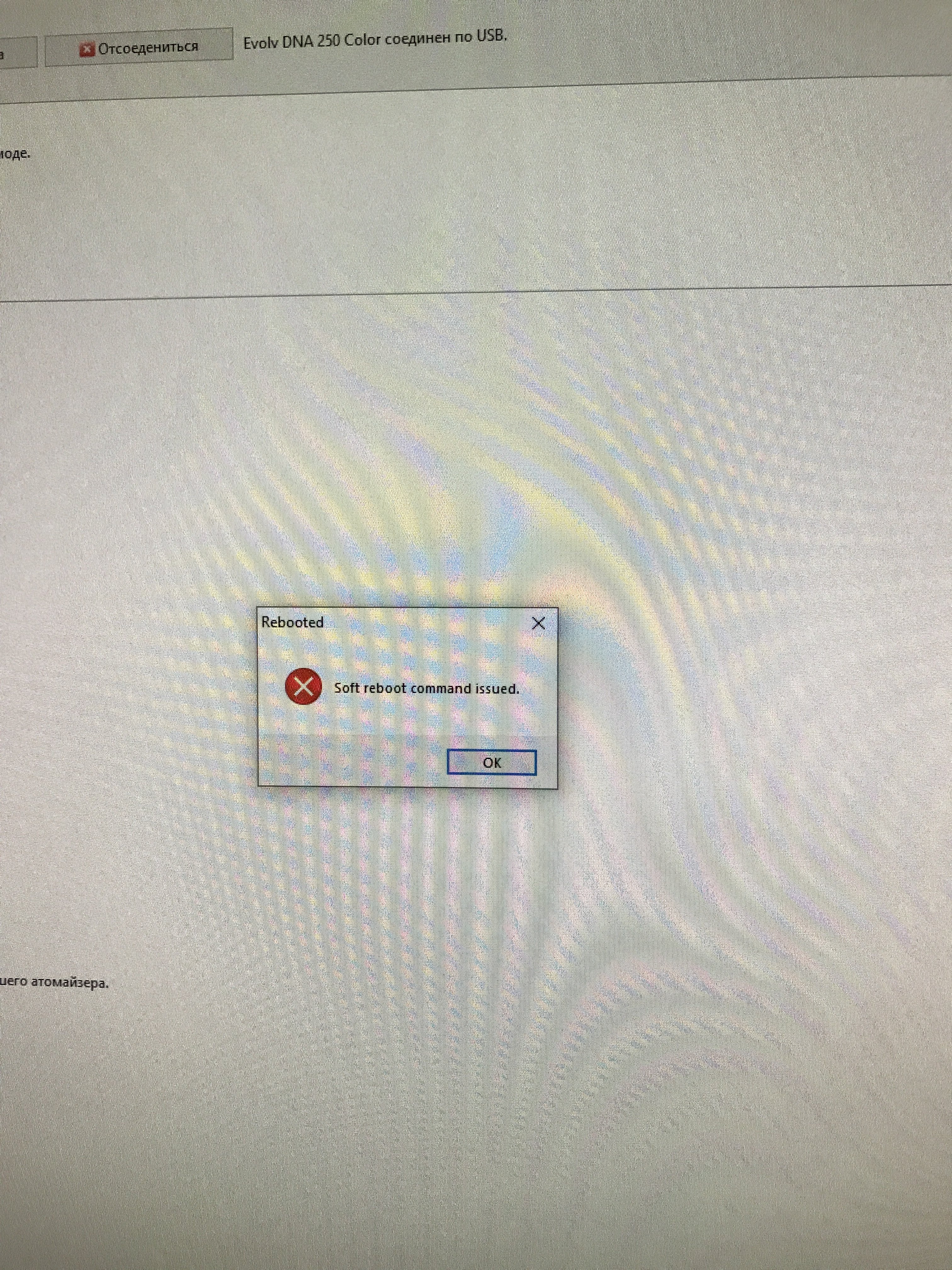

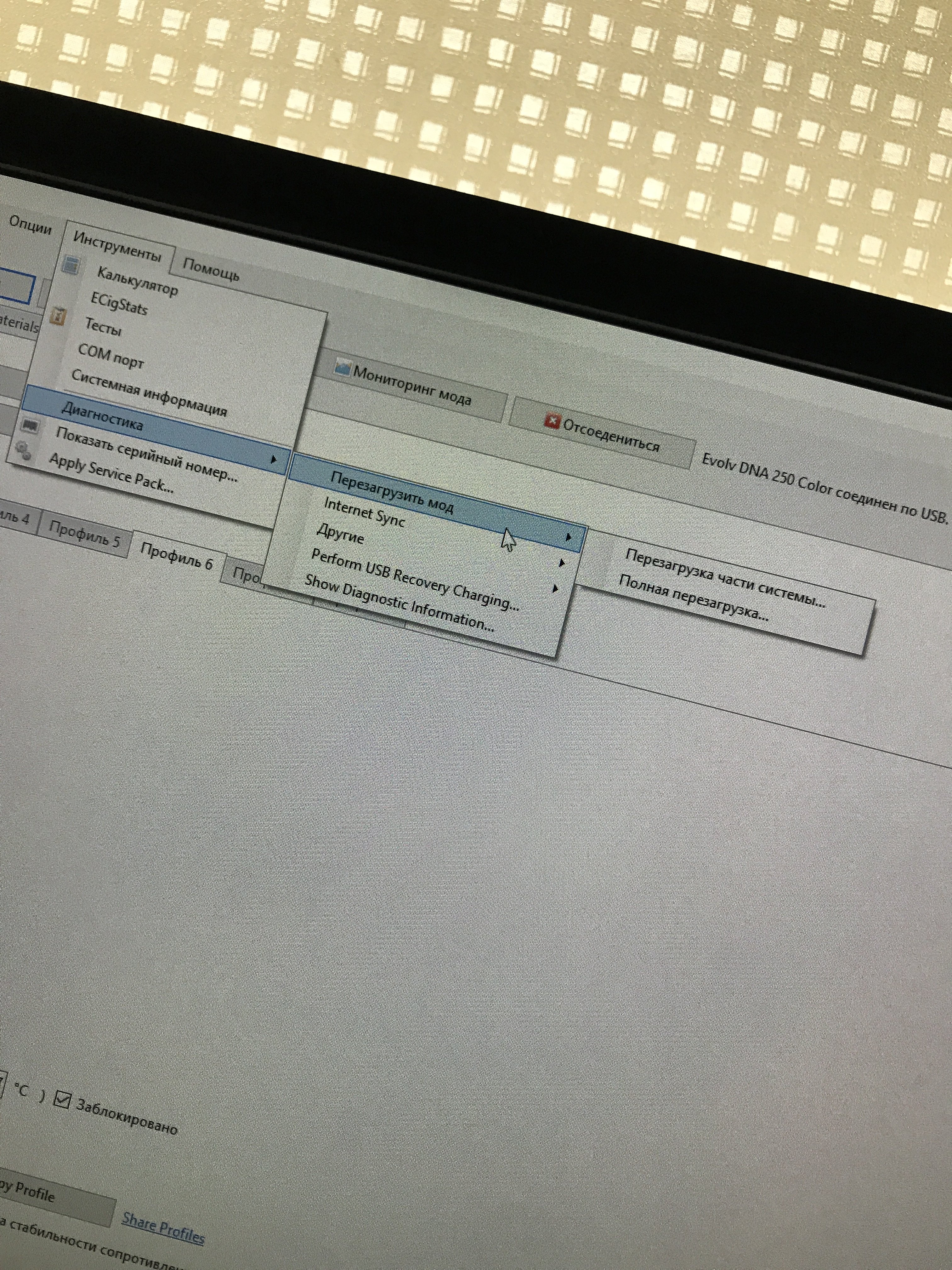

Djini Biba Posted October 28, 2020 Author Report Posted October 28, 2020 4 hours ago, Wayneo said: Я вообще этого не понимаю. Возможно, будет проще, если вы напишете по-русски, а я воспользуюсь переводчиком. Я стараюсь на английский ,чтоб лучше перевили .Возможно мы используем разный язык, твой может не английский, а я его перевожу на английский или другой переводчик .Ну в крайнем переводчик автоматом ставит другие слова ,не так как я указал или сайт ! у меня вопрос почему я через программу не могу перезагрузить мод частично или полностью?Выдаёт ошибку , что нельзя типо errors .
Wayneo Posted October 28, 2020 Report Posted October 28, 2020 Your video did not work. So I do not know anything new. If you are only clicking the center 'select' button to re-measure the ohms I do not think it is normal because that is done at very low watts. If you are using the 'fire' button, it could be normal. WHY ARE YOU CONTINUALLY CHECKING THE RESISTANCE? English is my only language. 🙂 35 minutes ago, Djini Biba said: у меня вопрос почему я через программу не могу перезагрузить мод частично или полностью?Выдаёт ошибку , что нельзя типо errors . English : I have a question why I can't reload the mod partially or completely through the program? It gives an error that it is impossible to type errors What are you trying to reload, and why? And what error?
Djini Biba Posted October 29, 2020 Author Report Posted October 29, 2020 По середине нажимаю .постоянно ,’ Доходит до 0,400 и Коил горяч потом опускается ,и перестаёт греть ниже и ниже. Красная ошибка ,не хочет его dna 250c перезагружать или полностью включить и выключить через эскрайб.
Wayneo Posted October 29, 2020 Report Posted October 29, 2020 Is that your only mod? STOP pressing that button constantly. You only need to check the resistance of your build once, with your mod and atomizer both at ambient (room) temperature. That big red X picture shows you issued a reboot command that worked. Look at the top line, it shows rebooted.WHY did you do that?
Djini Biba Posted October 29, 2020 Author Report Posted October 29, 2020 Да . титан не должен прыгать сопротивление поэтому я спросил что это за дичка дич я нажимал на эти перезагрузки и ничего не увидел (мод как стоял включённый и все)Потом ошибка я так делал много раз ошибка это действий то нету . если надо после этого нажимать загрузить настройки в мод «»»другой вопрос почему потому-то перезагрузить ,может термо контроль лучше стал бы работать наверно
Wayneo Posted October 29, 2020 Report Posted October 29, 2020 1 hour ago, Djini Biba said: поэтому я спросил что это за дичка дич You have made MANY WRONG assumptions and choices. Titanium resistance DOES AND SHOULD increase when power is applied. 28 watts for those high mass SS claptons were a poor choice in your very first post You still need a basic understanding of what you are doing. Temperature control is an advanced topic and you should learn to vape in straight watts with a simple single wire first. Kanthal or Nichrome or Stainless steel. Then move on to Replay with your Stainless steel. Straight watts - Use your single coil atomiser. just increase or decrease watts until you get a good flavorful vape. One of your profiles should be called watts or kanthal or power. If you look at that profile in escribe the material should not say stainless steel or Titanium anywhere. No replay. Nothing. The basic concepts how these mods work have never changed. You might find an old Russian video. Good luck.

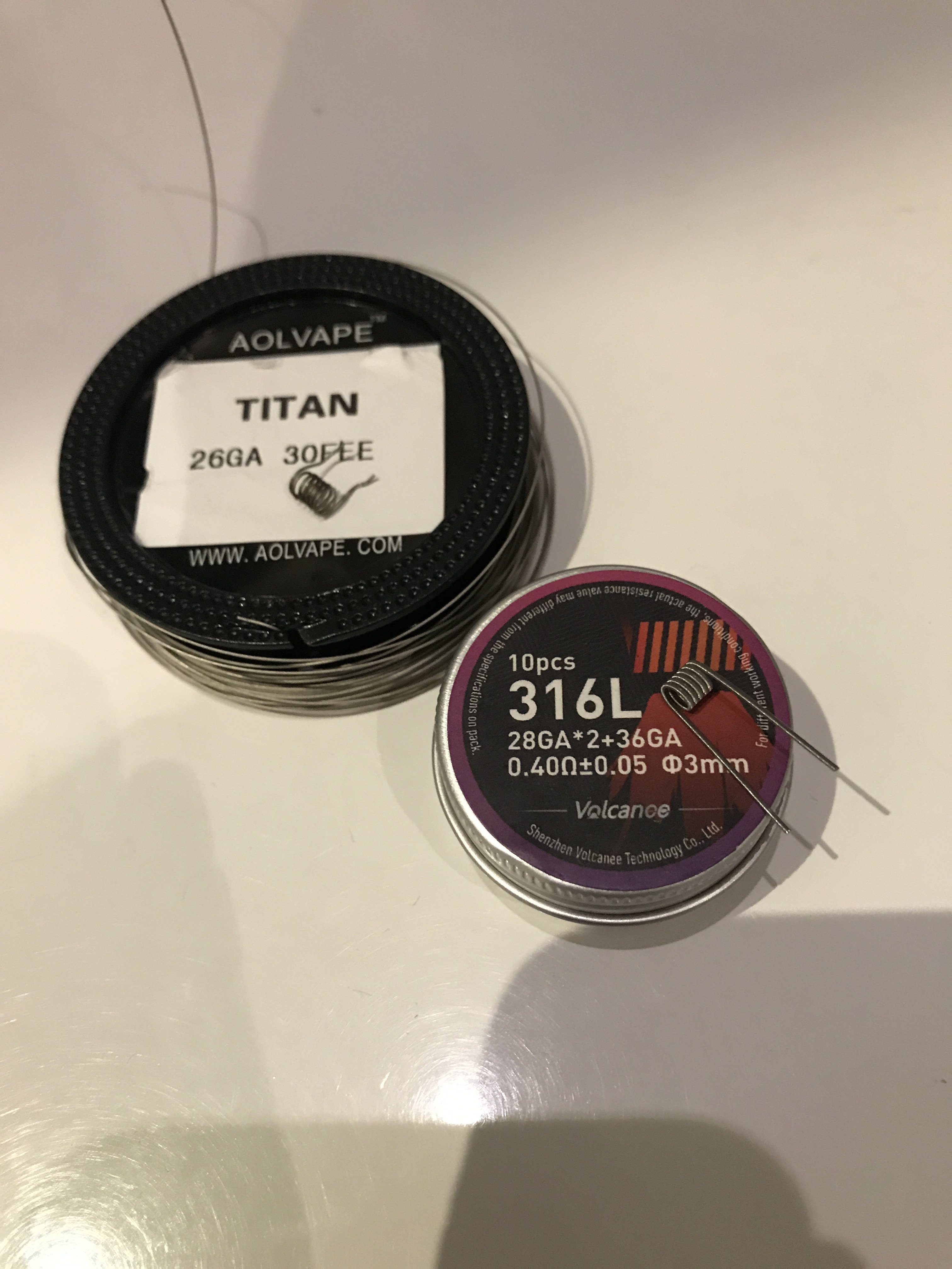

Djini Biba Posted October 29, 2020 Author Report Posted October 29, 2020 (edited) Щас нержавейки курил вы ещё сказали ,что вата сгорела ,ты был прав ,Горький вкус а вот на титане 1 не очень вкуса вообще нет странно очень слишком , никель надо прикупить и попробовать их смешать Edited October 29, 2020 by Djini Biba
Wayneo Posted October 29, 2020 Report Posted October 29, 2020 Hey, I NEVER said this, but I do agree with it. 3 hours ago, Djini Biba said: You say in August, The lack of resistance should be more. And I NEVER said this 1 hour ago, Djini Biba said: you also said that the cotton wool burned out, you were right, Bitter taste That photo of Stainless Steel is not a simple single wire, and it will require more watts than one strand of 26 gauge Stainless. Straight watts. Single coil. 24 or 26 awg wire (material). 1 hour ago, Djini Biba said: but on titanium 1, there is not very taste at all, it is very strange, very much, you need to buy nickel and try to mix them ⬆ DO NOT DO THIS! ⬆ Straight watts. Single coil. 24 or 26 awg wire (material).
